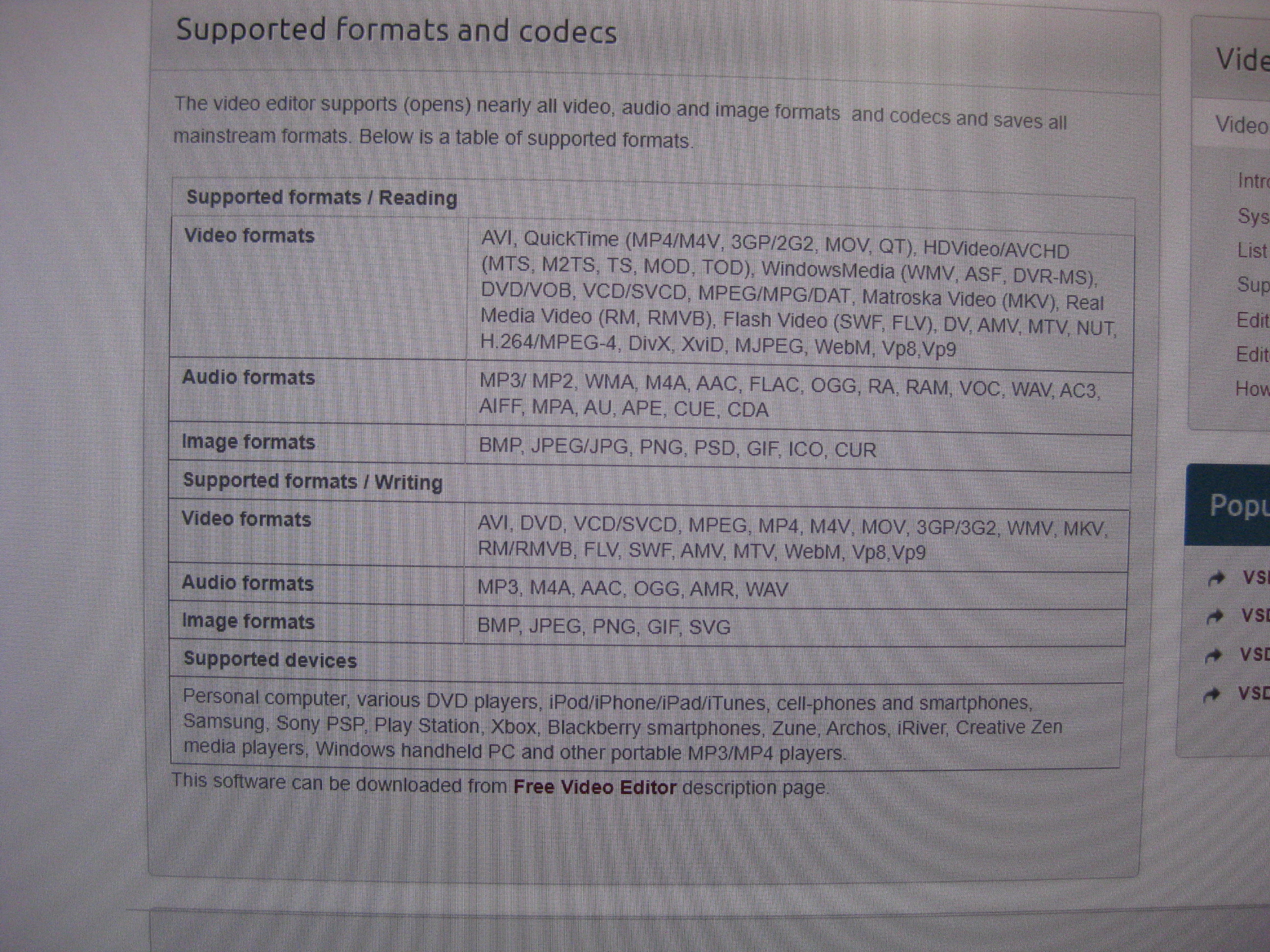

    Thanks for the reply--So I need to convert my project (in VSDC video editing software) to a mpeg-2 is that correct? I have attached a "supported formats & codecs" sheet for VSDC software, but I don't see mpeg-2 on the list. There is a MPEG that is listed-is that the same as a mpeg-2?

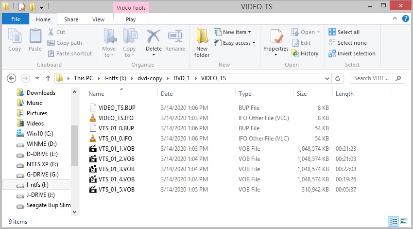

    Do commercial DVD's work in the Xbox? Make sure you didn't create an NTSC DVD Vs. PAL, or vice-versa
    I didn't realize VSDC included the authoring stage (Creates Video-TS folder with the VOB, IFO & BUP files inside)
    For example

    And yes the pix that you attached is what I ended up with when I used the preset for "DVD" in VSDC software. And that project worked ok in my DVD player but not in the Xbox.
