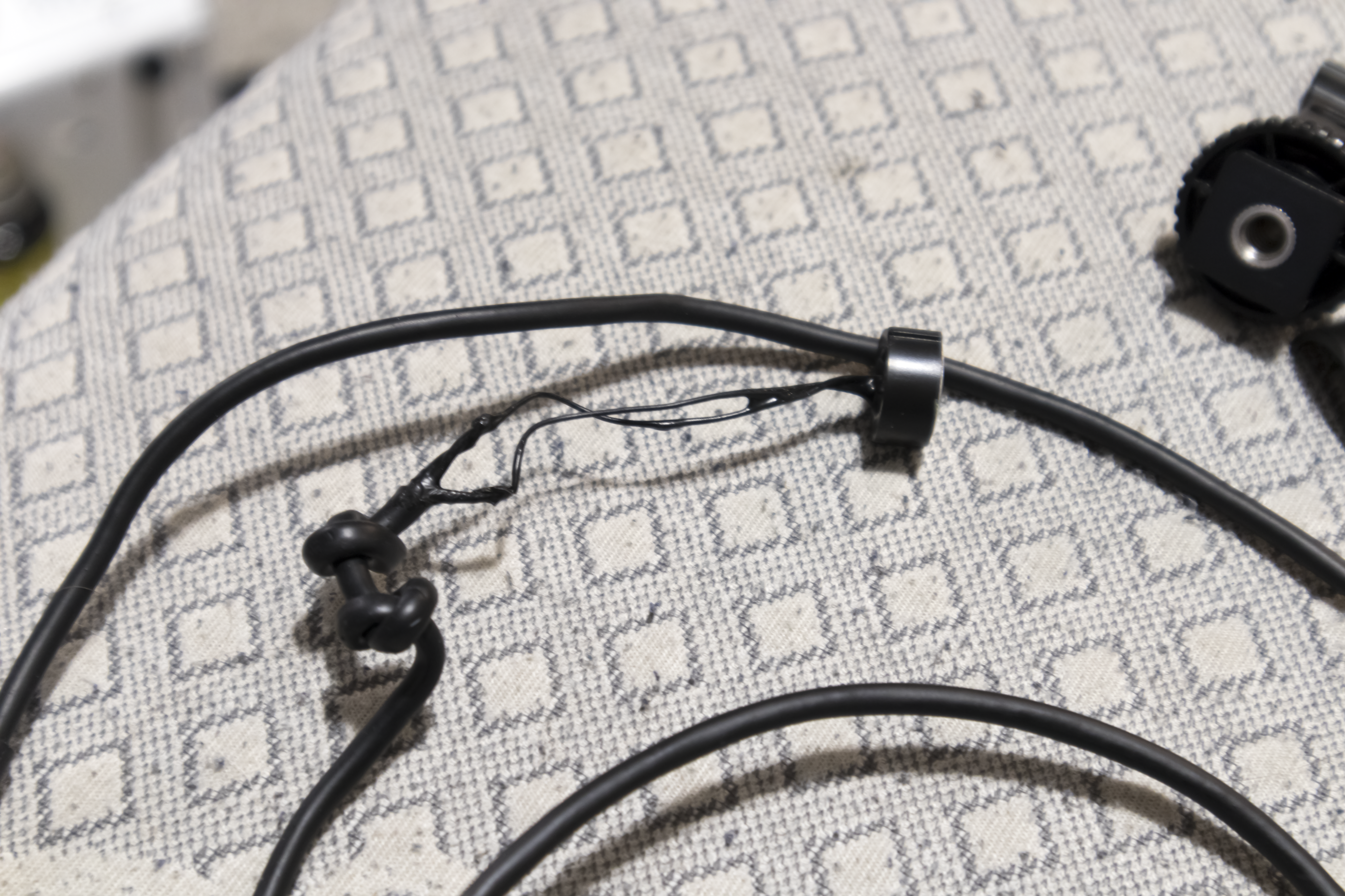

  4. Member bakonfreek's Avatar
    Aug 2012
    A Corn Field In Iowa
    [Attachment 52247 - Click to enlarge]
    Here's a photo of how it is inside of the shell. I put a bunch of PlastiDip over the exposed wiring where I did my bit (attached a TRS cable in place of the TRRS cable that came with the mic), but the wires coming from the mic were on it when I bought the module and it was potted lazily with some compound which looks like PlastiDip but is softer.
  5. Member Cornucopia's Avatar
    With that amount of (electromagnetically) exposed cable, and no shielding in sight, I am not at all surprised that it is getting EMI/RFI. Adding a shielding wrap may help, but since it isn't integrated into the construction, it won't be bulletproof.
    Have a few hunches about the Plug-in-Power also (polarity bias?), but no real way to gauge & test now that system has been modified.
