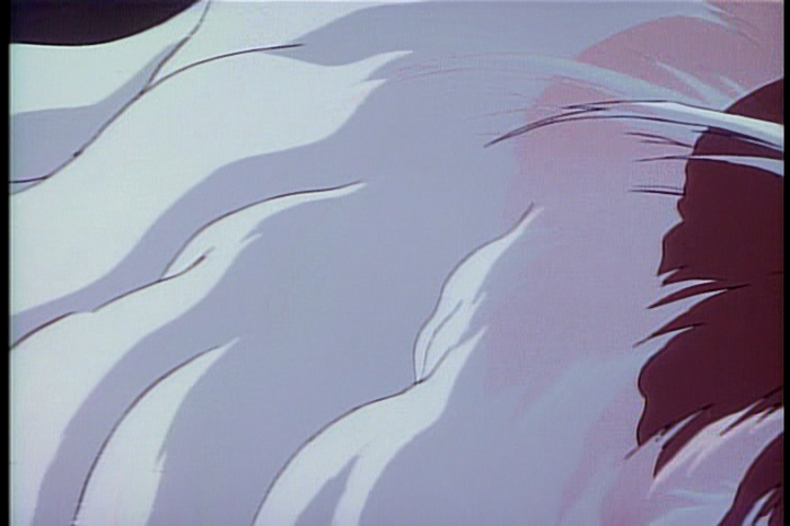

    this is an example of how small the blending has become working with vob and srestore:
    [Attachment 52224 - Click to enlarge]
    I didn't take any screenshots of it using the previous method, but let's just say it wasn't really much better after filtering than before. thank you so much for your quick reply and insights. this was starting to drive me crazy. i apologize for not taking more time to learn about proper methods for working with dvd's before posting. i just assumed it would all be the same. i'm going to spend some time learning about more about dgindex and proper methods for working with dvds.

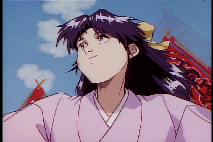

  4. hmm after working for about 6 hours, there just seems to be a few things that aren't able to be fixed (at least with my limited knowledge).
    [Attachment 52227 - Click to enlarge]
    maybe just a temporal denoise to help what it can and call it a day? honestly, the small amount of blending that remains isn't noticeable at all when viewed in real-time. i guess it just kind of bugs me because i know it's there, even if i can't see it but at least it's 100x better now. thank you again manono!
