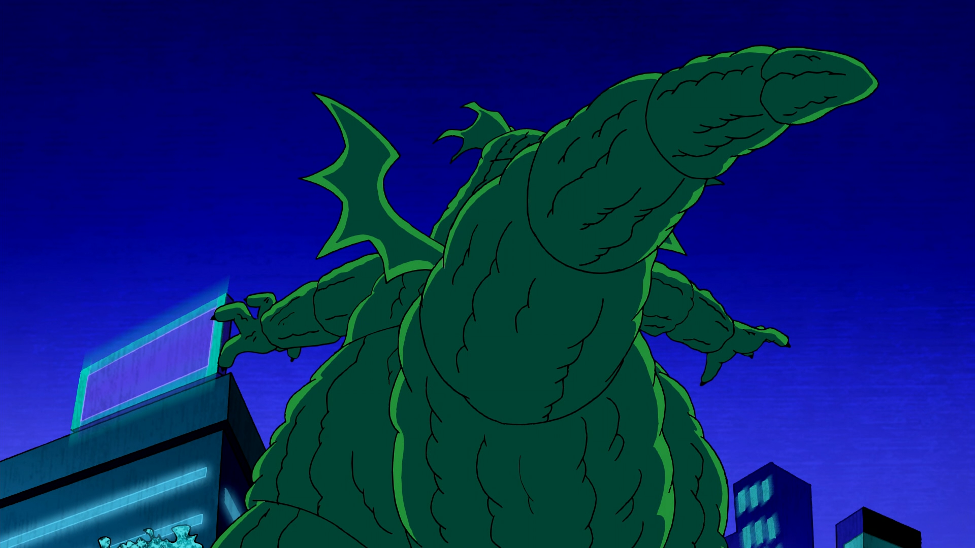

A source I am wanting to clean up has very weird artifacts on them. I am guessing its something to do with the Blu-Rays compression they used, I'm not 100% sure.
They resemble lines or cube shapes all over the place and sometimes move around rapidly. Very noticeable on greens.
Here is a screenshot. It can be kind of hard to see on a still image, but if you look, you will see darker lines in the colors.
https://forum.videohelp.com/images/imgfiles/pGxmSHW.png
Here is a unfiltered video sample. You can see what I am talking about much better using the video. If you pause, then play, then pause, then play and look for them, you cant miss them. Once you can see them, you cant unsee them.
https://mega.nz/#!g5p3RZ4Y!rac2OtA-GFeJAjhS5knXQ-zpqrCXt7khYy3z7ES2uiU
Is there anything I can do to remove or cover these up? I have tried really strong DNR and it has no real effect on them.

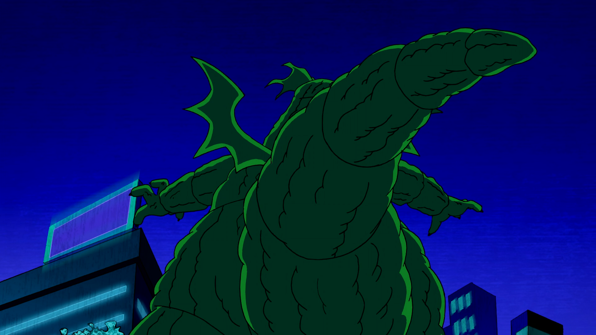

I darkened the screenshot a lot and now they are very visible if you couldnt see them in the above screenshot.

TNLMeans(ax=2, ay=2, az=1) will get rid of most of it without damaging the rest of the picture too much. KNLMeansCL() would be much faster but it doesn't run on my old computer.
