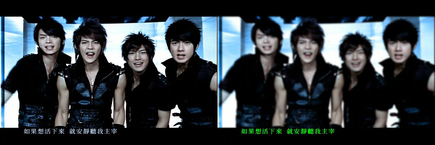

  11. Crop the text to it's own stream which you filter differently, then overlay it back on to the fully processed video:
    Mpeg2Source("superb.d2v")
    original = last
    text = Crop(0,424,720,28).ConvertToRGB().RGBAdjust(r=0.0, g=1.3, b=0.0).ConvertToYV12()
    blur = BinomialBlur(5.0) # blur main video
    Overlay(blur, text, x=0, y=424) # overlay sharp green text
    StackHorizontal(original, last)
    Here I've blurred the main picture but kept the text sharp and turned it green.
    Original on left, processed on right:
    [Attachment 52195 - Click to enlarge]
    original = last
    thanks! I processd the subs successfully!

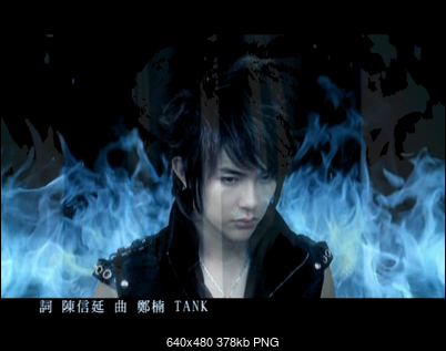

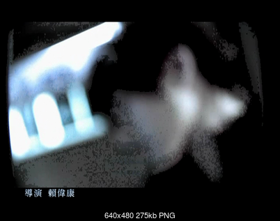

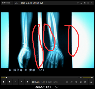

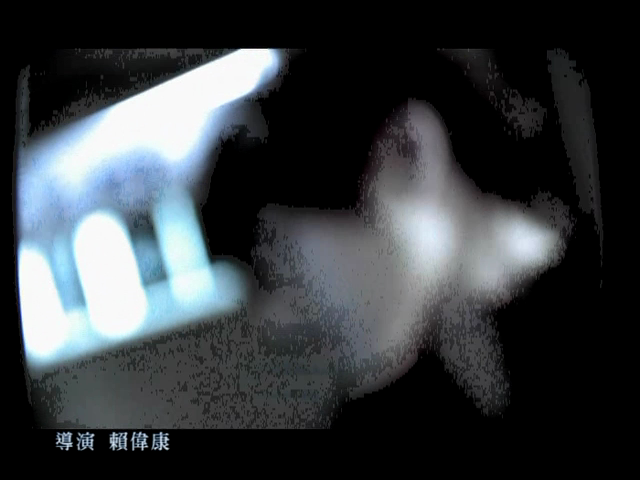

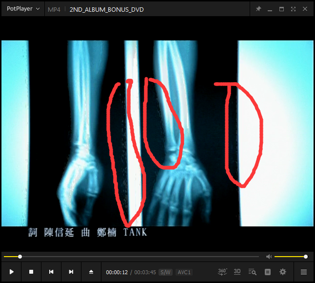

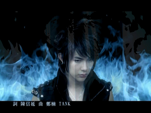

    I get a similar result as what I want with the code "TDeint(mode=2,type=5)",but something bad appeared.
    I changed the code "TDeint(mode=2,type=3)",the bad things disappeared.
    What are their names?What cause this?
    How can I remove them when I insist on the code "TDeint(mode=2,type=5)"?
