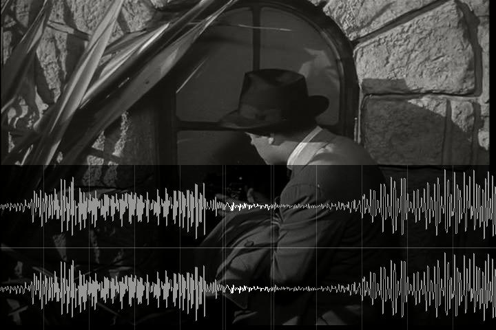

In AviSynth you can use an audio waveform display filter to visualize the audio. Then stack two videos vertically to figure out the alignment. Waveform(width=5, height=120) of one video:
[Attachment 52162 - Click to enlarge]
Here the audio of the current frame is in the center and 5 frames on either side are displayed.
