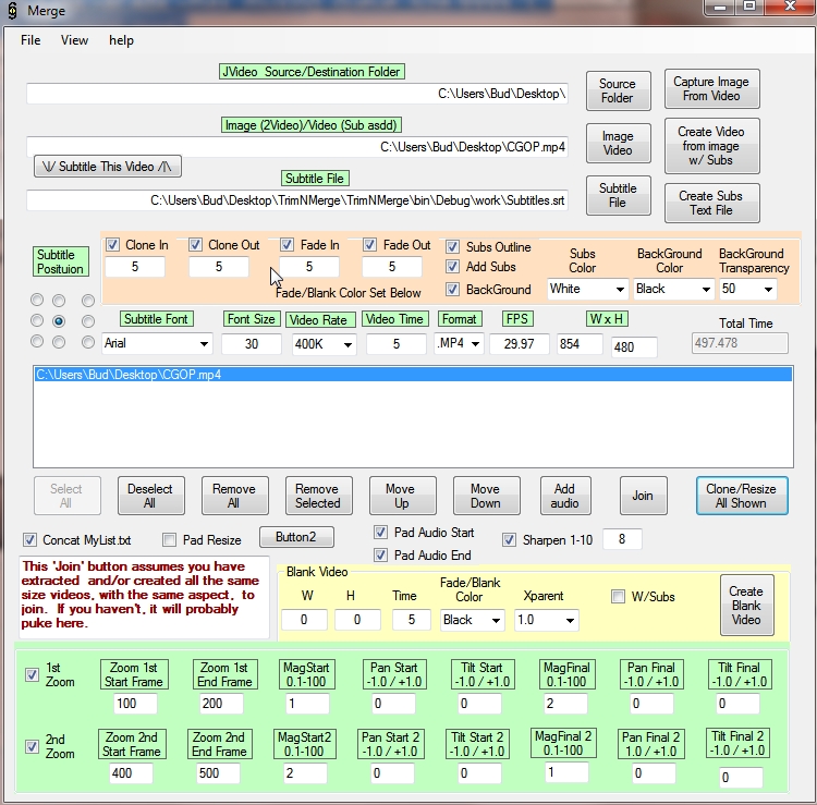

    Recently I had a need for a special avisynth script to cut and merge movies, cloning the start and end frames, add subtitles to these cloned areas and fade them in and out. In addition to this, I needed to zoom in certain areas of various segments in addition to the cloning,subbing,fading. Took a while but finally got it working and thought maybe someone else could use it by modifying what you need:
    ULTIMATE AVISYNTH SCRIPT
    Converts Video with Zoom In (start magnification 100%), Pan In (none), Scan In (none), Zoom out (magnification 200%), Pan out (none), Scan out (none), Clone first frame for 5 seconds, Fade in (from frame 100 thru 200) these cloned 5 seconds, Cloned last frame for 5 seconds, fade out (from frame 400-500) these 5 seconds, add subtitles, Outline subs, use sub background (2 lines of different length will have the same length background), background 50% transparency, set video size, FPS, CRF, bit rate,font size, font type, font position (9 choices)

    This script was created and verified by and can be compared to the corresponding fields presented in a graphic form.:
    [Attachment 52155 - Click to enlarge]

    My goal with this post was not to provide a 'Cut and Paste' solution but rather a 'sequence' of events that cover most of what you or others might want to provide a smooth transition between segments of that basketball game or trip to Florida with out the sudden change with no explanation of what is what. It also pads the audio so sync is maintained as well as allowing to add subtitles on the cloned, fade In/Out areas.
    FFMpeg and Avisynth, as you well know, are sequence sensitive in the order of functions. Different sequence cause different output or outright failure. I thought this post might provide a template for changing as needed. Things like Color, times, subtitles, background color, subtitle color, and even the name of my video will most certainly need to be alter or omitted.
    I'm sure that, since anyone who knows that RGB and Directshowsource are not ideal, also would be able to change for their needs or PM me and I would most certainly attempt to help. After all that is why in my initial post I mention:
    ...could use it by modifying what you need
