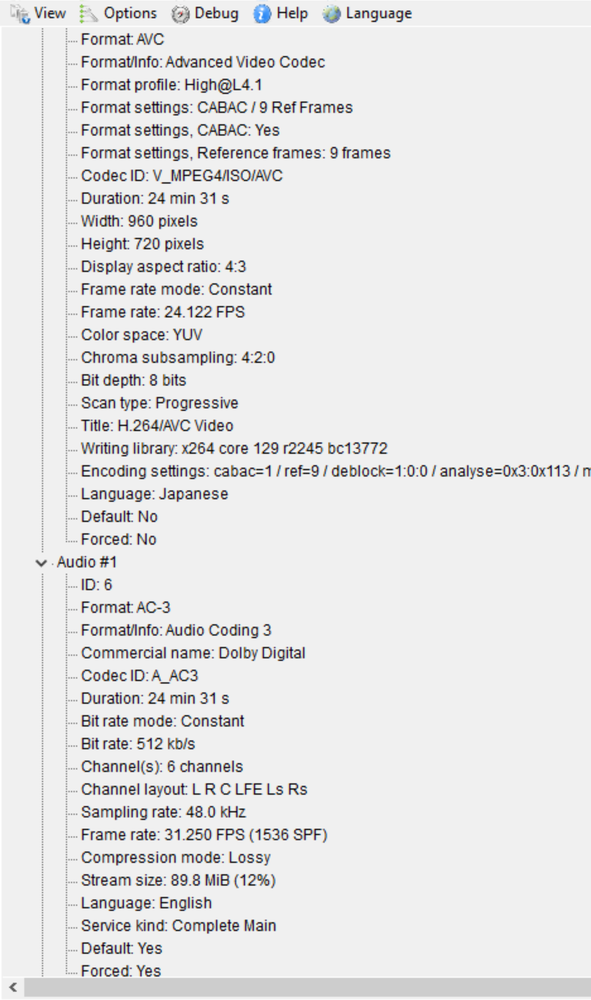

    Please try to report an extended MediaInfo analysis, the MKV might have a variable frame rate or a time stretched/compressed audio track...

    LigH.de, I'll upload a MediaInfo tree view below
    [Attachment 52152 - Click to enlarge]
