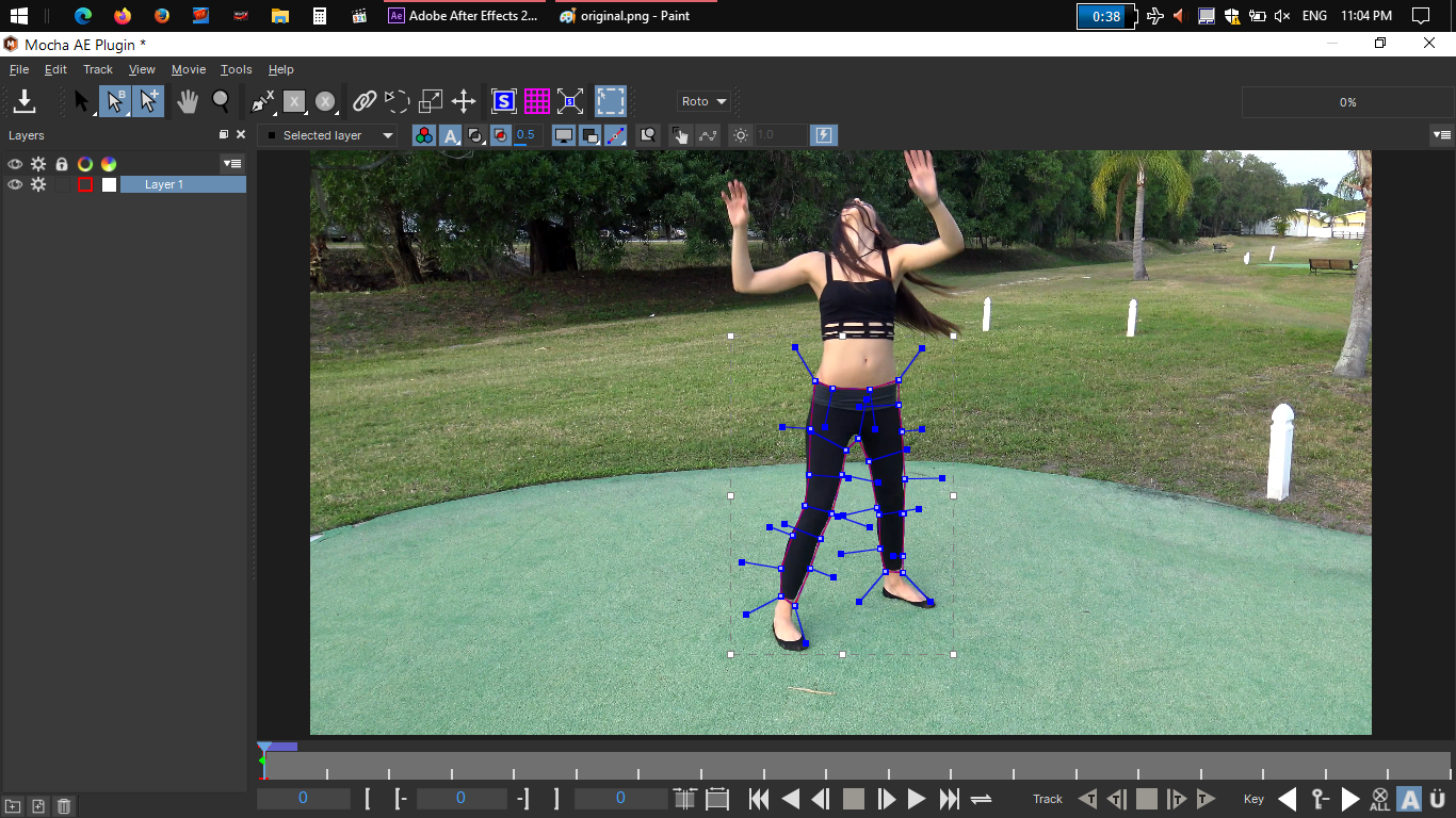

Let's use Mocha in After Effects (It can be used in Hitfilm, standalone, etc).
There's other ways to do the auto rotoscope tracking as well.

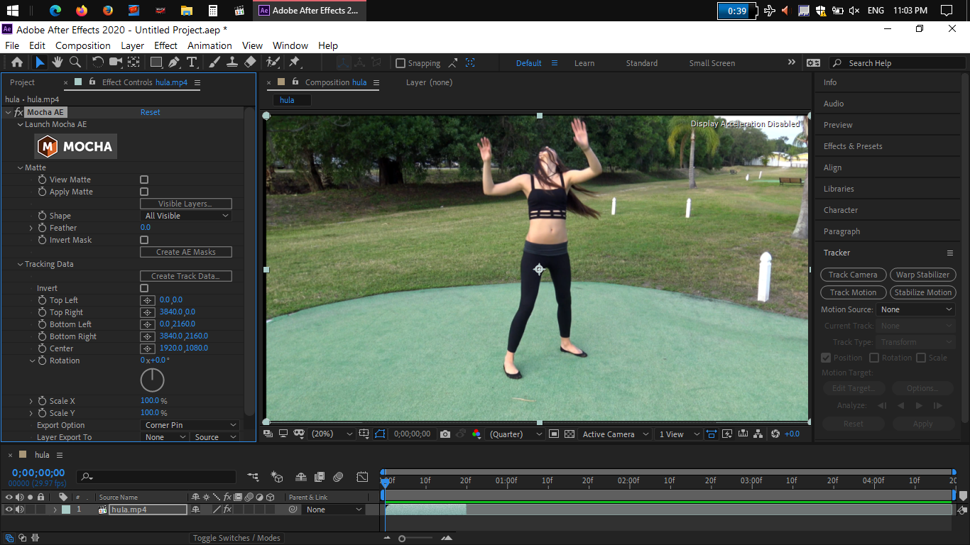

1.
[Attachment 52131 - Click to enlarge]
let's rotoscope the legs out. (Watching The Rookie - no time to focus on the specifics of the hair/hands in the upper body).
Drop the original footage into the timeline, Animation -> Mocha to add the Mocha effect to the video.
Double-click the Mocha icon on the left to open up Mocha.
2.
[Attachment 52132 - Click to enlarge]
Click the Pen x tool in the toolbar, draw around the legs.
Once that's done, simply click the T > Track Forward button in the bottom toolbar.
Adjust the track for each frame to closely follow the legs (this is always the part that takes a bit of time).
Close the Mocha window, select SAVE.

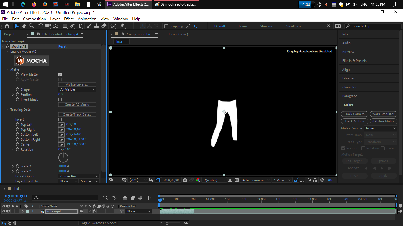

3.
[Attachment 52133 - Click to enlarge]
Back in After Effects, you can click the VIEW MATTE option to see if you've got a good matte from Mocha. yes.
Turn off the VIEW Matte option.

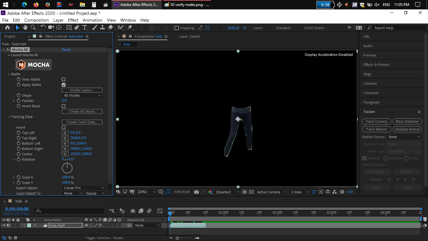

4.
[Attachment 52134 - Click to enlarge]
Turn on the Apply Matte option.
POOF!!!!
THE ENTIRE BACKGROUND IS ERASED! Bye Bye Annoying background person/etc.

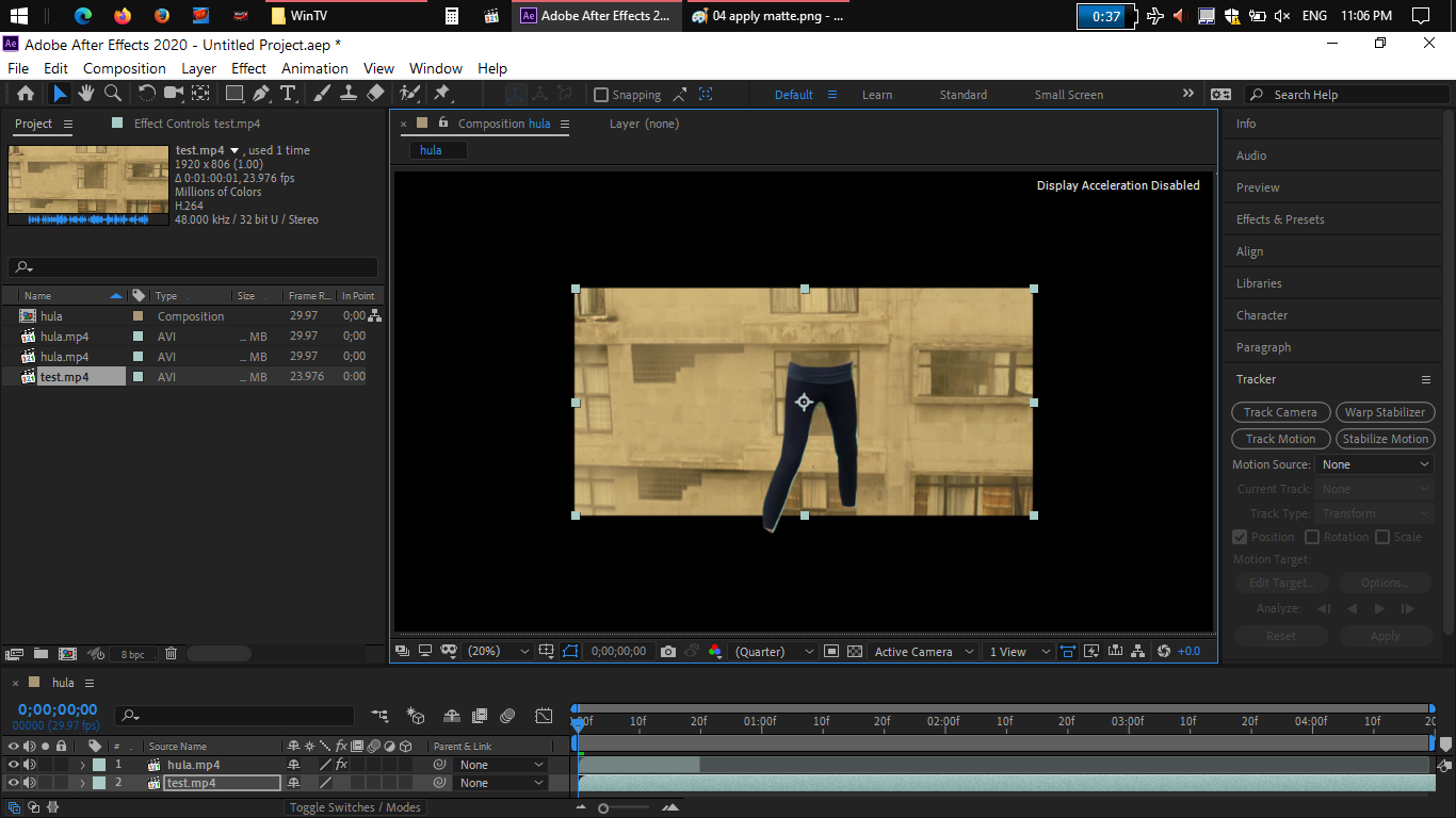

5.
[Attachment 52135 - Click to enlarge]
Import any other video or photo for use as the background.
Place it in the timeline lower/behind the legs and resize to fit
See before and after examples - a dozen minutes without even trying to matte carefully while watching TV.
Seriously, you CAN DO IT!
The only thing that'll take the most amount of time is making sure the matte is tight around the hands, hair and head, but nothing too hard - just move the points of the matte.
Many other ways to create the matte, too - see youtube for your program of choice.
eg soft matte around hair. https://www.youtube.com/watch?v=oJt55bR16yk -

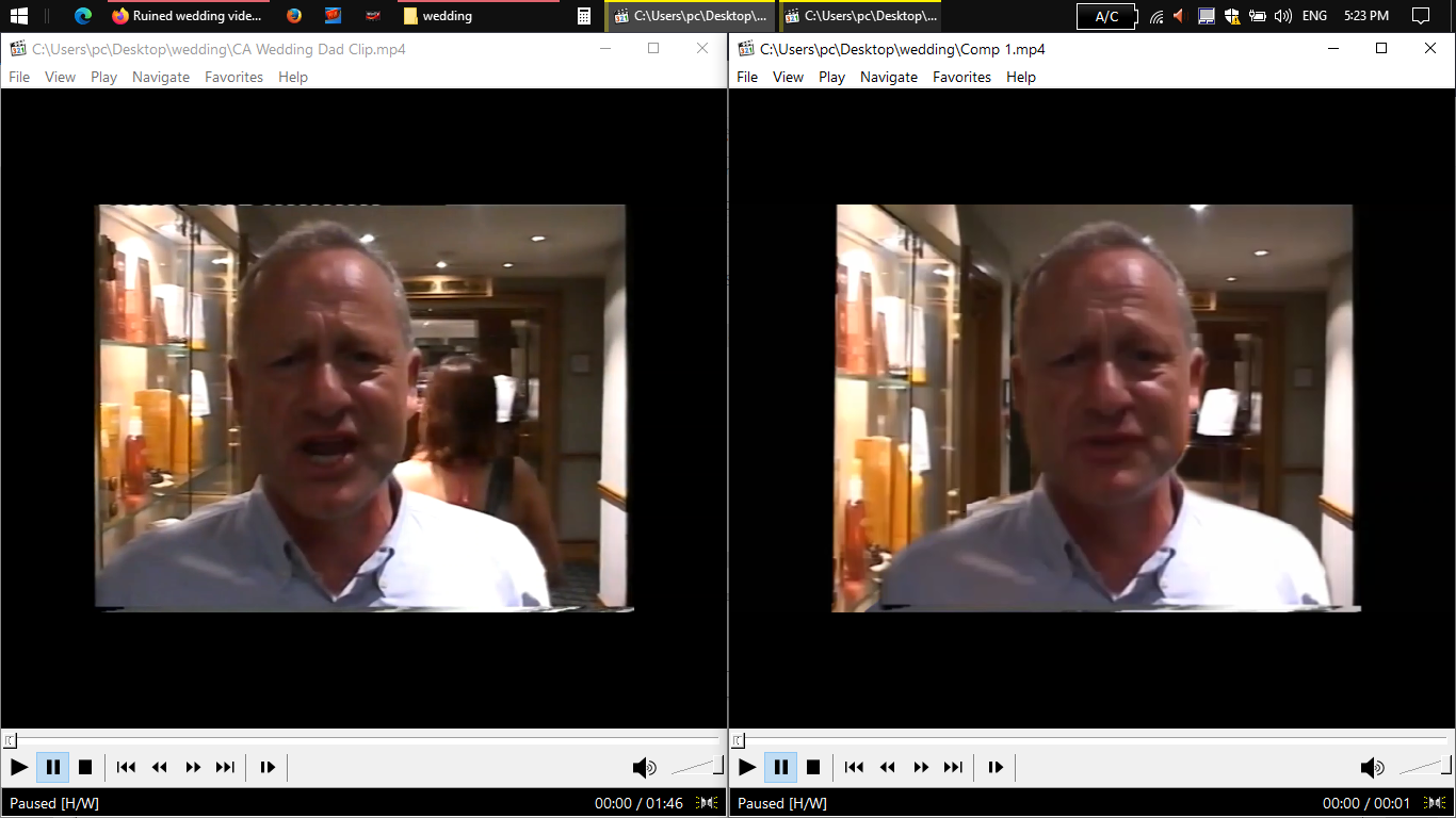

I have attached the clip, in case as per DB83's suggestion it could be looked at by the pros. I can pay, if someone is able to help (I imagine the end result would be far better than any attempt I could manage). And if not, then I will try my best with the tutorials you have recommended.
It starts off with my dad having a bit of a drunken laugh (he was an amateur theatre actor), and then around a minute in, he gives a more serious message. I think it's about 1:18 that the ex-husband shows up. I assume to keep the video consistent it would be best to just take any/all background out for the entire clip or something - is it maybe even possible to loop the background from before he shows up? -
Thanks for the clip.
I will leave it to the experts to see if the idiot (clearly drunk) can be removed. But do also consider my other suggestion of a sound bite with other footage and smrpix's equally good idea of combining that other footage/images with a head shot of your father in a lower quarter of the screen. As it happens, most of the message is intact and only a small part has been 'ruined'. -
Here's an idea based on DB83's original suggestion:
Note the audio cut at 1:08. -
Thank you, I will have that as a good fall-back, in case I don't find any other way
My thought was in excising that one line you not only lose the clown, you get your dad's message across more positively as well. Best of luck.
No.
That camera work is terrible. It shakes, your father is blurred out of focus, lousy exposure.
It may be "easiest" to stabilize the entire clip where he speaks (was there more before the sample, or after?), cut out and rebuild a background, then overlay him. Almost like a green green, but after that fact in post. There is far too much crap for a simple content-aware removal.
Can the moron be removed? Yep!
Easy to do? Nope! Although it's more tedious (time-consuming) than difficult.Last edited by lordsmurf; 24th Feb 2020 at 14:18.

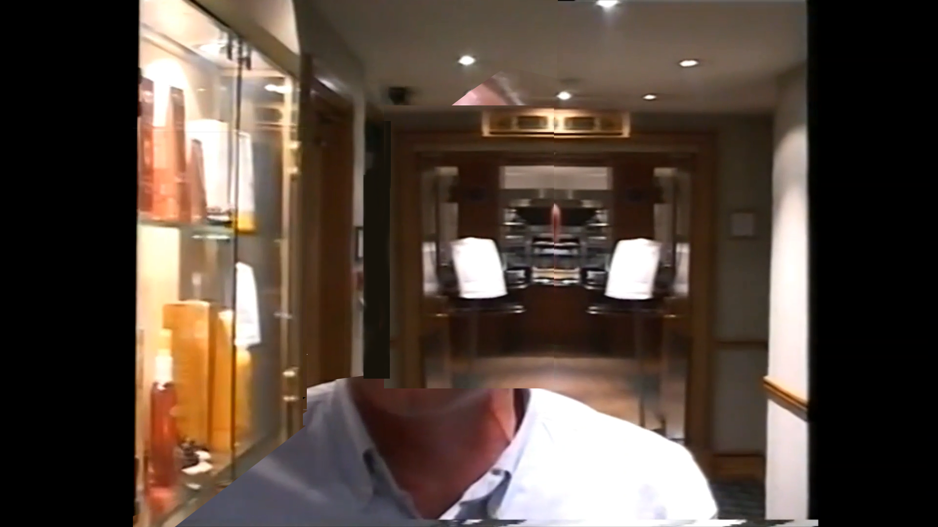

[Attachment 52151 - Click to enlarge]
A quick example of using Mocha in After Effects to rotoscope dad out and eliminate the background people.
Without thinking much:
1. Take a snapshop of a couple frames of the video where he moves to the left and right - this reveals the background.
2. Per example attached, use a paint program like Gimp or Photoshop to merge the people-less parts of the background together so when dad moves left and right over the background, we don't see any people - just the building.
You can go all out and repaint an entirely new background.
3. Stick both original clip and background image in the AE composition.
4. Do the mocha thing noted earlier.
open the layer for the video clip, add mocha, edit the mask in mocha, close and save to go back to AE.
5. Turn on the matte, feather (to a few pixels wide), and check.
Again, the time waster would be you'd have to sit and adjust the mask in Mocha to tightly mask dad out without including the background.
Just boring moving matte points around - nothing amazing because even a kid could do it.
When the matte is tight and good, then jump back into AE and render out the composition.
The example is the first 1 second of the video using a rough matte. Tighten it up and it'll look great. -
