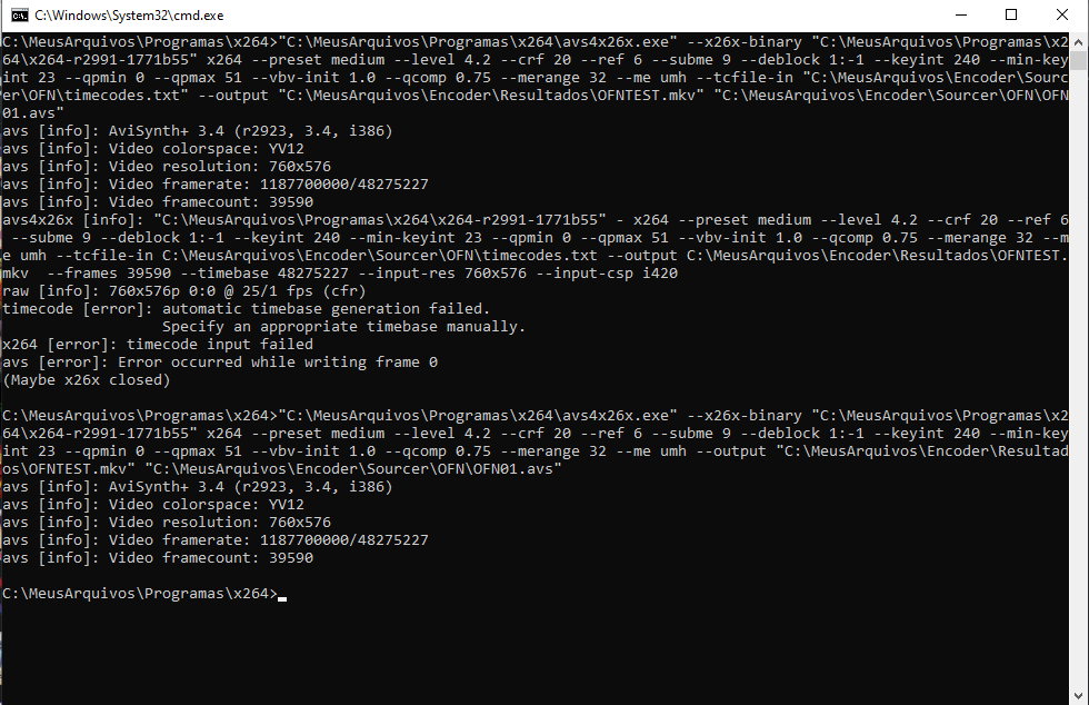

    Another point is that I can only encode using virtualdub, in x264 it causes an error that I don't understand.
    whether or not using the timecodes.txt on the line.
    [Attachment 52159 - Click to enlarge]
    Thank you for your patience.

  7. Examine the timecodes
    Maybe there is error in procedure somewhere
