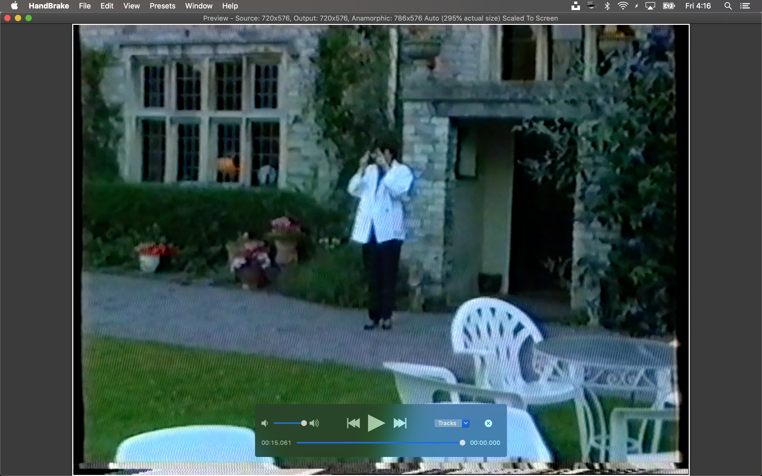

Hi, I'm currently capturing some 20 year old home videos which were taken on a questionable camera, so archival quality is already out the window. There seems to be around 6 hours of footage on 8 videos.
I'm capturing with a £20 August vgb100 from a sharp vcr with no tbc, as the budget is low.
I'm capturing to Virtualdub 2 into a lossless x254 avi with lossless audio, the usb capture device seems to keep the audio and video synced nicely.
I'm then de interlacing using the highest settings on handbrake (EEDI2 BOB) with a strong NLMeans noise reduction filter and compressing to RF18, all at about 2 frames per second (which seems slow).
I'll then be taking this into premiere pro or iMovie and applying stabilisation, which makes the shots buttery smooth and nice to watch (also crops the borders). Then some slight colour grading, audio normalisation and slight hiss reduction. They'll then be split up into separate files and uploaded to the cloud.
I'm happy to upload a piece of video, but hope you can tell something from the attached screenshot. It looks very grainy and blurred to me, I might just be over critical and used to hd video?
[Attachment 52082 - Click to enlarge]

1. The video shows some horizontal wobbling that indicates a lack of line timebase corrector (TBC) in the VCR. The deinterlacing software is working overtime to try to correct it, and I think that's why the output video is blurry.
2. The graininess suggests a low quality cable between the VCR and the capture card. You will need to use a double insulated S-Video cable to eliminate that.
3. Looking at the histogram, your blacks are crushed. You will need to increase the brightness in your capture card's settings, and then you may also need to reduce contrast in order to avoid blowing out the whites. -

Yeah I do understand that no TBC degrades the quality. Would temporal smoothing in virtual dub help this, to my eye it seems to? Is there any way to stop this wobbling effecting the deinterlacing?
Ah okay, unfortunately my vcr doesn't have s video output, but I am using a double insulated and high quality start to component cable. Is there anything else which could be causing this graininess?
I will take a look at the colours, I've neglected them trying to get the picture right. The colours seem to flash green and red a lot, what is that?
Thanks for your help! -
Not really, it isn't designed to fix timebase issues.
Not in software that I know of.
Maybe a noisy power supply or bad capacitors in the VCR.
VirtualDub's Color Camera Denoise filter can get rid of some of that, and the temporal smoother also helps. I think the red and green are what's actually on the tape, either because of the camera or because of the age of the tape. -

Your capture device doesn't support component (YPbPr). Do you mean SCART to Composite (one yellow RCA cable for video)?
The screenshot looks like the same Y/C crosstalk people keep posting about this past month, caused by capturing composite as S-Video. (Haven't viewed your video sample.)
Linking this post so you can compare his images to yours, but also read my response in post #26 and the replies below: https://forum.videohelp.com/threads/395933-Capturing-Scart-with-VHS-DVD-combo-player?p...=1#post2573745
