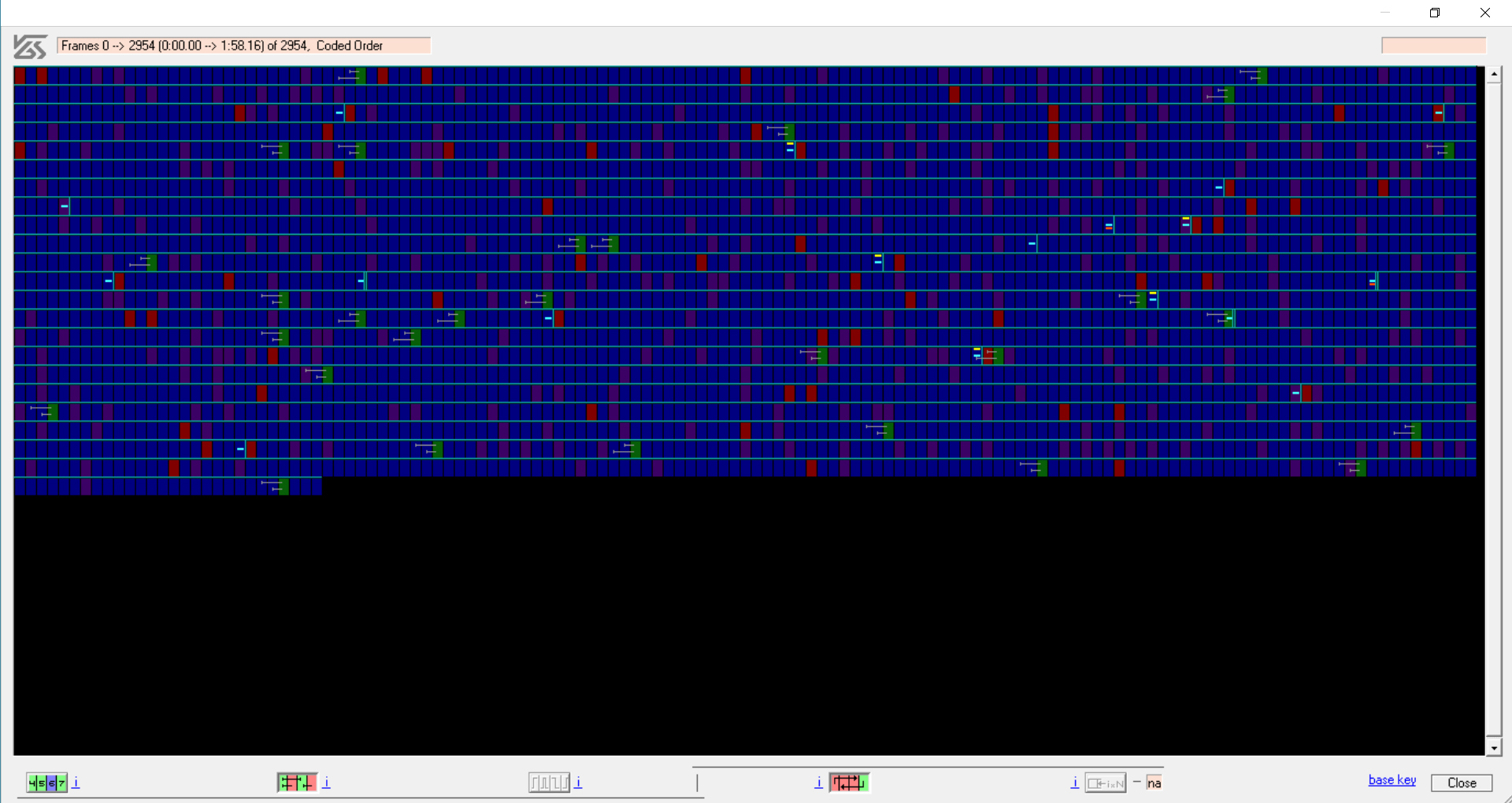

    I want to find a fast way to determine a video file's GOP structure when no such information is present in MediaInfo.
    I managed to find the answer for files opened by VGS (Visual GOP Struct) feature of GSpot:
    For example, here is how an open GOP file looks like:
    And here is how a closed GOP looks like:
    For formats not recognized by GSpot, one can simply inspect the frame structure in AviDemux for example and base conclusions on the following:

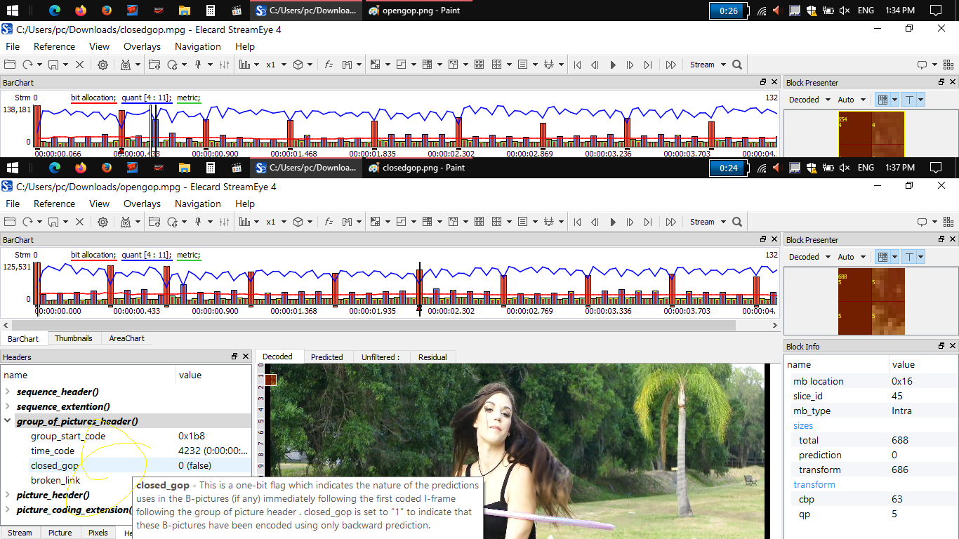

    Any idea what to look for in Elecard?
  8. Image
    [Attachment 52070 - Click to enlarge]
    For MPEG-2 files, the left text info panel will state whether the file is open or closed GOP.

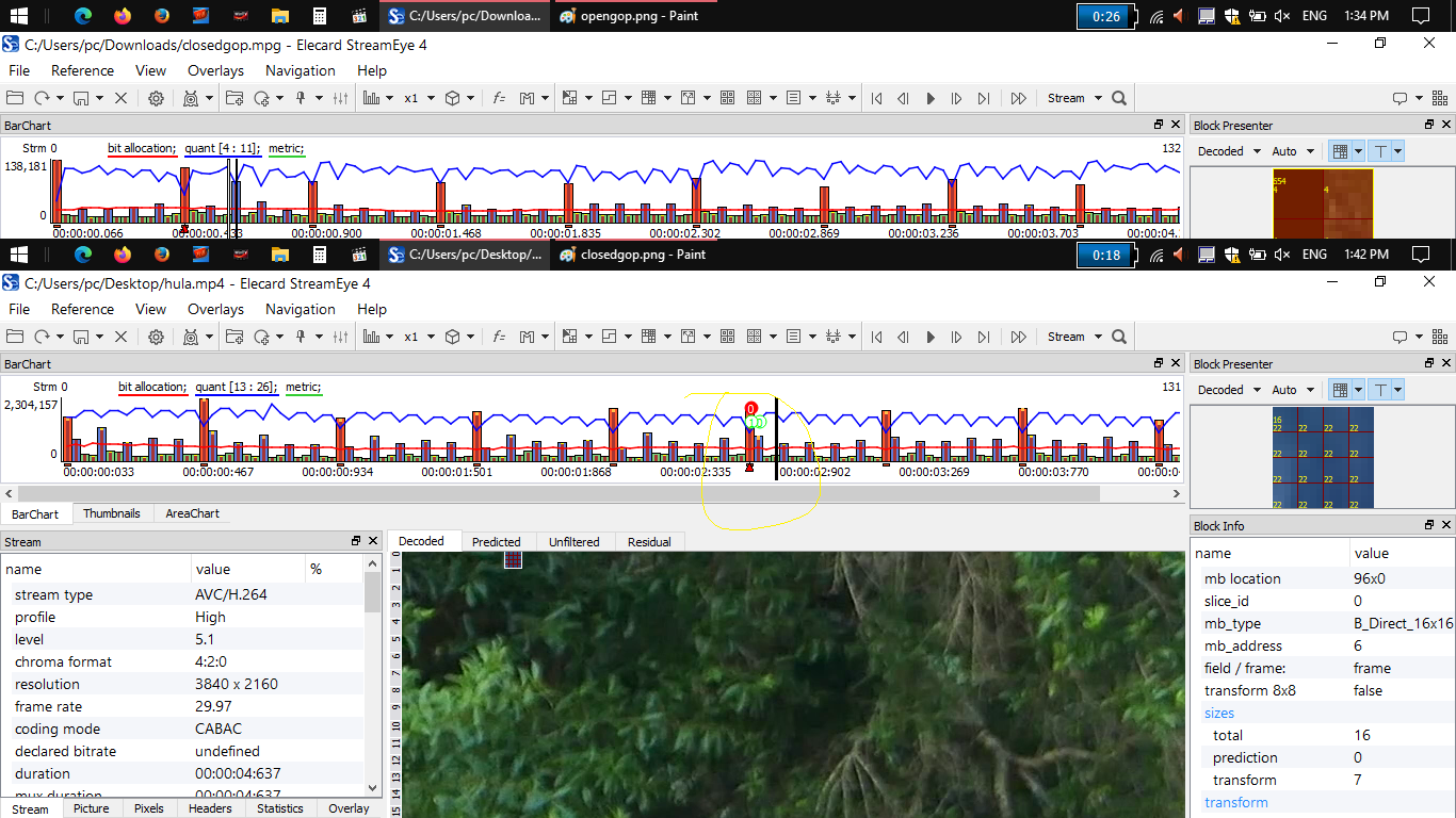

    [Attachment 52071 - Click to enlarge]
    For MPEG-4 files, i don't see any info panel that states this.
    Instead, I have to scroll through the IPB frames to verify (notice when I click on a P/B frame, it'll indicate which other frames it refers to).
    CloseGOP means the PB frames only refer to the frames between surrounding I frames.
    OpenGOP means the PB frames can refer to frames outside the surrounding I frames, AFIK.
