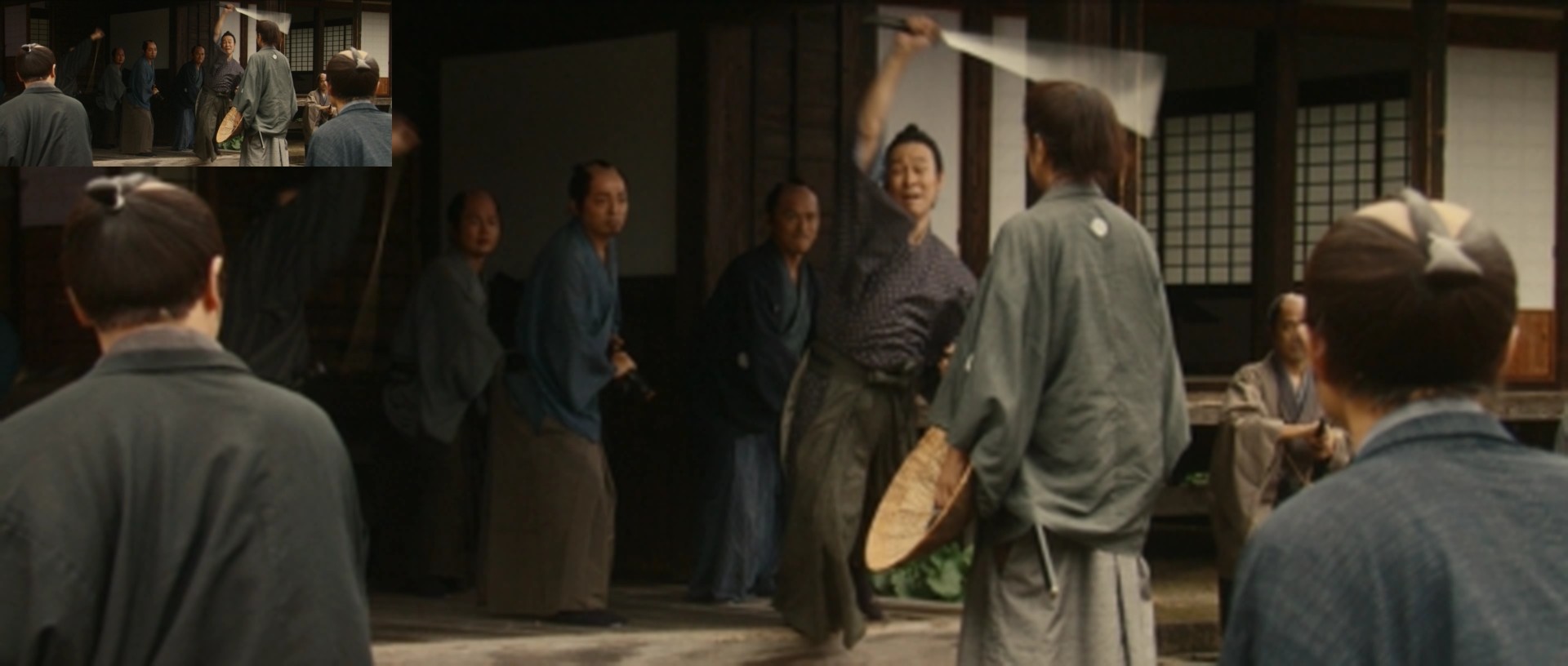

Which looks sharper the small inset image at the top left or the full image?
[Attachment 52068 - Click to enlarge]
View the image full size. The bigger image is just the small image upscaled. Neither has more detail than the other.Last edited by jagabo; 20th Feb 2020 at 12:08.
