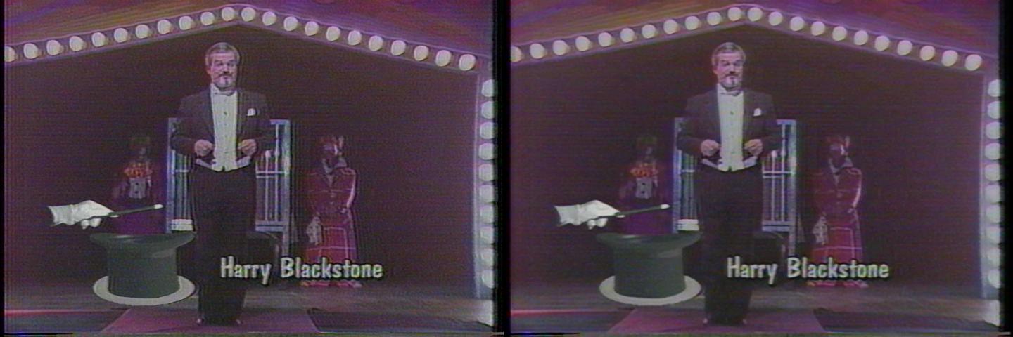

  1. I'm capturing VHS tapes of TV shows I recorded around 25 years ago. I have a JVC HR-S3500U and a VC500 capture device. I'm also using a Panansonic ES10 as a pass-thru device. I'm using S-Video cables and capturing at 720x480. I'm mostly using Avisynth and VDub. I'm mostly happy with the results I've been getting.
    Some of the captures have this double image or halo. What is it and is there anyway to fix it with what I have? The tapes were recorded from OTA TV mostly.
    Thanks for the help.
  2. Multipath reception? This is close:
    function ShiftRight(clip v, int pixels)
        Crop(v,0,0,-pixels,-0)
        AddBorders(pixels,0,0,0)
    #call with:
    src = last
    Overlay(last, ShiftRight(last, 8), mode="subtract", opacity=0.15).ColorYUV(gain_y=40)
    MergeChroma(last, src)
    Play with shift, opacity and gain.

    That helps. I'll try to adjust it more later.
  4. It's not a great fix. It works pretty well in some places, not so well in others.
  5. Could also be magnetic image transfer since the tape had been wrapped around itself for ages, magnetic image signal on one part of the tape could transfer to another part of the tape wrapped above/below it.
  6. Another problem is the strong oversharpening halos from the VHS deck -- and the subtraction maks them worse. Dehalo_alpha() can reduce them but it damages the picture.
    LWLibavVideoSource("Cap.avi")
    AssumeTFF()
    ConvertToYV12(interlaced=true)
    QTGMC(preset="fast")
    src = last
    Dehalo_Alpha(rx=7.0, ry=1.0, darkstr=0.8, brightstr=0.8)

  8. I'm finding tapes that have 5 or even more of these faint images. They are mostly off to the right side of objects. I've attached an example.
  9. Multigeneration VHS copy? FineDehalo2 and FineDehalo gets rid of a lot of it:
    original+qgtmc | finedehalo+qtgmc
    [Attachment 52587 - Click to enlarge]

  13. Originally Posted by jagabo View Post
    What script did you use?
  14. Originally Posted by Micheal81 View Post
    LWLibavVideoSource("Capture.avi")
    AssumeTFF()
    SeparateFields()
    BilinearResize(width/2,height)
    FineDehalo2(hconv = "-1 -1 5 5 40 5 5 -1 -1", vconv = "-1 -1 1 1 40 1 1 -1 -1")
    FineDehalo(rx=2.5, ry=1.0, DarkStr=2.0, BrightStr=2.0, ThMi=0)
    #ColorYUV(cont_y=140, gain_y=50, off_y=-10, gamma_y=100, cont_u=100, cont_v=100)
    Spline36Resize(width*2,height)
    Weave()
    QTGMC()
