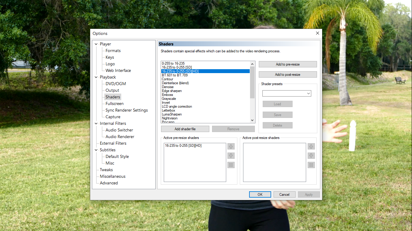

    • I tried going to Play -> Shaders -> Select Shaders and applying the "0-255 to 16-235" shaders (tried all 3) but they did nothing.

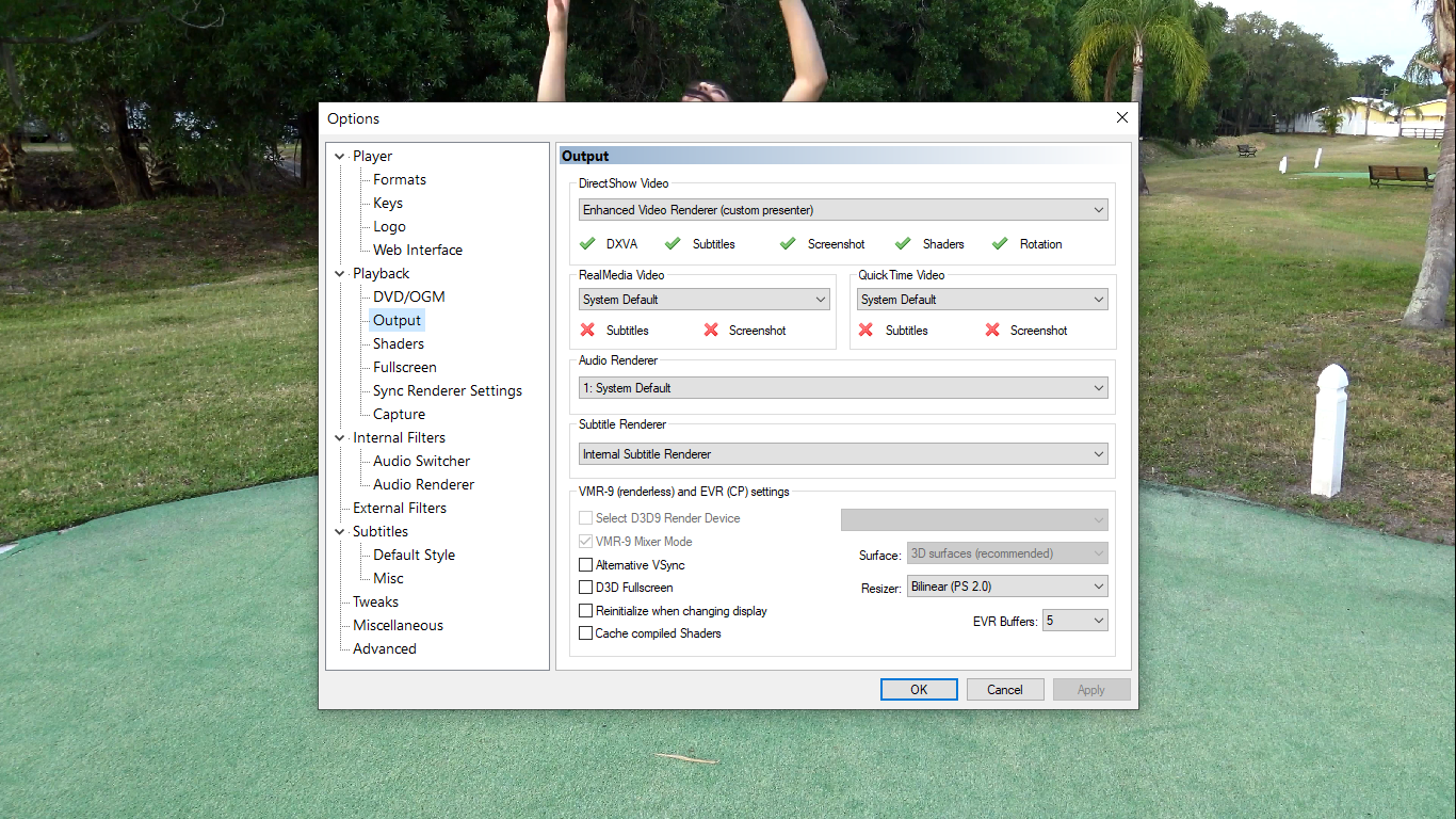

    Join Date: Feb 2020
    Location: NY
    Check the actual renderer being used
    (hit "o" for options => playback =>output)
    This is what it shows (image attached). I think these are the default settings. I don't recall changing anything in here. Anything look off/out of the ordinary?

    VMR9 (renderless) . Check the other computer's MPCHC - it probably isn't set to that

    Your settings -> Playback -> Output -> Directshow Video Renderer choice can't use shaders (x).
    Pick any other video renderer that supports all the features (v).
    Then, add the 16-255 to 0-255 shader.

    I seem to have solved this. Thank you all for pointing me in the right direction!
    The solution was the following:
    Change Options -> Playback -> Output -> DirectShow Video from default VMR9 (renderless) to EVR (custom presenter).
