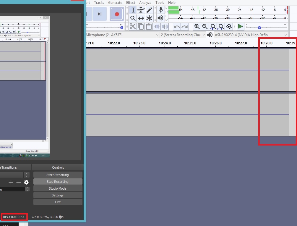

    i'd like to know what the issue is here.
    1. i'm recording video and device audio (not mic) in OBS (some gameplay, or even a youtube video playing in the background has the issue)
    2. i'm recording audio with my mic in Audacity (speaking over gameplay, or even not speaking over anything i record (the issue happens weather there's a lot of audio information being recorded, or nearly non at all - if that's even relevant or not) - the only purposeful audio recorded is a start and finish clap for syncing the Audacity-recorded audio file and the OBS-recorded audio/video file, which i do later in Vegas)
    2.a. (there is no sync issue with the audio and video recorded in OBS when placed in Vegas)
    3. the issue is visible when placing the OBS file (audio and video) and the Audacity audio file into Vegas: the Audacity audio file is smaller in length than the OBS audio/video file, even if i start recording in Audacity first. So the Audacity audio file should be longer in duration that the OBS file. But it's not. After some time The OBS file becomes longer. In a 10 minute recording session, the Audacity file is about 10 seconds shorter, increasing the difference to 20 seconds if i record about 15/18 minutes (values not accurately represented, i don't remember the exact numbers.
    The issue is that by the end of the recording session, OBS has recorded a lengthier file than Audacity!
    anyone know why this happens? and how can i fix it?
    here's a picture with recorded times.
    [Attachment 52034 - Click to enlarge]
    again, i started recording Audacity first, yet after minutes the duration is shorter than OBS.
    i stopped the recording less than one or two seconds in between each other.

    5. Recording for 2:22 minutes (on my phone's stopwatch) actually recorded only 2:19 seconds in Audacity. da hell?
    i tried the stopwatch thing on obs. 5 minutes in obs equal 5 minutes realtime.
    im assuming this is the usb mic's problem then? would a jack mic solve this issue? or an external audio board?

  2. Member Cornucopia's Avatar
    That’s a strange issue, if what you say about common sample rates is true (the likely problem scenario), but I think you could easily get around the whole thing by recording all audio parts through OBS, since it is certainly capable of that.
