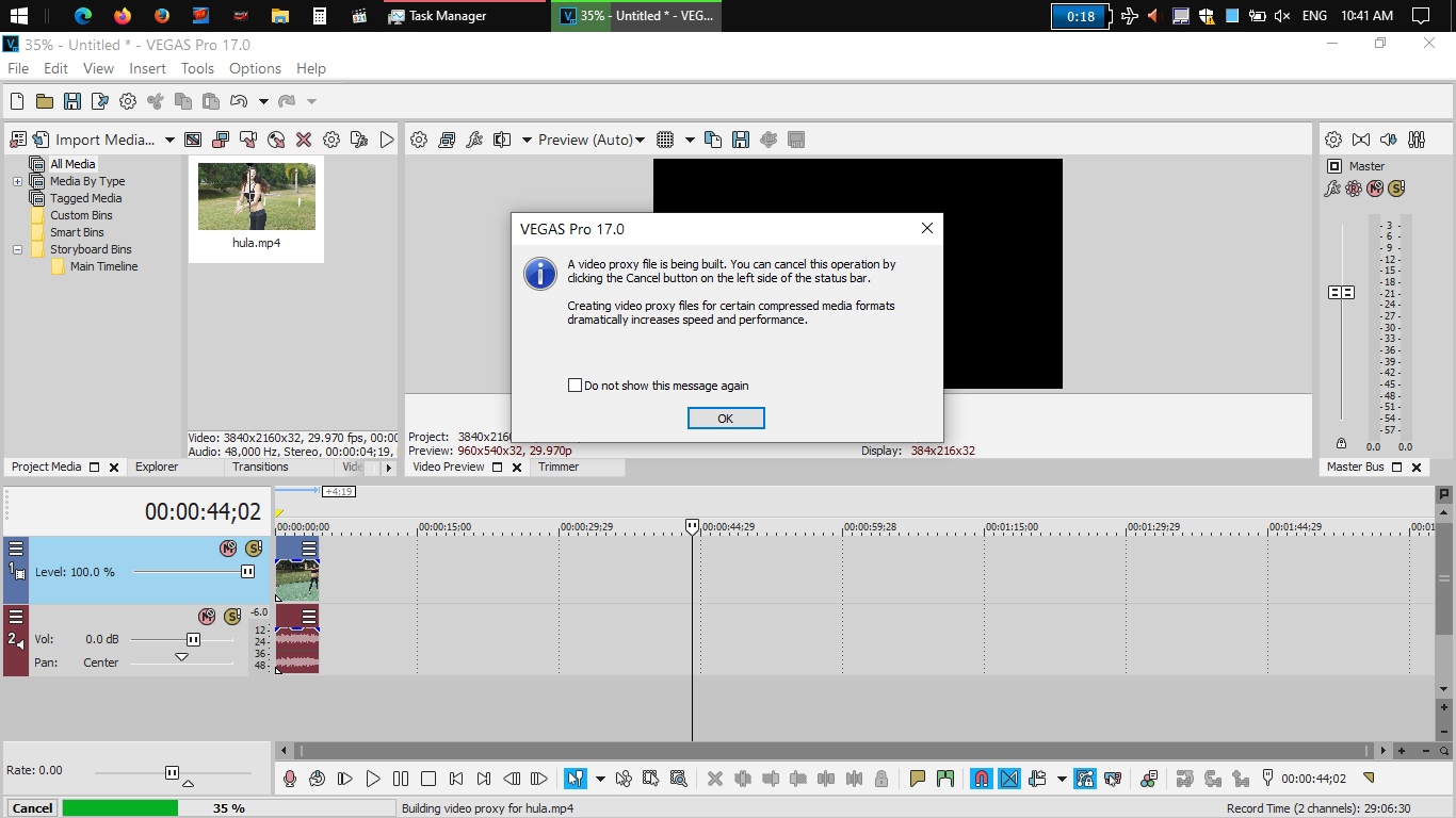

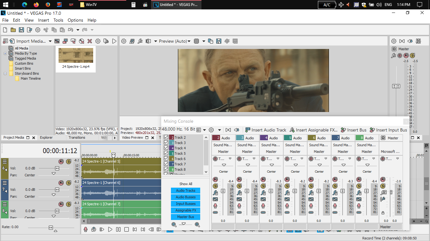

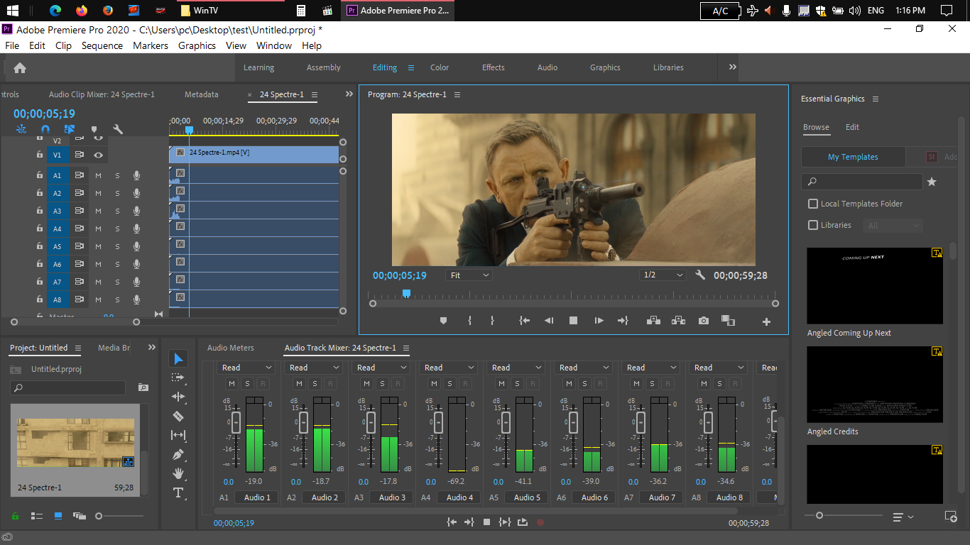

  4. I created a test case - a file with a aac lc 8 channel (7.1) audio track - and tried to open it with a few common video editing programs.
    [Attachment 52090 - Click to enlarge]
    Vegas Video clearly can't handle such a file - it only opens 7 tracks instead of 8, and the sound is distorted during playback.
    [Attachment 52091 - Click to enlarge]
    Premiere CC 2020 can handle such a file - it opens up all 8 tracks, and the sound is fine during playback.
    This ONLY works when the encoded original is in MP4 format, not MKV - neither of the two handles the latter.
    This suggests that you may need to compromise if you can't convert your file into some sort of compatible file format that TMPGENC handles (I'm thinking PCM/FLAC 7.1/8 channel audio in a MP4 file might do).
    Otherwise, you know Premiere probably will work with your file, but it'll reencode the entire video track on output.
    The limitation is merely the nature of the video editing profession.
    One rarely gets multi-channel sound in a MP4/MKV file, if ever, from a professional production shoot, and muti-channel audio is almost always recorded as seperate tracks for postproduction panning and placement, thus, no good support by most video editing programs for this. Consumer devices can record 5.1 sound, so that's typcially the maximum supported.

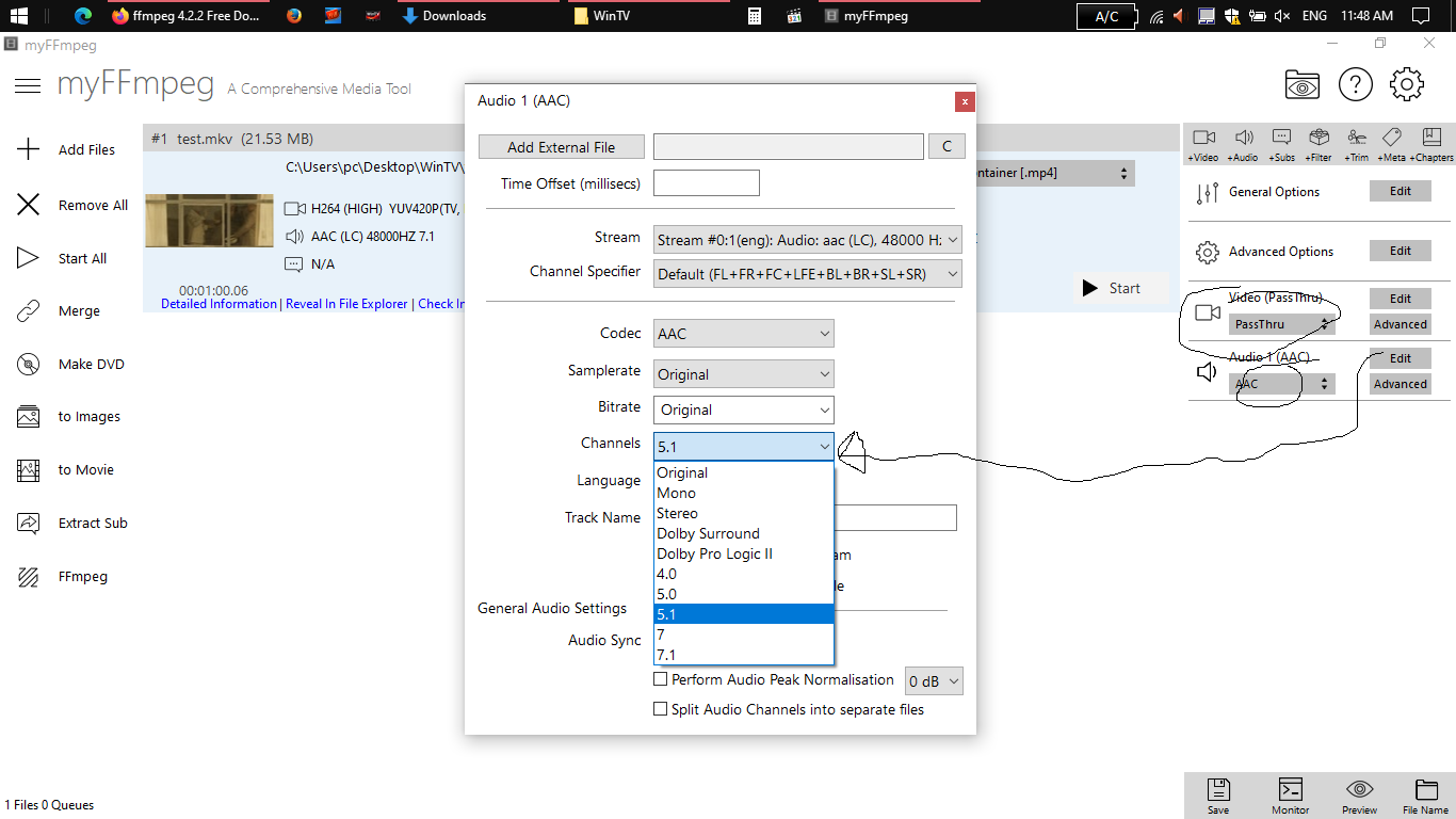

    2. myFFMPEG
    Oh!!
    That is a REALLY nice and easy to use interface for FFMPEG!
    I'd even use it over FFMPEG for how nice it is if I had a use!
    [Attachment 52095 - Click to enlarge]
    Super easy to convert the 7.1 audio to 5.1.
    Simply set the type to AAC, then EDIT the audio conversion SETTINGS to set the channels to 5.1.
    I tested my test clip I posted earlier and it works fine - no issues with the audio down-mixing.

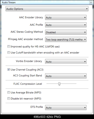

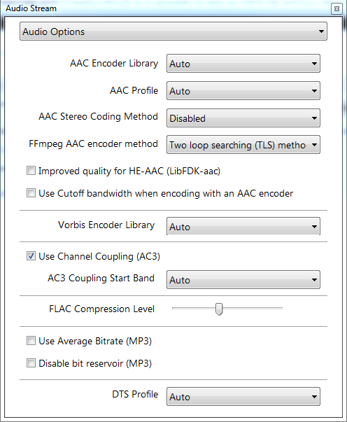

    So, what about the advanced audio settings in Myffmpeg? Click image for larger version
Name:	Advanced Audio Settings..PNG
    Do I need to adjust these or will just having the settings in the "edit" tab set to how you described be sufficient enough to what I want to achieve (no loss or very minimal loss in quality after converting to 5.1)?
  10. Nothing to change in the advanced settings.
    In the audio settings, above channels, you'll see bitrate.
    Increasing that to the maximum would help minimize losses.
    You'll always have some loss reencoding.
    For aac, the minimum is giving each channel about 128kbps (basic acceptable quality. Like common streaming radio or mp3 music files).
    For 5.1 (6-channels), that's about 768kbps total.
    That or 2x-3x that is sufficient.

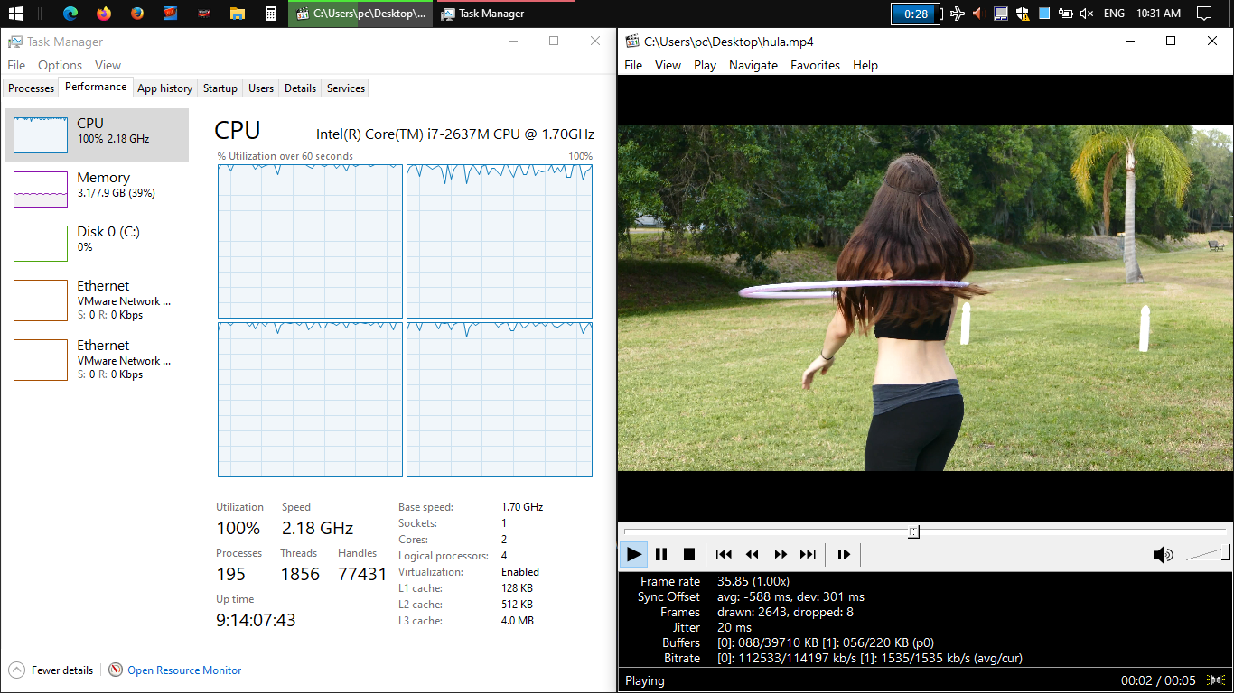

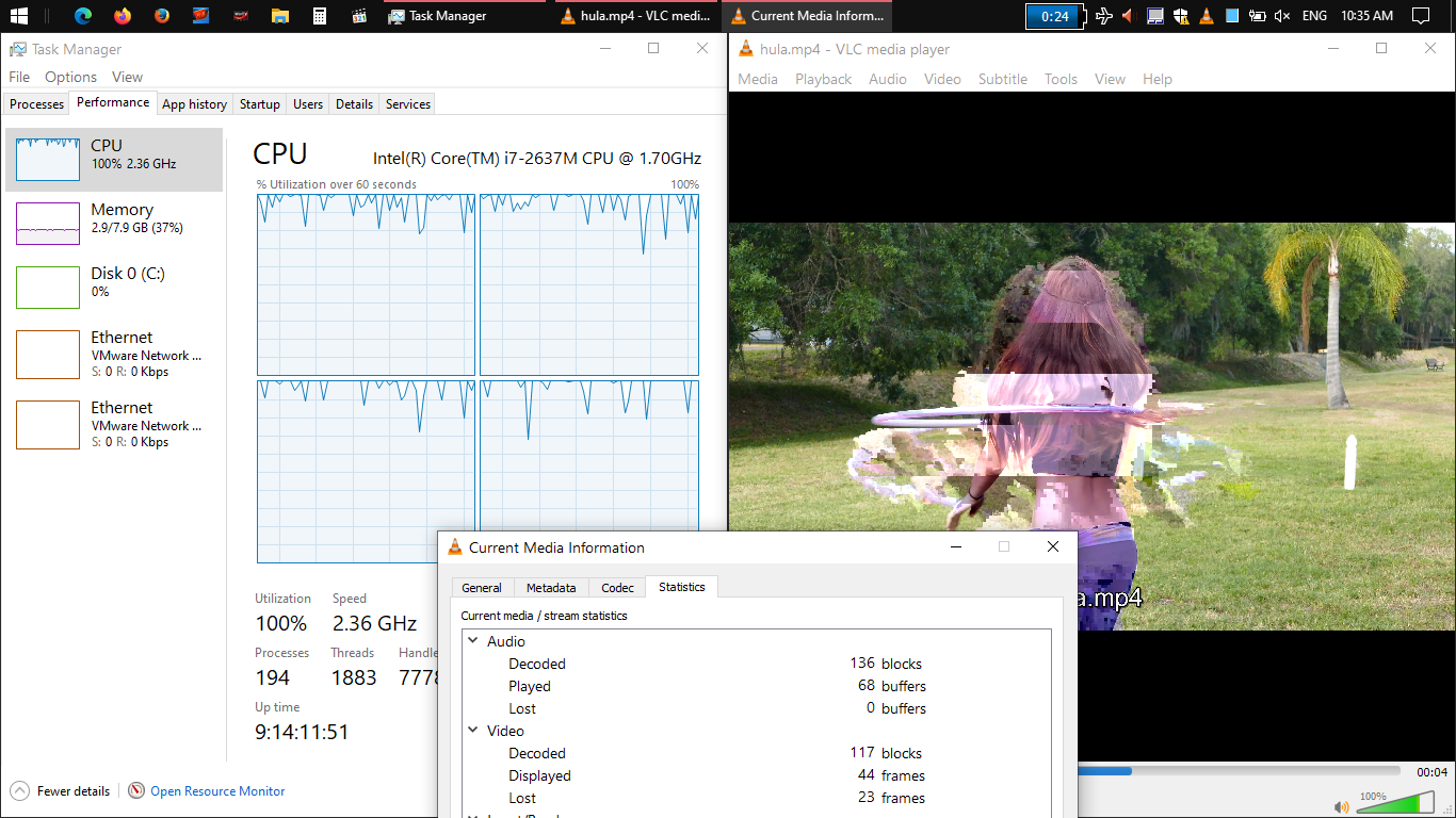

    1c. Note that the selection of your video player, video editor, etc. affects your ability to play 4K on a laptop.
    eg. With a default VLC install on a i7-2673M laptop, it can't play 30fps, drops frames, and has blocking artifacts.
    [Attachment 52122 - Click to enlarge]
    On the other hand, MPHC plays 4K just fine at over 30fps on the same laptop.
    [Attachment 52123 - Click to enlarge]

    1f. Proxy
    Some video editing programs like Premiere, Vegas Video, etc, can create video proxies (lower resolution video copies of your originals for quicker playback during editing).
    [Attachment 52126 - Click to enlarge]
    [Attachment 52127 - Click to enlarge]
    By doing so, you can even edit 8K on a years old laptop without much trouble. Playback will be smooth, and the only thing you'll wait for is the encode (which is limited by the hardware capabilities - newer tends to be faster at encoding even with the same number of cores, ghz, etc).
    By creating proxies for Vegas Video for example, I can easily scroll through the 4K video, play it, and edit it like a lower resolution video on the i7-2673M laptop.

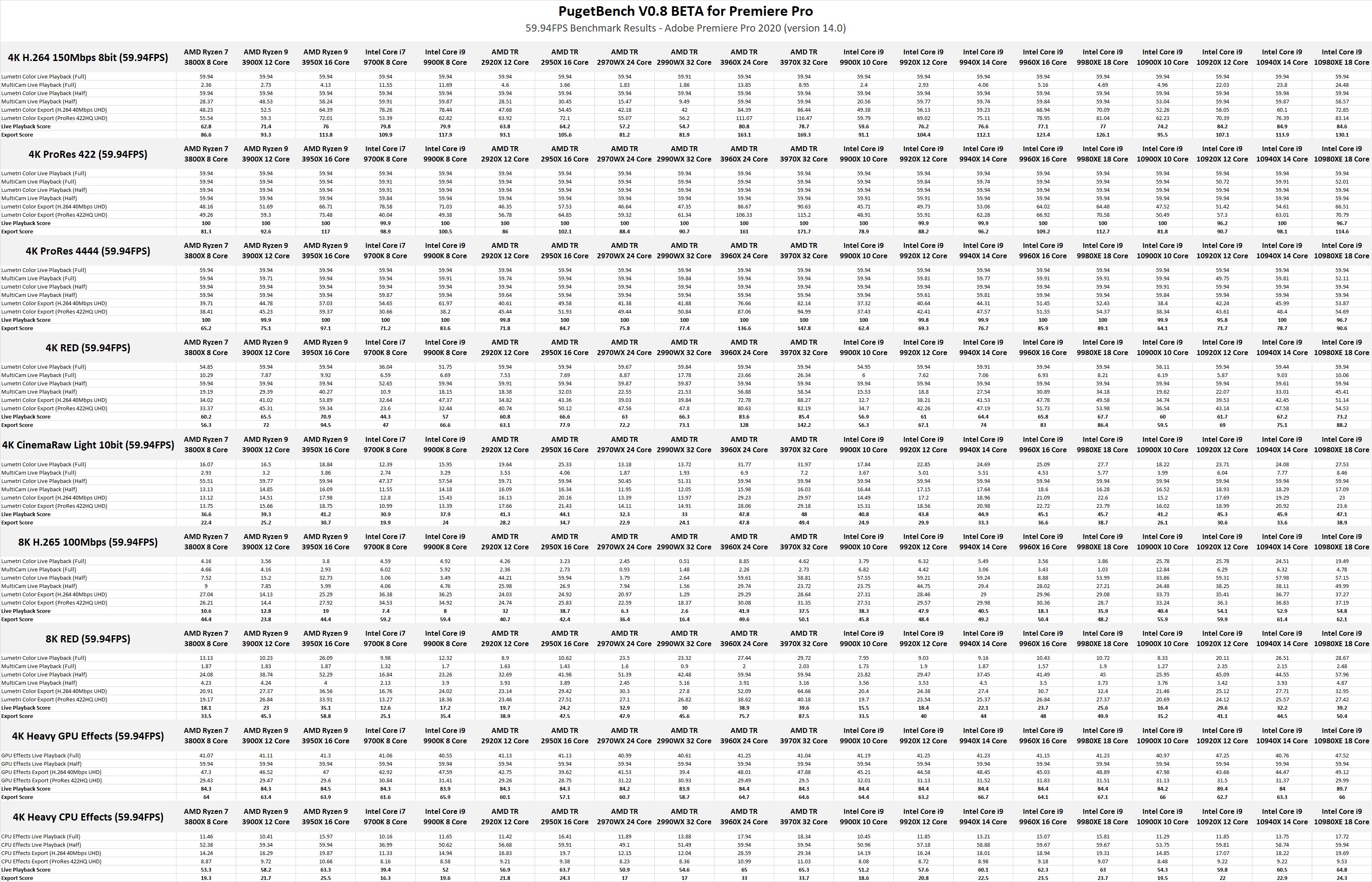

    Testing only 1 program Premiere Pro on different CPUs gives these results:
    https://www.pugetsystems.com/labs/articles/Premiere-Pro-CPU-performance-Intel-Core-X-1...-3rd-Gen-1629/
    Just skip reading and look at this chart: https://www.pugetsystems.com/pic_disp.php?id=58322
    Jump to the bottom, 4K HEAVY CPU EFFECTS (testing the power of the CPU).
    Notice that for 4K PLAYBACK, all CAN NOT achieve 30fps or better playback!!!!
    Look above at 4K HEAVY GPU EFFECTS (testing the power of the Graphics Card).
    NOTICE that for 4K PLAYBACK, all CAN achieve 30fps when a NVIDIA 2080ti Graphics Card is installed.
    This means for 1 program Premiere CC you can get 30+fps playback even on a old PC with a good Nvidia graphics card.
    (If you look at the link above, even a 1050ti can handle H.265 4K playback.)

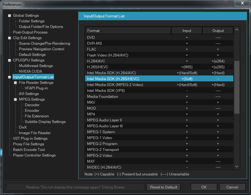

    No idea about tmpgenc + Quicksync.
    Old forum says "check Preferences->Input/output format list->Intel Media SDK (Hardware). You should see "+" for Input and Output."
    From the same 3rd generation, you should be able to use Quicksync on encodes to get similar speed increases vs software encodes on your laptop.

    [Attachment 52141 - Click to enlarge]
  21. Looks like TMPGENC is reporting correctly for the 3rd gen quicksync capabilities. Not much you can do about HVEC/H.265 not being supported by the CPU hardware. At least H.264 is, so as long as you output in H.264 MP4 files, you can get super-fast encodes. Test that.

  23. "TMPGEnc Video Mastering Works 7 further supports the creation of proxy files. "
    https://tmpgenc.pegasys-inc.com/en/product/tvmw7.html
    That would be the only way to make it run snappier on the laptop.
    The creation of proxy files naturally can result in re-encoding of the video and subsequent minor quality drop.
