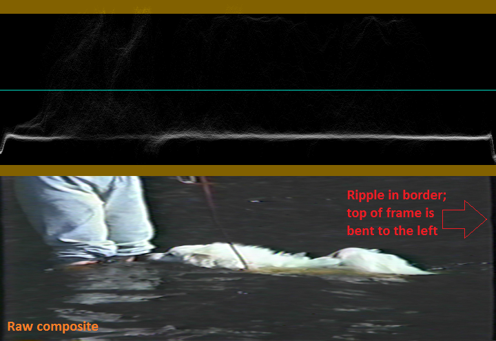

    As I noted in my response to your DigitalFAQ thread, I call this problem Funai Flicker.
    https://forum.videohelp.com/threads/...=1#post2420343
    https://forum.videohelp.com/threads/...=1#post2563178
    I didn't realize that the S-Video output is also digitized, like the composite output is in Dubbing Mode, but it makes sense. These crummy combo units utilize a composite playback path from VHS, so all other outputs need to be Y/C separated from this. This is done using a digital comb filter, so the S-Video output ends up going through the whole path of AGC & TBC.
    The faulty AGC causes the flicker, while the TBC is beneficial. Lines are straightened and the video is frame sync'd.
    [Attachment 52074 - Click to enlarge]
    [Attachment 52075 - Click to enlarge]
    If you run the composite output into a Panasonic DMR-ES10/15 for passthrough as you suggested on DigitalFAQ, you'll get the TBC benefits without the flicker, but you'll likely still have highlights clipped unless you use an analog proc amp to bring down the over-exposed highlights before the Panasonic digitizes them.
