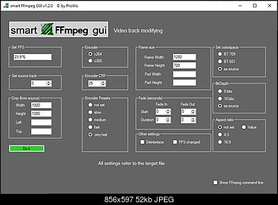

  2. Use my smart FFMpeg GUI.
    You can scale the video track to 720, setting CRF 25, veryfast.
    You can also reduce the audio size with audio encoding to aac 96k
    https://forum.videohelp.com/threads/395425-New-small-GUI-for-FFmpeg
    Download: https://files.videohelp.com/u/292773/Smart_ffmpeg_gui_106.rar
    How do you set 720p in this? It defaults at 208x32 which makes no sense at all for these videos.
    (Also you can't do audio and video tracks at the same time as far as I can tell. There's also no function to copy over the embedded soft subs to the smaller video file)

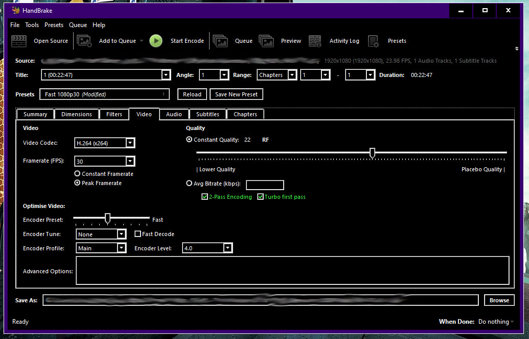

    I'm using the newest version of Handbrake, (ver 1.3.1 (2020010400) It doesn't have a field for me to specify file size. I'm keeping the .mkv format container because of the soft subs.
    [Attachment 52014 - Click to enlarge]

  10. Originally Posted by Startropic1 View Post
    DIMENSIONS TAB has the fields to control the size.
    Modify Video stream, select source and target file, Next, change frame size-YES, do crop detect, next, insert frame with and height, set encoder CRF to 25, set fps, select aspect ratio, leave all the rest as is, do it.
    You can mux the original audio track to the new video track. To do so, select the original file as source and specify the audio track number.
    You can mux the original subtitle track to the new video track. To do so, select the original file as source and specify the subtitle track number.
    Here you go
