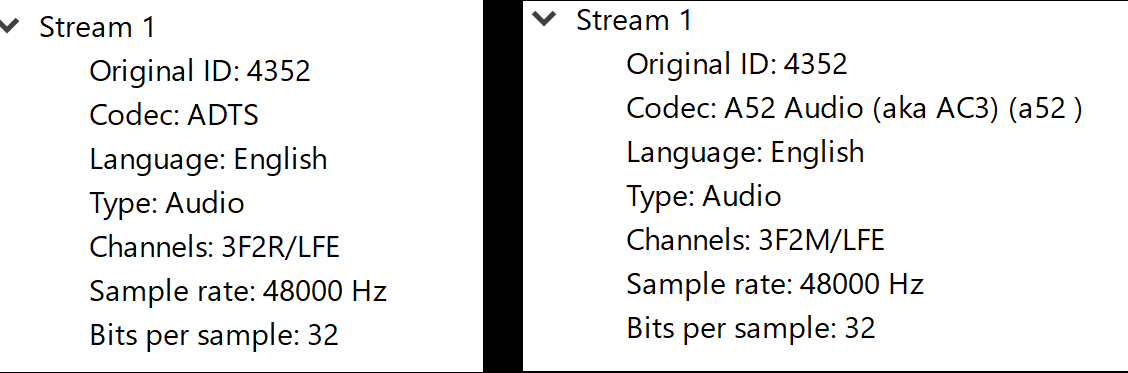

    Needed some help troubleshooting something and I don't want to create another thread so I'm editing this one. I've decided to use MultiAVCHD to create a blu-ray with multiple episodes. My first attempt transcoding, setting up a menu, and creating an iso to mount to a virtual drive to test went well except for the audio sounds bad. I'll post the media information screenshots below. The only thing I can think of is to turn off the "use eac3to" option.
    My audio bitrate in kbps went from 13 in the MKV, to 19 when muxing to M2ts, then 198 after output from MultiAVCHD.

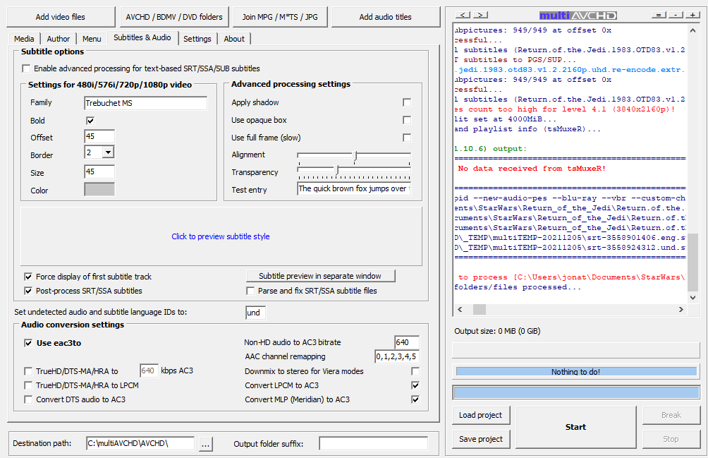

    hello i am trying to create a menu and then convert my mkv file with subtitles to a blu ray file but i keep getting the message below.
    It says there is no pcr on video pid. Does anyone know how to fix this?
    tsMuxeR (Version 1.10.6) output:
    PROCESSING ERROR: No data received from tsMuxeR!
    Trying again...
    MUXOPT --no-pcr-on-video-pid --new-audio-pes --blu-ray --vbr --custom-chapters=00:00:00.000;00:00:21.100;00:01:55.360;00 :05:01.010;00:08:11.030;00:12:22.790;00:13:56.040; 00:17:07.570;00:21:41.680;00:24:39.849;00:29:08.96 0;00:30:44.920;00:36:58.420;00:38:46.700;00:44:31. 710;00:47:37.560;00:50:50.000;00:52:46.290;00:53:3 8.840;00:56:08.990;00:57:57.600;01:01:55.330;01:05 :33.060;01:07:01.310;01:11:14.730;01:15:06.800;01: 17:28.600;01:21:44.860;01:25:20.580;01:26:05.789;0 1:27:04.850;01:29:18.480;01:32:32.840;01:35:55.210 ;01:39:39.030;01:41:36.990;01:43:41.610;01:44:40.7 00;01:47:56.200;01:49:54.480;01:50:50.870;01:53:50 .880;01:54:22.250;01:55:11.300;01:56:53.930;01:58: 48.010;02:01:12.650;02:04:04.360;02:04:40.860;02:0 6:28.800 --split-size=4000MiB --vbv-len=500
    -1, "C:\Users\jonat\Documents\StarWars\Return_of_the_J edi\Return.of.the.Jedi.1983.OTD83.v1.2.2160p.UHD.r e-encode.mkv", insertSEI, contSPS, track=1, lang=eng, fps=23.976
    A_AC3, "C:\Users\jonat\Documents\StarWars\Return_of_the_J edi\Return.of.the.Jedi.1983.OTD83.v1.2.2160p.UHD.r e-encode.mkv", track=2, lang=und, timeshift=0ms
    A_AC3, "C:\Users\jonat\Documents\StarWars\Return_of_the_J edi\Return.of.the.Jedi.1983.OTD83.v1.2.2160p.UHD.r e-encode.mkv", track=3, lang=und, timeshift=0ms
    S_HDMV/PGS, "C:\multiAVCHD\_TEMP\multiTEMP-20211205\srt-3558901406.eng.sup", lang=eng, fps=23.976
    S_HDMV/PGS, "C:\multiAVCHD\_TEMP\multiTEMP-20211205\srt-3558924312.und.sup", lang=und, fps=23.976
    [21:47:40] tsMuxeR failed to process [C:\Users\jonat\Documents\StarWars\
