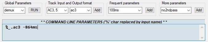

  9. @vangeliis can load the audio into 'UsEac3to' and apply the delay .. and we get the audio ready for remux ..
    In Output format->
    with ac3: %_.ac3 -864ms
    or
    with ac3-ffm: stdout.w64 -864ms | ffmpeg -i - -c:a ac3 -b:a 640k -center_mixlev 0.707 %_.ac3
    [Attachment 51991 - Click to enlarge]
