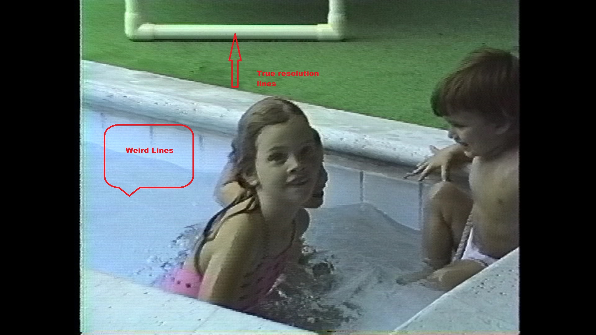

    Here is a Hi8 comparison I made years ago: DV conversion vs lossless capture - comparison (Hi8) [WARNING: auto-load!]
    Theoretically I could post a Video8 comparison that would better represent the type of difference you can expect, but I have too many other projects on my To-Do List. If you search this forum, there are some sub-optimal comparisons out there specifically for NTSC Video8 (not all variables controlled). The user FLP347 also posted a ton of comparisons of different methods for PAL Video8, but PAL DV uses a 4:2:0 not 4:1:1, so his DV-compressed Video8 comparisons in particular are relevant for compression artifacts but not for color.
    Did you have the camera's (line) TBC turned On when you captured this sample? The left border looks awfully jittery.
    For some reason, the luma has 120Hz flicker. This Avisynth script probably won't mean anything to you, but for other readers:
    SeparateFields()
     AssumeFrameBased().SeparateFields()
    If look at the fields we see varying brightness from scanline-to-scanline. If we separate the 240@60 again down to 120@120, the lines in the image disappear and we see the varying brightness as flicker.
    I would not use the Shader as suggested by babygdav to expand the levels. He misunderstands Sony's 7.5 IRE error. Their DV encoding uses ~16-255, not 16-235. If you expand at both ends, you will lose a lot of bright details. The proper fix is to lower the black level.

  4. Originally Posted by Brad View Post
    I checked the camera, and both TBC and DNR are on. However, I had saved numerous versions while searching for quality; so, I'm not 100% sure how the posted file was output from the camera. I will start taking better notes!... thanks for the input!

  17. Originally Posted by Brad View Post
    SeparateFields()
    I am further down the rabbit hole and have captured via s-video using the Magewell Capture Pro HDMI. I am noticing a flicker and wanted to try to see if your Avisynth-revealed "varying brightness" may be causing the same issue in this file.
    Would you recommend ffmpeg or VirtualDub as the easiest approach for running the Avisynth script? I have been able to run one ffmpeg filter (idet), so I have at least minimally started using ffmpeg...
    Update: I got this Avisynth script to run in VirtualDub:
    avisource("test1.avi")
    SeparateFields()
    The video was squeezed vertically the the flicker was more pronounced.
  18. Attached is the sample I was testing... What I interpret as flicker is most obvious in the wood trim in the background.
  19. ...I hope I'm doing this right...
    When I run Brad's script (one pass) to create a 60 fps video, (when displayed 4:3) I'm seeing accurate movement (the hand) but the stationary objects are jumping up and down. Any ideas on this issue?
    Update: After further study, the vertical jumping appears to be a remnant of the Avisynth SeparateFields - maybe caused by the different vertical dimension of the noise at the bottom of the frames. I don't see it in the original video.
  20. Capturing Memories dellsam34's Avatar
    Jan 2016
    Something wrong with your captures, In the attached screen shot I see some weird horizontal thick white lines separated by very thin black lines, that's not how resolution lines should look like, They should look like the one shown on the leg of the chair.
  21. Thanks,
    I had noticed those lines, but didn't know enough to realize they were weird. That one was a DV capture via firewire. The one I just posted "xmas 4-2-2..." is an s-video capture through the Magewell card. I didn't notice lines in the recent upload. Both were from the same camera (same 8mm tape).
    Brad had noticed the 120 Hz flicker in that DV capture you're looking at, but I guess those horizontal lines are a much higher frequency than 120 Hz.
    I was wondering if maybe TBC in the camera or DNR might produce these issues. I'll experiment with that when I get back home.
    MOVED this weird lines issue to https://forum.videohelp.com/threads/396961-Weird-Lines-in-8mm-Captures
