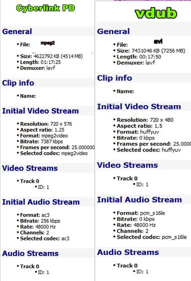

Name:	vdub vs cyb sm.jpg

    Attached is the comparison
    Nothing useful is attached. All I see is an inaccurate chart.
    Sorry, what is it that I need to attach to figure out why 1)it's cutting off the bottom 10% of the video 2) why the avi video doesn't look any better than the mpeg2 video? Maybe the response to the video quality will be because of the Elgato but if not I'd appreciate knowing if maybe I have some settings wrong.
    I'm glad to have whatever information I can get to do this as good as possible. It's frustrating to realize I've already spent a lot of my limited time capturing 2/3 of the many Hi8/Video 8 tapes I have but now wonder if I have mediocre captures. Once I got something (the Elgato) that would work on Win 10 I doubled my capturing since I could use the XP /Firewire laptop for the DV's and the Win10 Laptop for 8mm.If I have to do it again, I will. Post processing can be done later on maybe 15% that are special. I had hoped to not rely on these tapes anymore because they're only going to deteriorate more and take up too much space in a very limited area. Thanks for the comments!

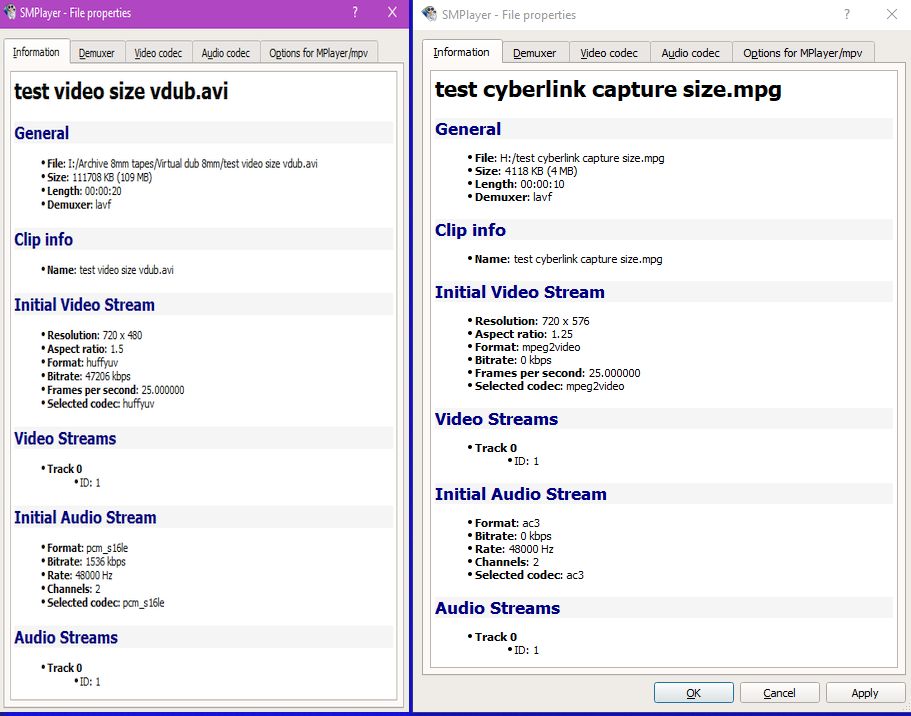

    Your VDub capture is 720x480 at 25fps. It should be 720x576 for your PAL tapes.
    This page shows the "ATI 600 USB"; if you buy one you need to ensure it comes with the analog input adapter cable. https://linuxtv.org/wiki/index.php/ATI/AMD_TV_Wonder_HD_600_USB

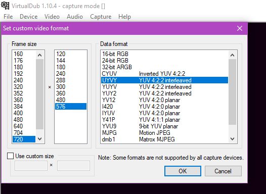

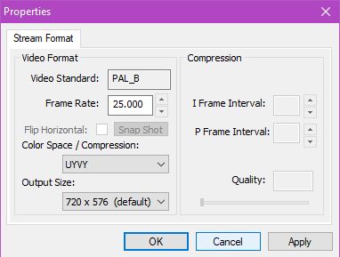

    Appreciate the information. There must be another setting somewhere in Vdub I'm missing. I found 2 different settings and both said it was already set to 720x576 but the video captured today was again 480 and cut off the bottom bit. Also huge as 52 minutes were 25gb. It helps to see your info on the ATI 600 USB. I see one that has the RCA females and s-video plug with it. I'm assuming that's the analog input adapter cable you speak of? Thanks.

    Vdub should detect your video source resolution automatically, Something is wrong, I never had to set the resolution on my capture cards. Also you should capture in YUY2.
    Jan 2008
    Yes those settings were done automatically when it detected PAL. Those captures are useless with the bottom cut off so I hope I figure out where the mistake is.Thanks for the tip on YUY2.
