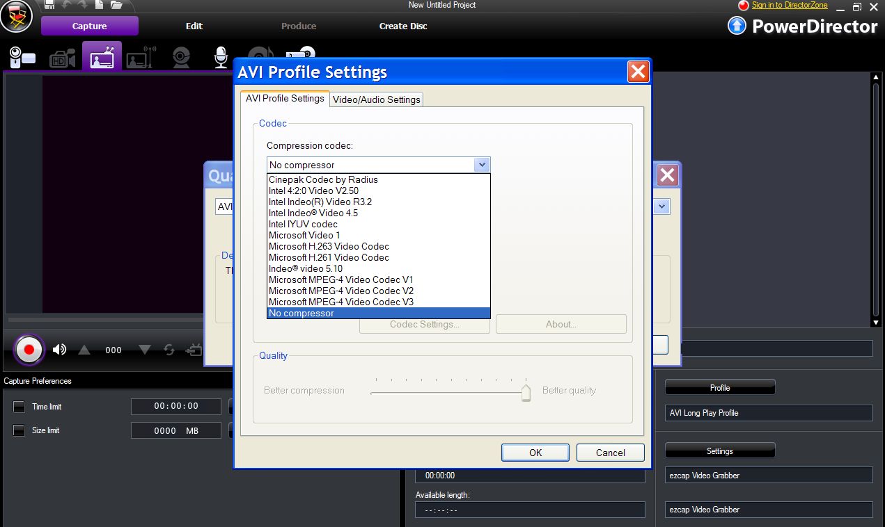

    That's more what I was hoping to get. A more specific direction. By the way, as I mentioned in another post, my complaint about the black tone was because I made a mistake in my video player after the capture. I had boosted some levels for another video I was looking at and forgot to reset it. Regardless, I just had a look for a digital 8 within my limited budget. Another development I haven't mentioned,is some events have occurred which means I don't have so much time to finish this. So I'm in a hurry to get it down in the next few weeks. After that the tapes go in storage to be dealt with some other time. I was actually hoping to be satisfied that the capture was as close to as good as possible and throw most of the tapes away. My plan now is to get as good a capture as I can now. Hopefully get hold of a PAL digital 8 camcorder soon (does it have to be PAL. I only want to go out the firewire port to the PC not to any TV?) ,keep the ones I think are special (maybe 15%) and ditch the rest. Again, I appreciate for the input as I'm new to many aspects of this. BTW, back on the subject of lossless capture. I'm still doing what I can to capture with my current equipment. Today I saw in Cyberlink there some settings in AVI. I tried the straight AVI but it didn't work well. Attached is the selection they have. Could someone say which one might be best? Thanks!
Name:	Cyberlink capture settings.jpg
  15. Uncompressed selection is lossless.
    If you're system can't handle that, then it's simply to much bits.
    https://developer.milestonesys.com/s/article/exported-video-too-big-with-Intel-IYUV-co...c-Smart-Client
    The other codecs are either also too old or lossy.
    https://lags.leetcode.net/codec.html
    You could try installing and selecting a lossless compressed codec.
    If this works, great. If not, you're system could be overloaded by the bits of lossless video capture.
    (Shouldn't since these huffyuv derivatives were designed to capture even on a decade old pc.)
    Pal

    Anyways, try the codec above and see.

    Thanks for replies to those areas. OK. I downloaded and installed HuffYUV 2.1.1. When I started to capture using it, first there was no audio being captured anymore and then shortly PDirector crashed. From the links in the earlier post https://forum.videohelp.com/threads/385660-Sony-Digital8-camcorders-can-play-both-NTSC...-DV-recordings

  17. Try also a virtualdub with huffy capture - still crashes?
    If so, likely stuck with the default card capture quality and software.

    Is Cyberlink Powerdirector screen capture software? I've tried Vdub several times now and it just crashes. That was when I was trying to capture to Avi. As mentioned in other post I tried that HuffYUV 2.1.1 but it also failed in capturing.

    I believe it is returnable. Actually, I hope I'm on the way to a potentially better solution. I won an auction for a PAL Digital 8 Camcorder. On the negative side the guy just said it powered up but didn't say it had been tested. He said it worked before putting it in storage for a long time. I'll get it in a week and keep my fingers crossed until then. Thanks
  27. Member Cornucopia's Avatar
    Neither powerdirector, nor vdub are screencap softwares. And even if they now have that feature, I wouldn't recommend using them. Go with OBS.
    But, are you really trying to capture your computer screen? Or are you trying to capture the Camcorder's (D8/DV) stream? Not even close to the same thing.
  28. Capturing Memories dellsam34's Avatar
    Jan 2016
    He is capturing analog video with screen capture software, we already told him but he is following the wrong advice.
  29. Member Cornucopia's Avatar
    That's what I thought. Just trying to hammer it home.
  30. Member
    Jan 2008
    I sure didn't think I was capturing the screen. I don't think The Cyberlink Power Director Software8 that I have on the XP laptop has that feature. PD17 comes with it as a separate program but I haven't tried it. I just go in PD8 under capture, set the parameters and file names and hit capture. The Easycap connects to s-video and RCA plugs for audio to the USB port.
