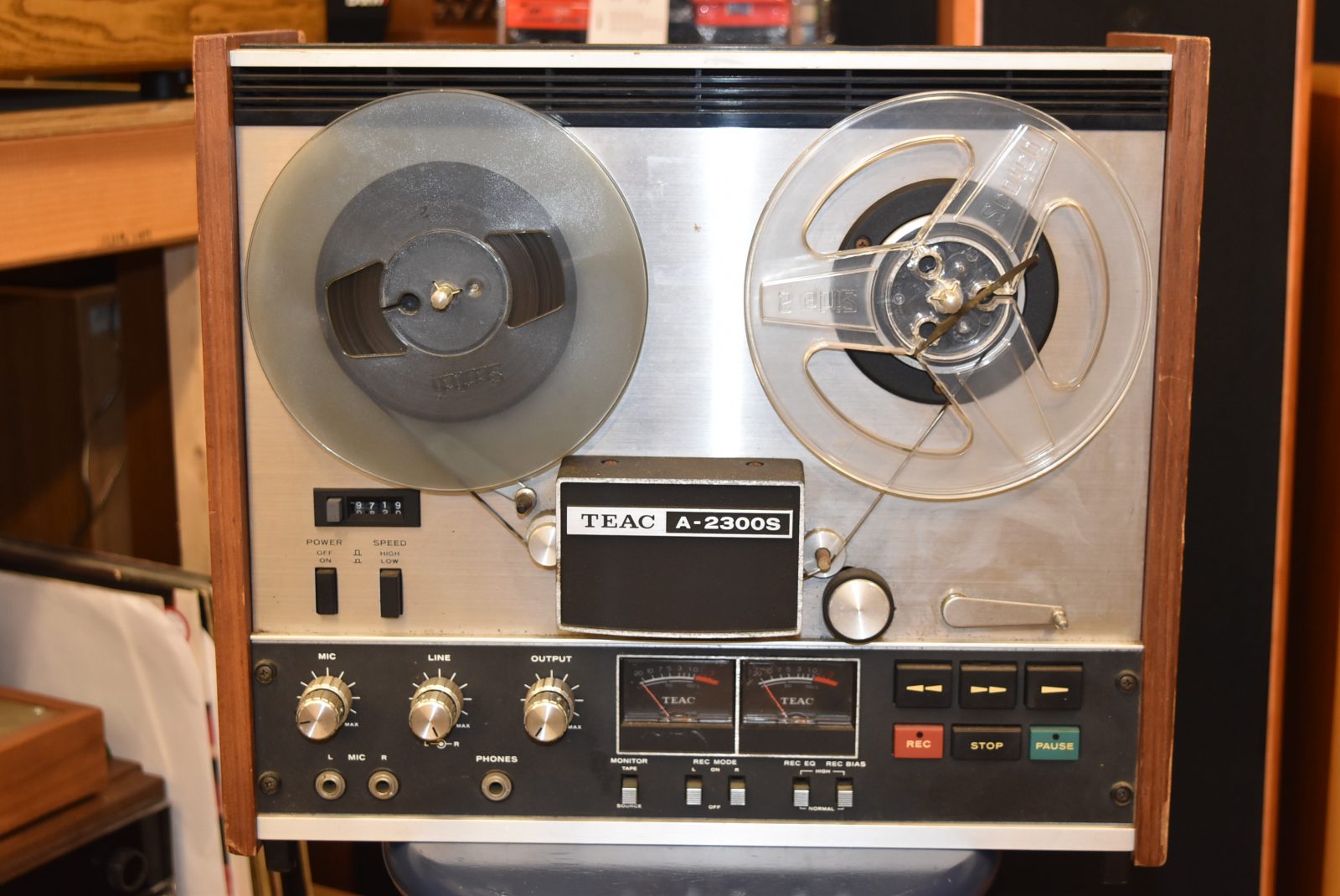

  1. I'm trying to clean moldy VHS tapes by hand which requires me to pinch the tape, VCRs and tape rewinders don't have enough powerful motors but reel to reel audio players do. I'm trying to find someone to 3D model me this VHS adapter for reel to reel players. Can someone direct me to the dimensions of VHS reel and audio reel?
    Or can I modify a VCR so that it doesn't stop rewinding even when tension is high?

  3. Like this reel to reel audio player laying flat instead of vertical. A VHS adapter can be mounted on top to rewind and fast forward a VHS reel. The audio reel is identical to a regular 8mm film reel. Can you design and print such an adapter? I'm willing to pay for it.

  7. Dont forget the spindle lock inside the VHS as well as the back tension.
    Brian.
