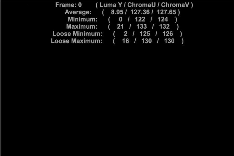

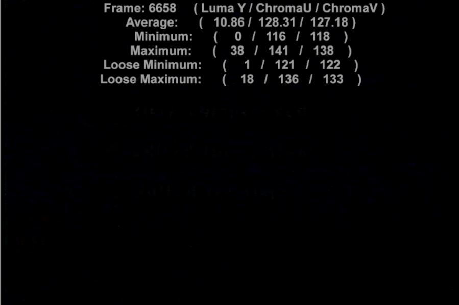

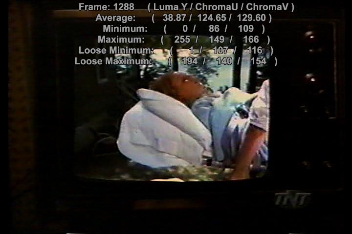

    [Attachment 51922 - Click to enlarge]
    That's what I thought as well but I still get this. I even went back to the original D2V file, loaded it into avisynth with DGDecode_mpeg2source("Part_1_1.d2v").convertToYV12 (interlaced=true, matrix="Rec601").ColorYUV(analyze=true) and I get the same thing:

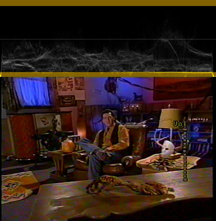

    [Attachment 51923 - Click to enlarge]
  4. It's not unusual for DVD sources to have values outside the Y=16-235 U/V=16-240 range, especially home recordings. Use Histogram for a better view of what's going on.
    The output of Mpeg2Source() should already be interlaced YV12 with rec.601 colors. The ConvertToYV12() shouldn't be needed. On the other hand it won't hurt because it shouldn't do anything.
    Maybe upload a small sample of your source (cut and demuxed with DgIndex). Include both bright and dark areas. And post your entire scripts so one can see where there might be problems. Note that sharpening filters can produce halos that extend outside the legal range. And automatic levels filters often produce illegal values too.

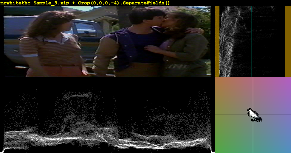

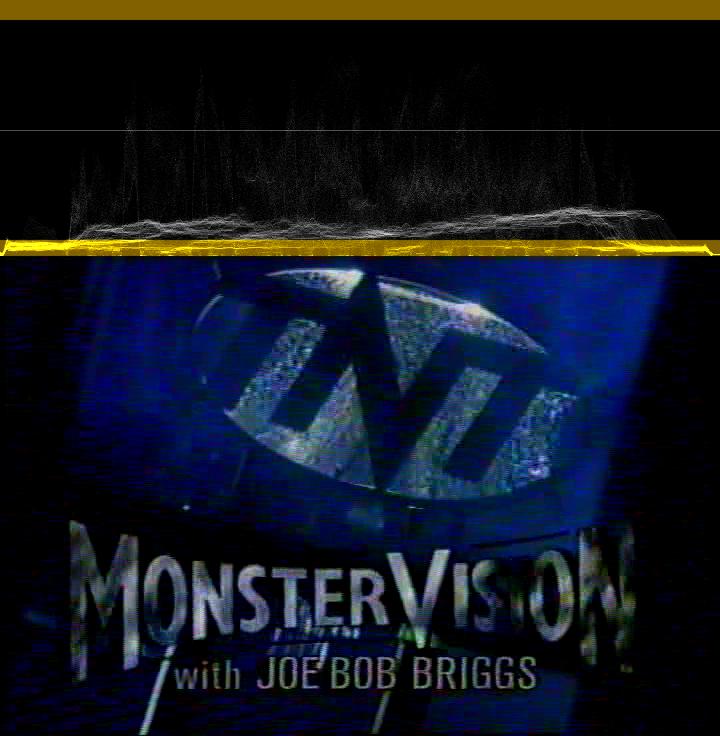

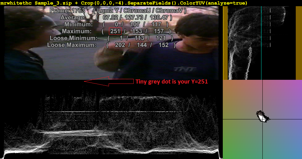

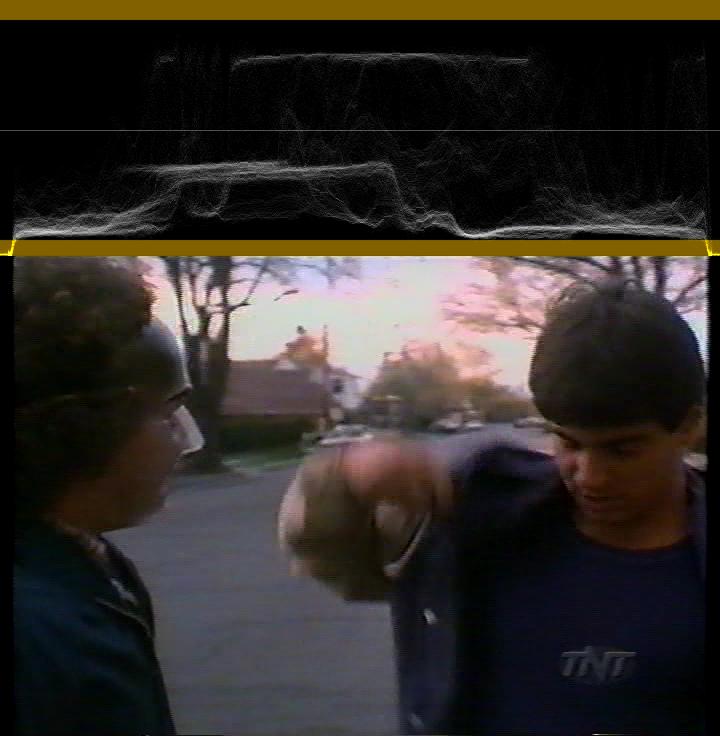

    Your source has lots of blacks below Y=16. It's worst in the early part of the clip where the titles are flickering:
    [Attachment 51926 - Click to enlarge]

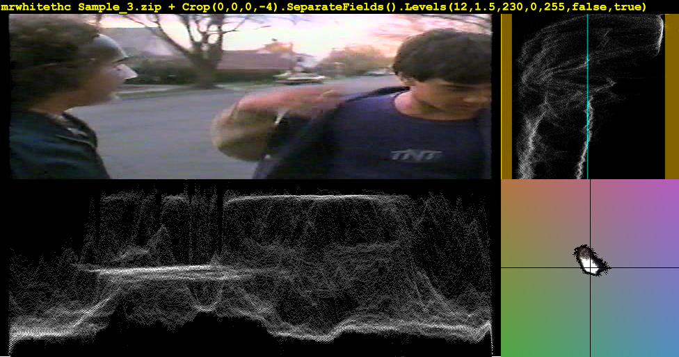

    There's still a little later in the clip:
    [Attachment 51927 - Click to enlarge]
    That's using TurnRight().Histogram().TurnLeft() on the source video, with no other processing. The brownish bars at the top and bottom of the histogram (really a waveform monitor) indicate the super whites (Y>235, none here) and super blacks (Y<16). Perfect limited range video would have nothing in those areas. But in the real world you often see a little there.
    The front and back porches (the black bars at the extreme left and right edges) at Y=0 may indicate a Japanese video tape was recorded on a North American recorder (the NTSC setup issue babygdav allueded to -- but pretty much everything else he said was wrong) . Regardless of the cause you should fix it. Almost all video devices use limited range YUV (Broadcast TV, Satellite TV, DVD, Blu-ray, Youtube, etc.).

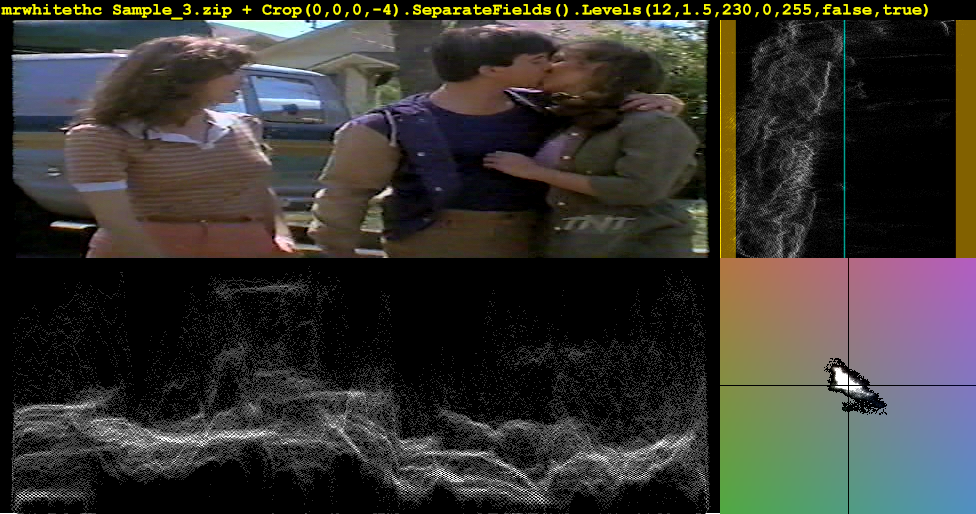

    How to address it here? There are only two shots here so it's hard to say for sure. But brights in the clip rarely exceed ~190. So adding 16 to Y and applying a small gain may be appropriate. Something like ColorYUV(gain_y=40, off_y=16) will get the black level up and keep the brightest brights from exceeding 235 (except for a few oversharpening halos). But I would look at a lot of other shots to verify those limits. For example, I wouldn't care the brights in the early part of the clip were blown out if the rest of the video looked good.
    The processing you listed indicates there were not YUV to RGB conversions. The ConvertToYV12 in your second script didn't do anything since the video was already YV12. That's why you continued to have super blacks.

    After scanning through I pulled out 2 clips where the Luma hits 255.
    Also looking at them I tried both
    ColorYUV(gain_y=20, off_y=8).Levels(0, 1, 255, 16, 235, coring=false,dither=true)
    which had the whites looking whiter but maybe a touch yellow and
    levels(0,1.09,255,16,235,coring=false)
    which seems to make the colors richer but seems to be reddish. I'm guessing it's all up to how it looks and there's no way to look at it based purely on numbers?
    You need to crop 2 lines off the bottom to eliminate head-switching noise. The white you're reading is a blip at the head-switch point. After doing that, the highest level I see is 251, which is just a spurious single pixel in two frames (probably block noise?).
    Here I cropped 4 lines off the bottom, to avoid Avisynth complaining about mod4 height.
    This is normal. Test signal generator function of DPS-470AV, Reference: SDI 10-bit FFVideoSource 8-bit images:

  19. Originally Posted by mrwhitethc View Post
    You need to consider what parts of the picture matter. Here's one frame where ColorYUV(analyze=true) shows max luma 255:

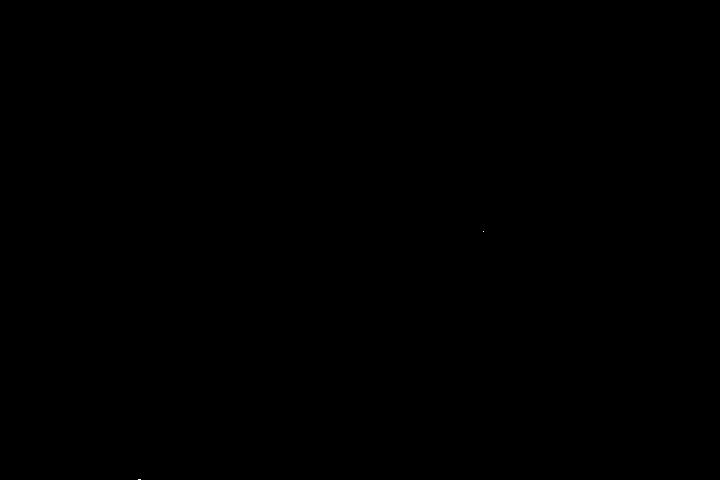

    [Attachment 51984 - Click to enlarge]
    Which pixels are at 255? Let's use mt_binarize(254, chroma="-128") to find out:
    [Attachment 51985 - Click to enlarge]
    Pixels with values 254 and below are black, pixels with value 255 and above (but nothing can be above 255) are white. The single white pixel is at the bottom of the frame, in the head switching noise. Ok, so which pixels are above 235 (the max legal Y value)?

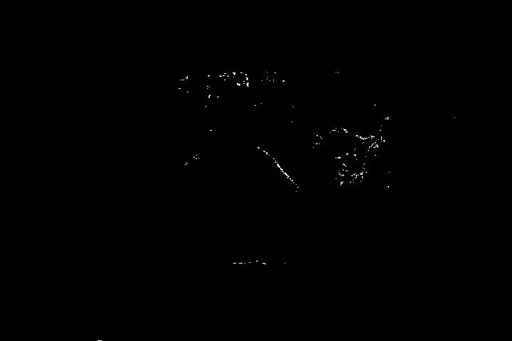

    [Attachment 51986 - Click to enlarge]
    Aside from the head switching noise at the bottom of the frame there's only one pixel above 235. Which pixels are above 200?
    [Attachment 51987 - Click to enlarge]
    But even those are all oversharpening halos. It's not until you get down to ~190 that you start seeing real picture details turn white.
    Let's look at another frame with Histogram() (which, again, is really a waveform monitor) using TurnRight().Histogram().TurnLeft():
    [Attachment 51988 - Click to enlarge]
    The white bar near the top of the waveform monitor is from the bright sky. The Y values there are around 200 plus or minus a few units. If you scrub through the video you'll see that the big bright areas are all around that level. So that's close to the actual white level -- which would normally be at 235, the bottom of the top brown bar. The black levels look about right, very close to the top of the bottom brown bar.
    Unless you plan to go through the video and adjust levels shot by shot you should look for a compromise setting that keeps the black and white levels close to the expected 16 and 235 values. This is where you have to use your own judgement. Auto levels adjustment filters don't work very well.
    Beyond that have have things like hue, saturation, white balance, gamma etc. And just because all Y values fall between 16 and 235, and all U and V values fall between 16 and 240 doesn't mean every pixel is legal. For example, at Y=16 (full black) there is only one legal value for U and V, 128. The same is true at Y=235 (full white). In fact, most YUV combinations between the stated min/max ranges are illegal. Here's a picture of the valid RGB values within the YUV (YCbCr) cube:

    Thank you everyone for the help, after looking at the raw numbers and waveforms from ColorYUV, Histogram and mt_binarize, a bunch of many test encodes and finally looking at the playback on a few TV's and my monitors at home I've come up with:
    ColorYUV(gain_y=2.5,off_y=5,off_u=2, off_v=-2).Levels(0,1.06,255,3,235,coring=false,dither=true)
    I left off convertToYV12(interlaced=false, matrix="Rec601") since all the footage is in YV12 to begin with and Info() confirms it as well even after QTGMC to lossless AVI.
    This seems to give me just the right amount of blacks and brightness to the image to make out what the hell is going on during the night scenes along with fix the small color shift. Thanks to everyone who took the time, I now have a new obsession when making my transfers to look over
