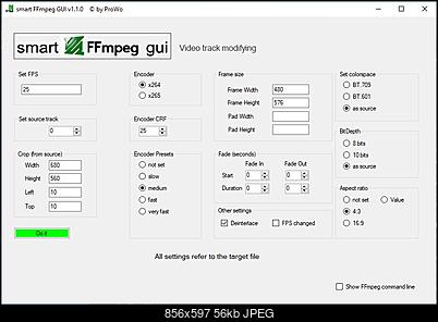

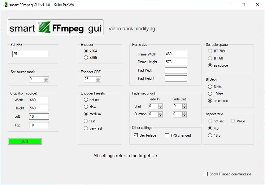

  26. The quality is poor. It makes no sense to aim for more than SVCD quality when re-encoding. You can do such a re-encoding the easy way with my smart FFMpeg gui. Parts were cropped and the video was deinterlaced. The target was PAL SVCD (480x576) with an AR of 4:3 (see picture), 56,9MB (without Audio).
    Try yourself.
    https://forum.videohelp.com/threads/395425-New-small-GUI-for-FFmpeg
