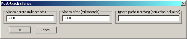

    Foobar2000 while converting, with the Affix Silence DSP in the conversion chain (screenshot below).

Name:	Affix Silence.jpg
