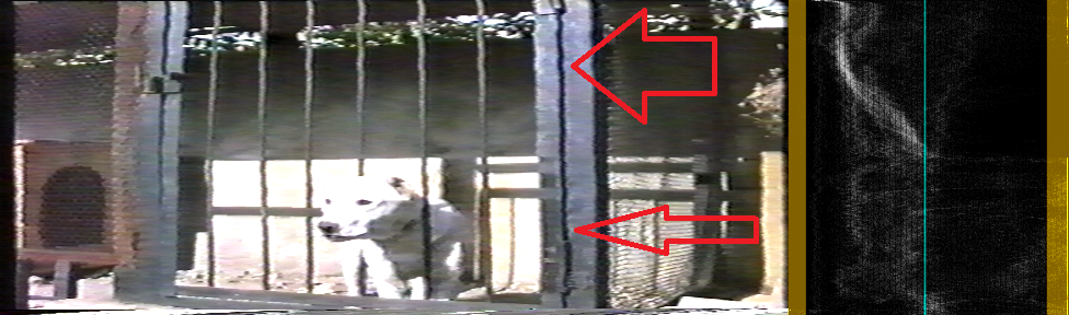

  8. Formerly 'vaporeon800' Brad's Avatar
    Apr 2001
    Vancouver, Canada
    Huffyuv 1.3.1?? That was released 19.5 years ago. The newest file in the ZIP archive has a modified date of 2000-06-16.
    At least upgrade to 2.1.1, if not a more modern codec like Ut Video Codec Suite or MagicYUV.
    You really need to add a line TBC passthrough to your setup, and also lower the Contrast using your card's Proc Amp controls.
    Duplicate frames (i.e. an Inserted frame going by VDub's Capture Mode nomenclature)
    50=49
    55=54
    60=59
    65=64
    70=69
    75=74
    80=79
    85=84
    etc...
    In fact, starting with frame 50, every 5th frame is a dupe. Source being 25fps, you're only able to capture 2 seconds before your capture is hosed.
    [Attachment 51921 - Click to enlarge]
    Red arrows indicate vertical lines that would be straight if you used line TBC. Histogram shows clipping (right edge in the brown part).
