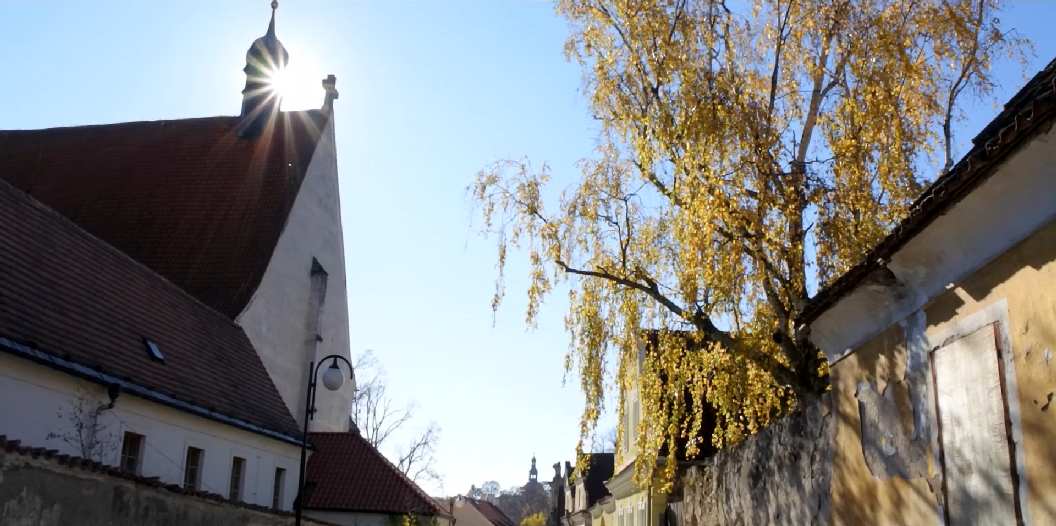

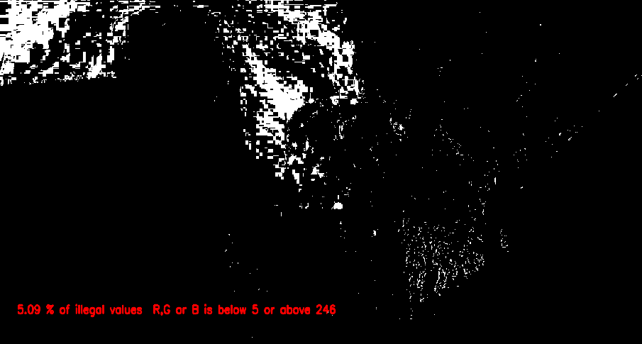

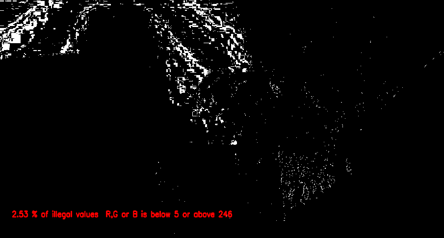

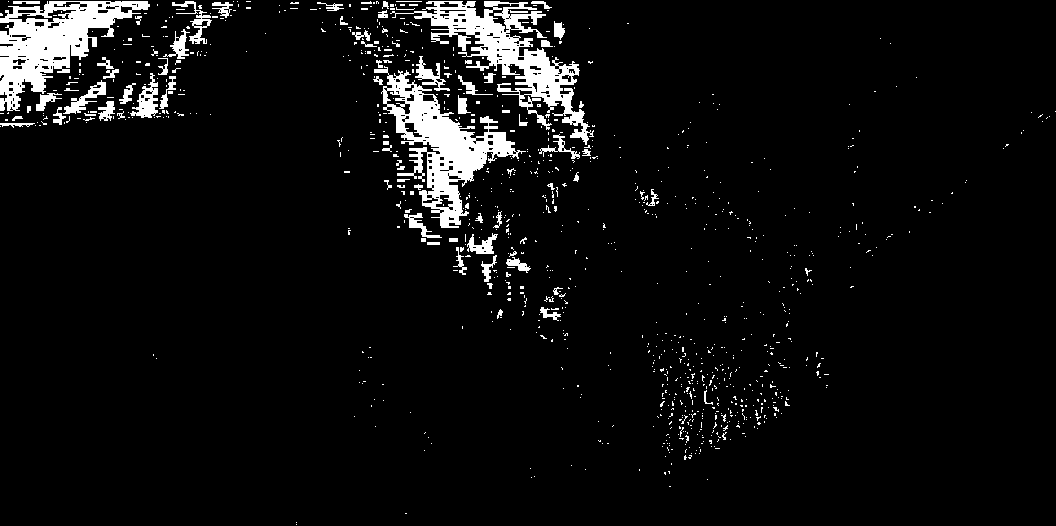

  14. I did a vapoursynth test, tried to follow all that was said to clip those RGB values in right way, made some black&white masks to see results. Basically if there is lots of illegal values in original YUV, like blown up sky, it still will show at the end, some highs or R, G or B would still come out from middle of range. Even if YUV original is nice, it will still end up with illegal values, like edges, where some R, G or B alone would jump out.
    import vapoursynth as vs
    from vapoursynth import core
    import numpy as np
    import cv2
    clip = core.lsmas.LibavSMASHSource(r'G:/video.mp4')
    MIN = 5
    MAX = 246
    def restrict_rgb_frame(n,f):
        img = np.dstack([np.array(f.get_read_array(i), copy=False) for i in range(3)])
        img = np.clip(img, a_min = MIN, a_max = MAX)
        vs_frame = f.copy()
        [np.copyto(np.asarray(vs_frame.get_write_array(i)), img[:, :, i]) for i in range(3)]
        return vs_frame
    def get_mask_illegal_values(n,f):
        mask = cv2.inRange(img, (MIN, MIN, MIN), (MAX, MAX, MAX))
        mask = cv2.bitwise_not(mask) #mask is one plane only, grayscale
        vs_frame = f.copy()
        [np.copyto(np.asarray(vs_frame.get_write_array(i)), mask[:, :]) for i in range(3)]
        return vs_frame
    '''original YUV to RGB, using YUV as full range to get studio RGB'''
    rgb_clip = core.resize.Point(clip, matrix_in_s = '709', format = vs.RGB24, range_in_s = 'full')
    '''making a black&white mask to show illegal values before limiter'''
    mask = core.std.ModifyFrame(rgb_clip, rgb_clip, get_mask_illegal_values)
    '''limiting RGB, there is no illegal values now'''
    clipped_rgb = core.std.ModifyFrame(rgb_clip, rgb_clip, restrict_rgb_frame)
    '''making a mask to show illegal values (should be all black, no illegal values now)'''
    mask_clipped = core.std.ModifyFrame(clipped_rgb, clipped_rgb, get_mask_illegal_values)
    '''RGB back to final YUV for delivery '''
    clipped_yuv  = core.resize.Point(clipped_rgb, matrix_s='709', format = vs.YUV420P8, range_s = 'full')
    '''changing that YUV back to RGB to mock studio monitor'''
    rgb_clip_monitor    = core.resize.Point(clipped_yuv, matrix_in_s = '709', format = vs.RGB24, range_in_s = 'full')
    '''making a black&white mask to show illegal values'''
    mask_monitor = core.std.ModifyFrame(rgb_clip_monitor, rgb_clip_monitor, get_mask_illegal_values)
    clip.set_output(0)
    rgb_clip.set_output(1)
    clipped_rgb.set_output(2)
    mask.set_output(3)
    clipped_yuv.set_output(4)
    rgb_clip_monitor.set_output(5)
    mask_monitor.set_output(6)

  15. Nice _Al_ ,
    I wonder if there is a way to estimate % or # pixels affected in a frame? Maybe binarize the results (0 or 1), then calculate something that against 100% black ? Or is there some python function that can already do this ?
    It's nice to visualize the areas affected too , so you can maybe do something about it. e.g. maybe clip to more strict range, and see how that affects it, or maybe apply filter like GeneralConvolution in avs or Convolution in vpy etc... decrease saturation etc... and you can use the same masks to apply the filter
    A trip down memory lane - recall the U,V ranges for valid RGB and the animated GIF . So many values, and in the middle of the range are illegal
    https://forum.doom9.org/showthread.php?t=154731
    If you "cull" all the bad values by converting to RGB (and even clipping to stricter range) , many illegal values come back as soon as you subsample.

  19. Illegal qualifies any R, G or B value that is outside of range (5,246) for that particular RGB video. That would show white pixel. But that is what I did, it could be different, per channel etc.
    Here is showing how many percent of those white pixels is. Function that makes those masks is just changed, plus one global variable that counts beforehand, how many pixels video actually has.
    NUM_PIXELS = clip.width * clip.height
        ####this would make all white grayscale to test it, it would show 100%
        ##mask = np.zeros((clip.height, clip.width), np.uint8)
        ##mask[:] = (255)
        ####all black grayscale to test it would show 0 %
        white_pixel_total = np.sum(mask == 255)
        percent = round(white_pixel_total/NUM_PIXELS*100, 2)
        mask = np.dstack([mask,mask,mask])
        text = f'{percent} % of illegal values  R,G or B is below {MIN} or above {MAX}'
        mask = cv2.putText(mask, text, (50, clip.height-80), cv2.FONT_HERSHEY_SIMPLEX , 1, (255,0,0), 3, cv2.LINE_AA)
        vs_frame = f.copy()
        [np.copyto(np.asarray(vs_frame.get_write_array(i)), mask[:, :, i]) for i in range(3)]
        return vs_frame
    video is interlaced, I did not deinterlace it so it is weird a bit, those lines show, but just an exmple,,
    most parts in video are far below 0.1 percent
