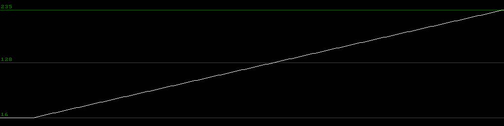

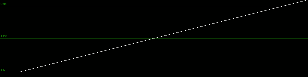

    A lutyuv expression for the y channel 16-255 to 16-235 by range compression (not clipping) to "squish" the 235-255 "superbrights" into legal range would be
    lutyuv="'y=(val-16)/(255-16)*(235-16)+16'"
    Values below Y=16 are not touched at all if they exist. Also this does not touch the Cb,Cr channels, you didn't mention how you wanted to adjust CbCr
    Before/after Y waveform
