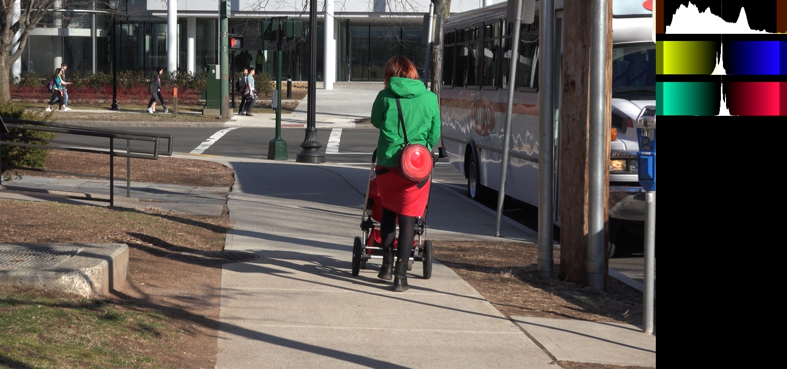

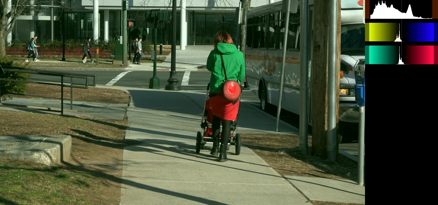

    I believe the Y scaling is correct , but there are issues with CbCr scaling, turning image green. There needs to be some additional logic to not shift color balance
    eg.
    before geq
    [Attachment 58629 - Click to enlarge]
    after geq
    [Attachment 58630 - Click to enlarge]
  14. The geq parameters assume grey is half way between 16 and 255, 135, not the usual 128 (half way between 16 and 240). So with an image that already has grey at 128 those greys are moved down to 121. That is the cause of the color shift in the second image. I don't know if that is right or wrong (I suspect the latter) for intended purpose.
    If you want to compress the chroma range but keep grey at 128 use:
    -vf "geq=lum='(p(X,Y)-16)/(255-16)*(235-16)+16':cb='(p(X,Y)-128)/(255-16)*(240-16)+128"

  26. Originally Posted by chris319 View Post
    Using "brightness" and "contrast" does introduce some non-trivial color drift, so that's out.
    You can clip to a luminance range of 5 - 246 and be R 103 compliant. You will lose a little detail in the highlights and very lowlights. Enough to worry about?
    ffmpeg -y -i "Bars.mp4"  -c:v libx264  -vf format=rgb24,"lutrgb=r='clip(val,17,236)':g='clip(val,17,236)':b='clip(val,17,236)'",scale=w=1280:h=720:flags=spline:out_color_matrix=bt709:out_range=full,format=yuv420p  -color_primaries bt709 -color_trc bt709 -colorspace bt709 -r 59.94  -c:a copy  clipped.mov
    Yes - contrast/color changes are too large for valid input colors and greyscale. Also you cannot tag a file "full range" for "legal" submissions
    This was already discussed a few pages back, you should go back and refresh.
    IIRC, one of the older attempts with the train clip was ok, if the input was roughly correct to begin with (there is no way you can get ffmpeg or any program - to auto grade first)
    If you recall, R103 5-246 in the R,G,B check portion refers to studio range RGB (RGB 16-235 reference black to white), not computer range RGB (RGB 0-255 reference black to white), so if you were clipping you would normally use full range equations for YCbCr<=>RGB in both directions.
    And you will almost always get some illegal values, unless you stay in RGB... but submission and end distribution formats are almost always YCbCr. The YCbCr conversion and especially the chroma supsampling step will create new illegal values. The question is what %, and is it under the allowable threshold (~1% usually) . _Al_ posted a vapoursynth script and you can see if you change min/max clip channel levels, what % is illegal pixels. It works well and corresponds to professional analyzers

  28. you cannot tag a file "full range" for "legal" submissions
    Substantiation, please? Please cite any authoritative documentation that mandates limited-range flagging for submission.
    The program I wrote to do this QC checking already gives the percentage of out-of-gamut pixels. For example, the window signal has 0.01% out-of-gamut pixels after processing and would most likely pass QC.
    Here is the spec. Please cite any reference to file flagging.
    https://tech.ebu.ch/docs/r/r103.pdf
  29. I modified my script to have ffmpeg output limited-range files and got color shifts, much the same as when using "brightness" and "contrast".
    Specifying a full-range file eliminates the color shifts.
