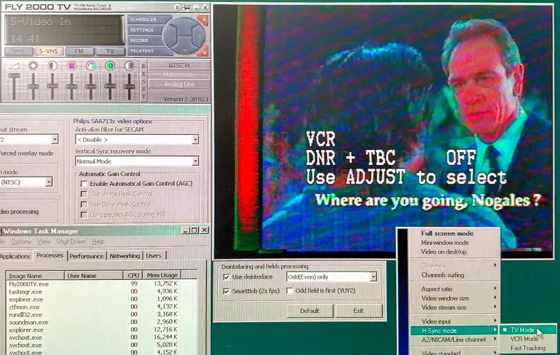

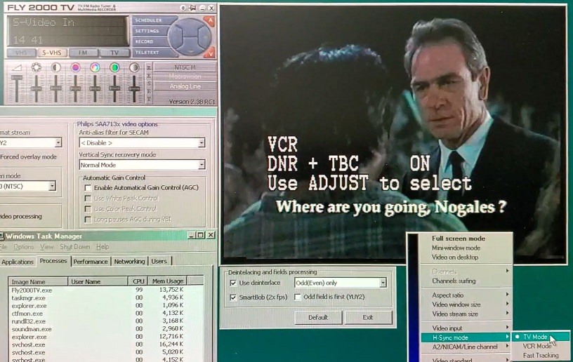

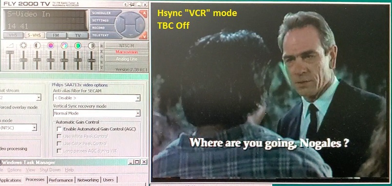

    Here, I made a video just for you. Note: there's no reason to listen to the audio unless you want to clear mouse clicks, VCR noises, and my neighbor's engine in the parking lot.
    https://youtu.be/VVWTt873h_U
    Tape-based sources are inherently unstable. I demonstrate this fact by using a special setting of an old capture card. At the start of the video, the card is set to expect a signal from a source like analog TV, digital cable box, DVD player, etc. Your Portta Composite to HDMI converter is likely always functioning in a mode like this, without any design consideration for VCR input.
    1. SAA7133 capture card is set to "TV" HSync mode.
    2. VHS tape is played on Mitsubishi HS-HD2000U with TBC off.
    3. Fast forward. Play.
    4. TBC on. Rewind. Play.
    5. TBC off again. Fast forward. Play. Short FF. Rewind. Play.
    6. Set "VCR" Hsync mode.
    7. Set "Fast Tracking" Hsync mode.
    8. Set "TV" Hsync mode again.
    [Attachment 51913 - Click to enlarge]
    [Attachment 51914 - Click to enlarge]
    [Attachment 51916 - Click to enlarge]
    Try fast forward & rewind. The VCR generates a false sync signal that your converter may read corrrectly, as this capture card does in "TV" mode.
    Last edited by Brad; 8th Feb 2020 at 18:30. Reason: Suggestion for a troubleshooting step
