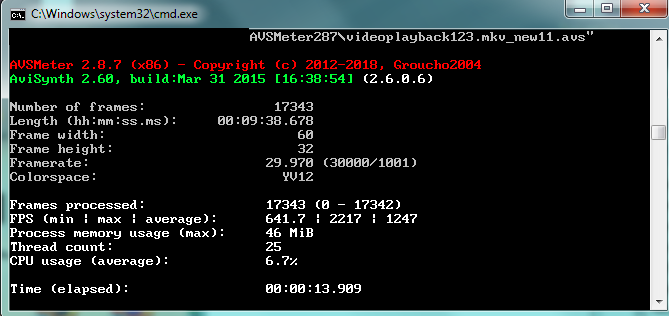

    You might get different results by just decoding raw YUV or RGB, but with low complexity H.264 I didn't get anything close to your estimate.
    [Attachment 51900 - Click to enlarge]
    I encoded my own 60x32 H.264 video with a CRF of 23, which created a file size of 1MB even though the file is 10 minutes long. No audio. No CABAC. Very fast Preset. I averaged a decode speed 1247 using directshow and lav filters to pipe my AMD GPU into decoding it. This same GPU can decode 1080p 12Mbit at around 300fps.
