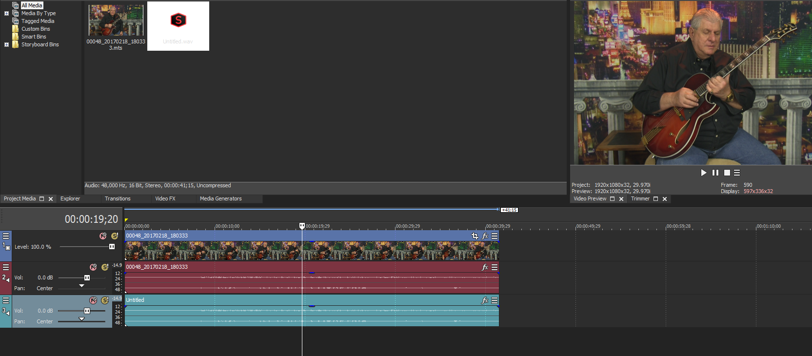

  16. aBigMeanie aedipuss's Avatar
    Oct 2005
    666th portal
    i imported it into vegas pro 16. converted to 16bit 48khz wav, brought the wav into vegas and it matches up exactly.
    [Attachment 52026 - Click to enlarge]
    Jan 2004
    Thanks for the screenshot @aedipuss.
    The issue seems to have something to do with later versions and builds of Vegas
    @manono, yes I know how to do it, but I wanted a 3rd party conversion as I'm trying to isolate a problem.
