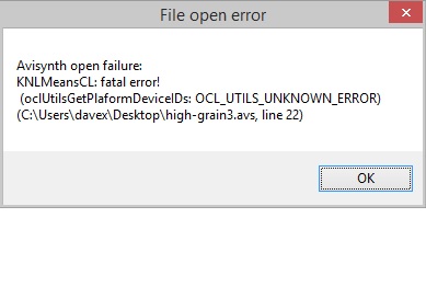

    I attempted to try KNLMeansCL myself, but got code 126 when it attempted to load (loadplugin in Avisynth+ r2772.)
    Avsmeter said opencl.dll was missing. Found a copy of this dll in the latest Xmedia Recode (version 1.2.11.0 dated 11/2013),
    copied it into \Windows\Syswow64 but then I got this error.
    Could this be hardware related? Using motherboard video only.
    Thanks for any info

    Originally Posted by themaster1 View Post
    alright, try knlmeans at least:
    avisource
    assumetff()
    separatefields()
    Merge(Merge(last,KNLMeansCL(d=2,a=5,s=2,h=20),0.7) ,KNLMeansCL(d=1,a=6,s=4,h=10))
    weave()
    Thanks for any info

    You will need a gpu with opencl compability and drivers
    Mar 2008
    Thanks for confirming this.
