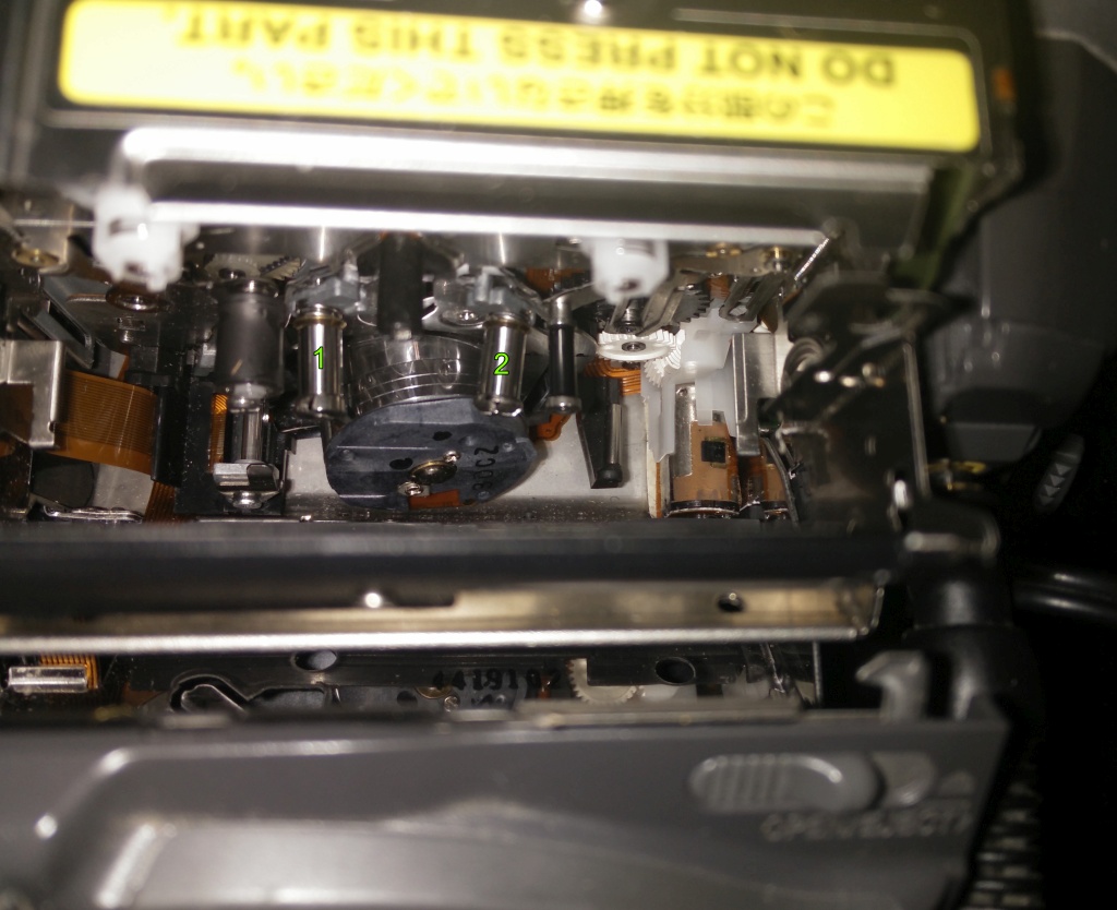

    Interesting because of something which I've just spent the last hour on. I had been adjusting what I think are called spindles. See pic,I labeled them 1 and 2. There were big artifacts and audio dropouts before. I got the audio much better and less artifacts and captured it with WinDV. The entire tape, except for a few minutes, was one filming session of a music performance. There was one little bit stuck in after the performance ended (but the camera kept running). I must have just wanted to take a little video a few months later and stuck it in. When I looked at the capture that little bit had artifact free video but the music playing in the background was way too fast. WinDV is set to break the video into 4 min segments. When it went to the next segment the music was playing in regular time and the video was perfect. After the inserted bit ended and it went back to original video, where background music was being played, the music seemed too slow. All that confused me so I went back and captured it again to see why it sped up. This time the video had lots of artifacts and the music was too fast all through. Because of where I started the capture it was all on one 4 minute segment. After the inserted bit ended and it went back to the original video the music there was going normal speed. So in this case, two different captures and two different results.?

  8. https://www.videoonerepair.com/canon-xl-h1-mechanical-problems-playback-problems/
    That reminded me of how older camcorders had adjustment and parts issues.
    Like http://www.bealecorner.com/trv900/trouble/audiodrop.html
    This obscure one.
    Your playing around with the spindles suggest
    1. The camcorder needs to be adjusted to playback the tapes, takes that were recorded off-spec, thus unplayable on normally working camcorders.
    2. The camcorder is off-spec and needs to be readjusted back to normal specs to play the on-spec tapes.
    (Of course, all tapes, even pro tapes, wear out and drop out, so try to keep the playbacks too a minimum per tape.)
    ALL video/audio sync in dv captures are lost between takes (when the camcorder stops recording, then begins again). You will need to manually line up the tape to the beginning of a new segment, start a new capture - that should give you a capture with sync'd audio and video.
  9. https://www.manualslib.com/download/1681414/Canon-Mvx200-E.html
    fyi: most of the adjustments are made through the service manual using a dedicated service remote control and equipment.

    Yikes, that's sophisticated. Thanks for the link on the better manual than I had before. The thing that helped me the most was that Youtube video. https://www.youtube.com/watch?v=B_5LP5NkoVA&t=312s
    I could see the artifacts similar to mine and I could see what he was adjusting and how it changed it. That's more my technical level!
