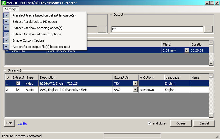

    The HD Streams Extractor can only convert to AAC using Nero.

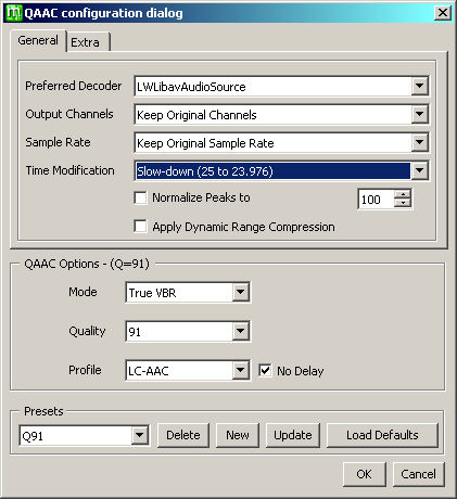

    You can do it with the standard audio encoder configuration and you should be able to load video files directly into the audio section. If you do, I think MeGUI ignores any audio delay specified in the container, so it'd probably pay to check for delays yourself.
    Don't correct the pitch unless the source was originally PAL, and by that I mean it was filmed at 25fps.
    When film audio is sped up for PAL it's almost never pitch corrected (concerts can be an exception to keep the music pitch unchanged), so not pitch correcting when slowing it down again will give you the original pitch.
