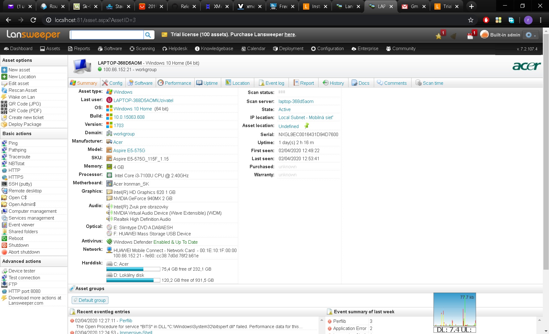

Did you install Nvidia graphic drivers made by Nvidia (not just from the Windows Update)? Does HWiNFO report both GPUs? (It has a small combobox in its summary window to switch)
i allready tried several drivers/packages downloaded from nvidia directly, each about 550mb. currently have the latest...
hwinfo recognize both cards, attached screenshot
[Attachment 51844 - Click to enlarge]
