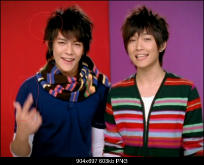

    there're still many combs after deinterlace,I have tried many methods in my poor skill...
    It makes me mad...Masters,Please help me!Thanks!

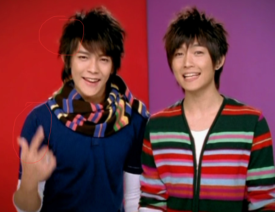

  2. I don't see any comb artifacts in your sample image. I think you just have normal YV12 chroma subsampling issues. But...
    ConvertToYV12() should be ConvertToYV12(interlaced=true) because the video is interlaced at that point. But it shouldn't make any difference here because the output of Mpeg2Source() should already be YV12 -- so the filter won't do anything. Also, it makes no sense to TDecimate() before deinterlacing or IVTC'ing.
    I recommend you use Dgindex to demux a short sample of your source and upload the resulting M2V file.

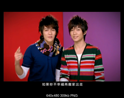

    the line is unusual which looks like interlaced.what cause it?

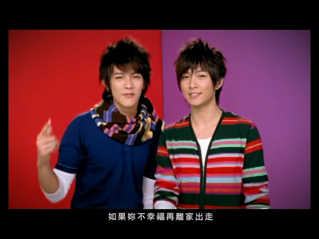

  4. The problems in your image are from poor deinterlacing and chroma subsampling.
    The video is a mix of telecined film, badly deinterlaced telecined film, and some badly deinterlaced 30i video. To get the best results you would have to filter the different sections individually. But here's a compromise script that works pretty well for most of the video.
    Mpeg2Source("___.demuxed.d2v", CPU2="ooooxx", Info=3)
    TFM(d2v="___.demuxed.d2v", field=0, cthresh=4)
    TDecimate()
    QTGMC(InputType=2)
    Some of the animated sequences get a little mess up by this though (for example, the shoe laces about 14 seconds into the clip).
