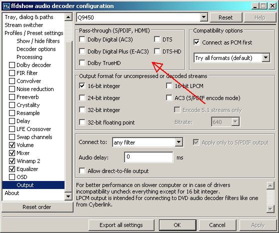

    If you want to try the ffdshow method, here's some screenshots and a link to the RockSteady plugin. You don't need to install WinAmp. Just put the plugin somewhere and tell ffdshow's audio decoder where to find it, which you can only change by opening the audio decoder configuration via it's shortcut while no video is playing. You can drag the ffdshow audio filters with your mouse to change their order, as the Mixer filter needs to be before the Winamp filter.
    There's a screenshot of how I've configured RockSteady, whether you want to try it with Potplayer or via ffdshow. It works by increasing the volume of the quiet parts rather than decreasing the louder parts, so don't be alarmed if the volume gets louder, just turn the TV's volume down.

    I don't have Potplayer installed, but check it's not doing some sort of audio pass-through if it's a digital connection. It possibly has similar options for that as ffdshow. That's the only explanation I can think of if you're using a digital connection. For ffdshow, it looks like this:
