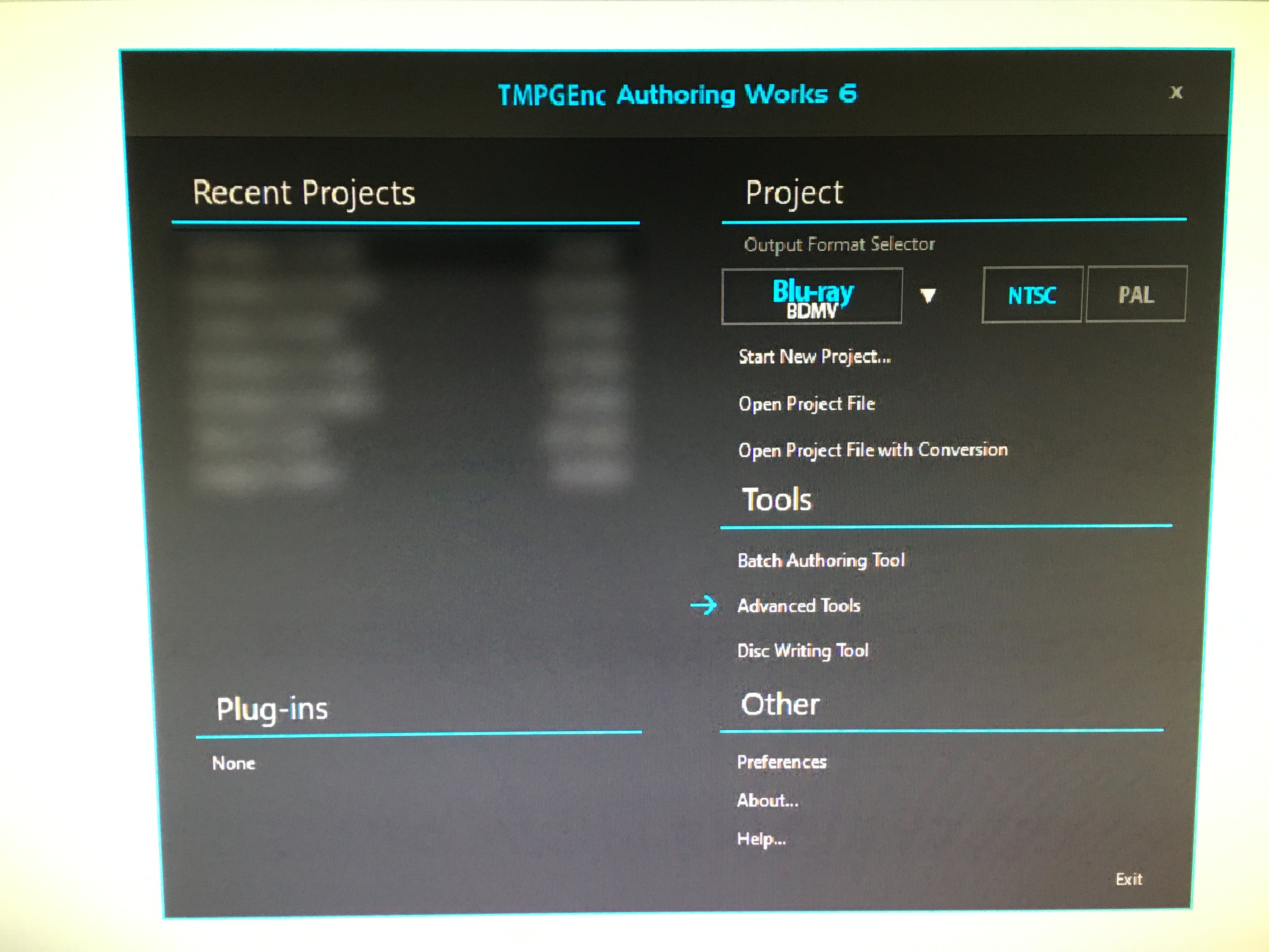

Importing psd or other files for custom buttons. I haven’t used this myself but see my picture below.
[Attachment 57065 - Click to enlarge]
When you first start the program, before choosing a new project or opening a saved project, click on the “advanced tools” under the tool section. Doing this opens a new option screen and one of the first options is “create navigation button items”. Click that and then click “add file” on the bottom left of the new page it opens.
