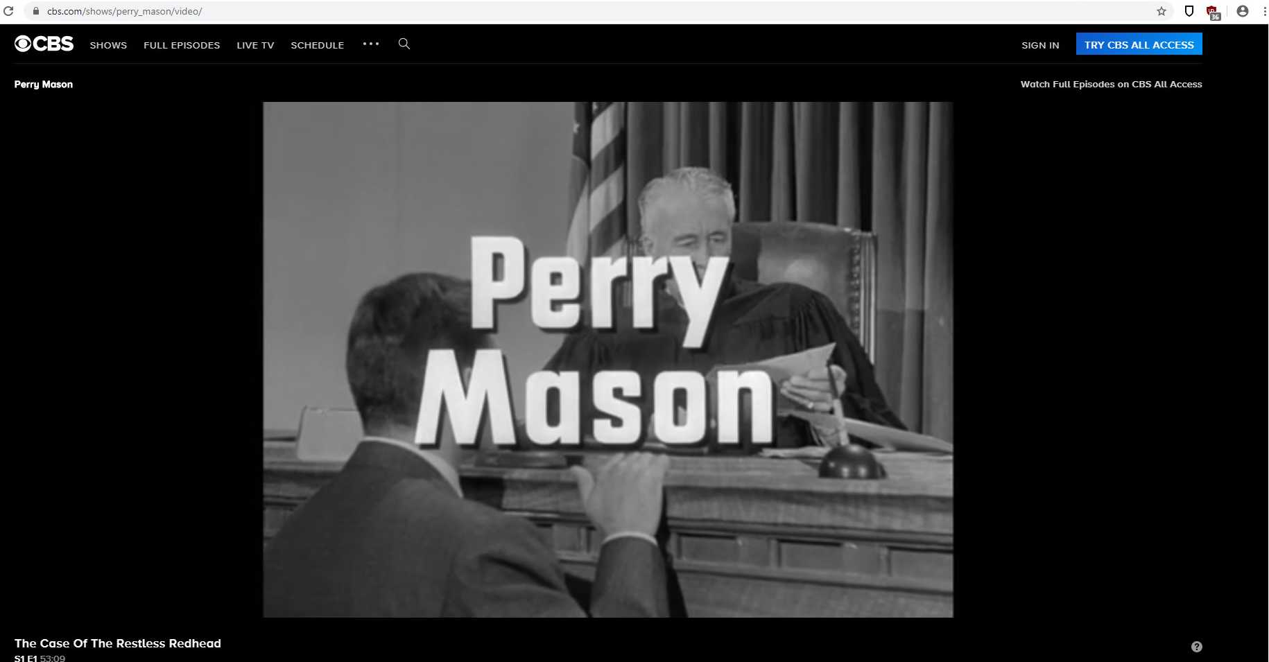

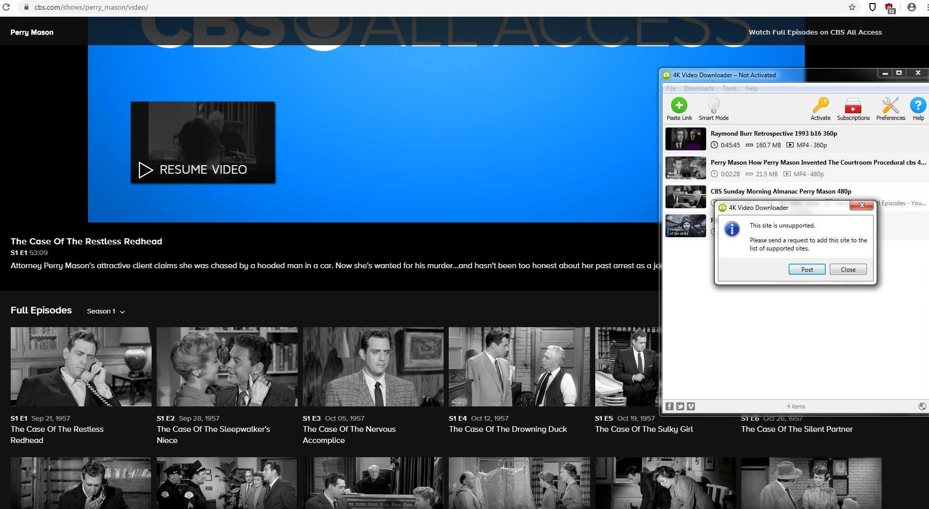

  1. My favorite port dl does not work for https://www.cbs.com/shows/perry_mason/video/ (attach)
    Hope someone has suggestions for a portable one that will!

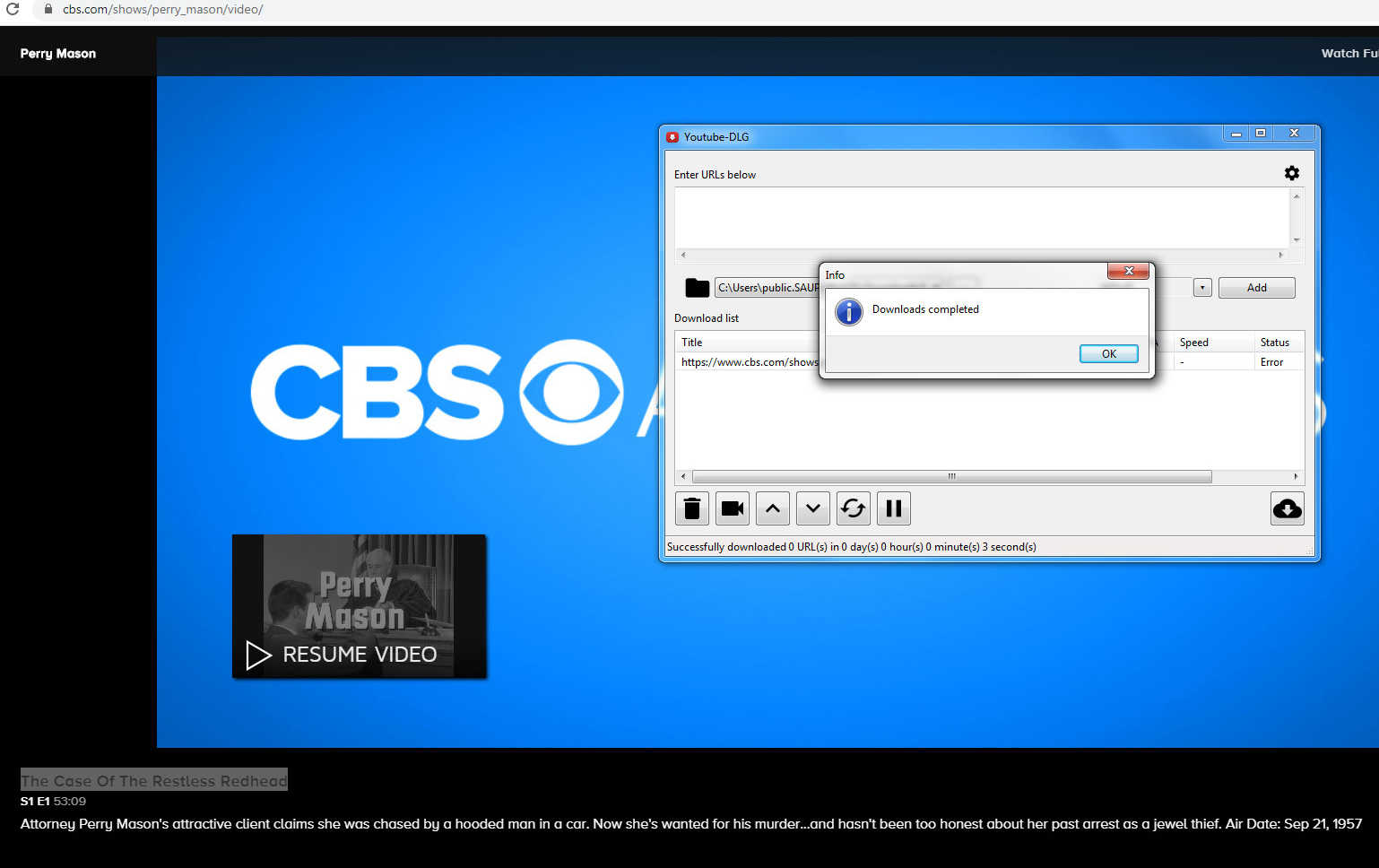

  2. LZAA took your advice and dl youtube-dl-gui-0.4-win-portable and tried
    1st used default file got Error
    2nd changed to MP4 file still Error
    Hope you can tell me what I am doing wrong!

    Add can watch OK (1 to 3 Attach)
    OK with Chrome (2 & 3 Attach)

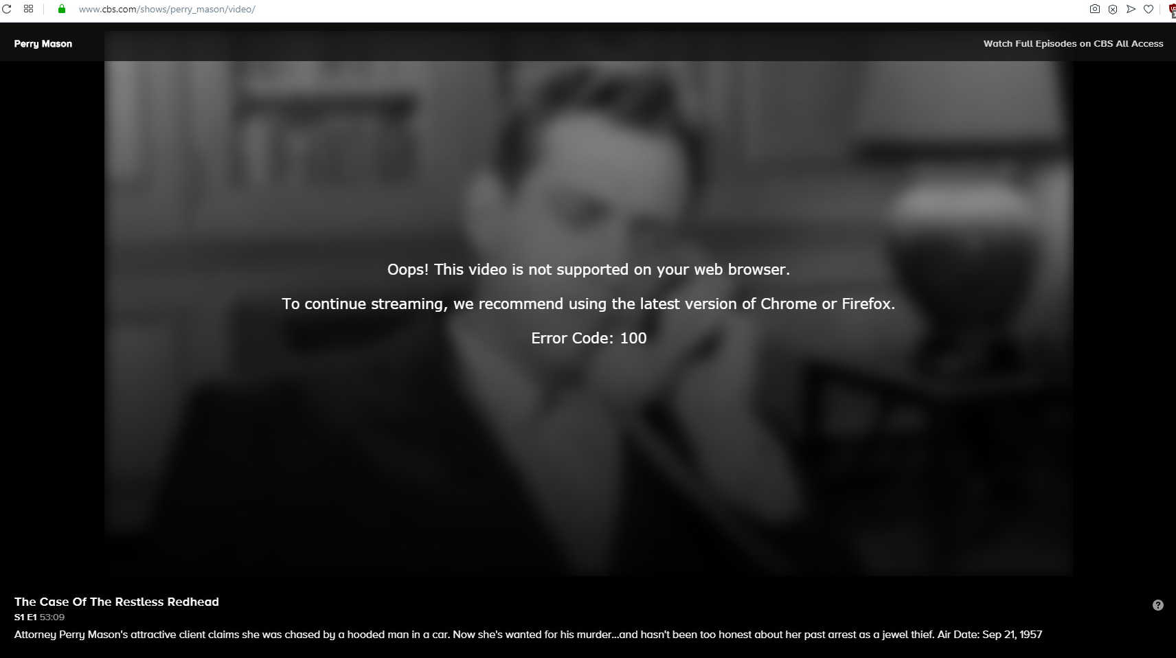

    Problem with Opera (1 Attach)
Name:	1 Opera Error Message ed.jpg

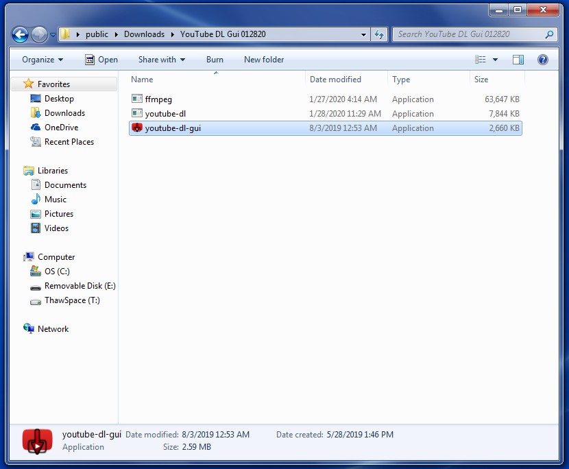

  13. all file on same directory
  14. Put youtube-dl.exe and ffmpeg.exe in the same folder as youtube-dl-gui.exe.
  15. jagabo "Put youtube-dl.exe and ffmpeg.exe in the same folder as youtube-dl-gui.exe" Did as instructed (1 attach)

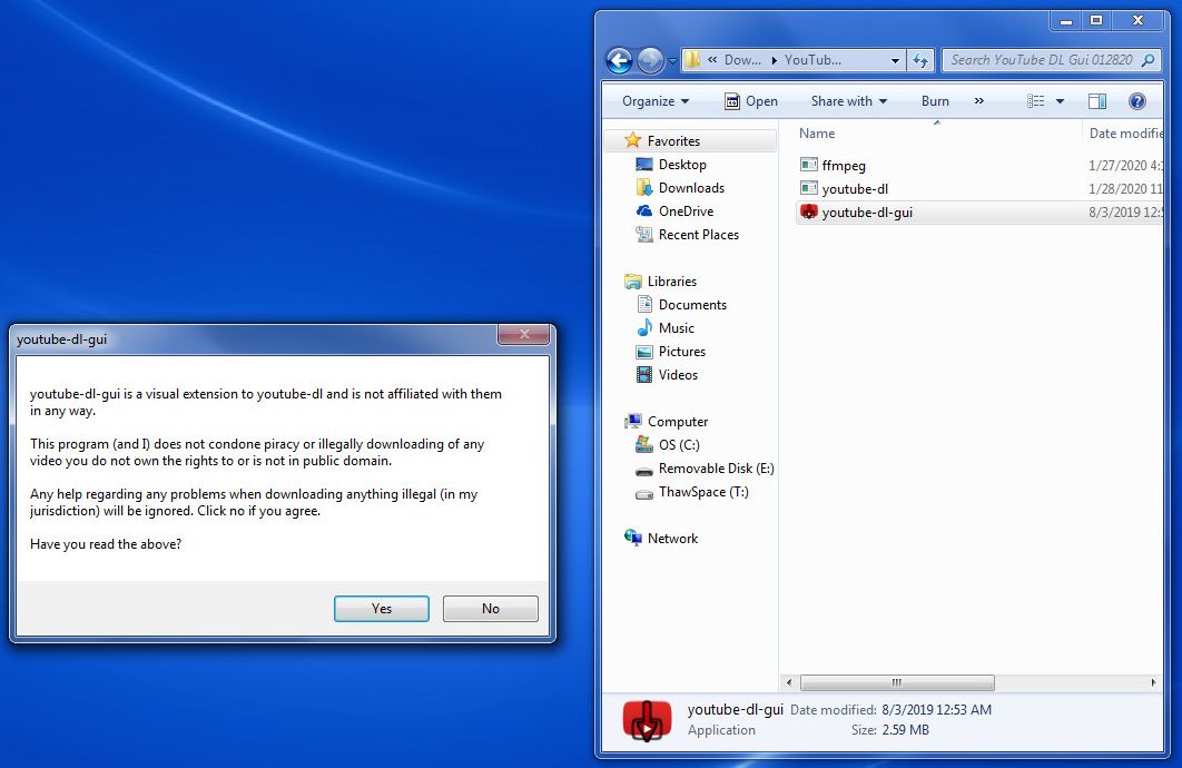

  16. jagabo When click on youtube-dl-gui get message (attach) If click Yes the message goes away and nothing happens?
    Is there a Recent Portable youtube-dl-gui with all needed files that I can download?
