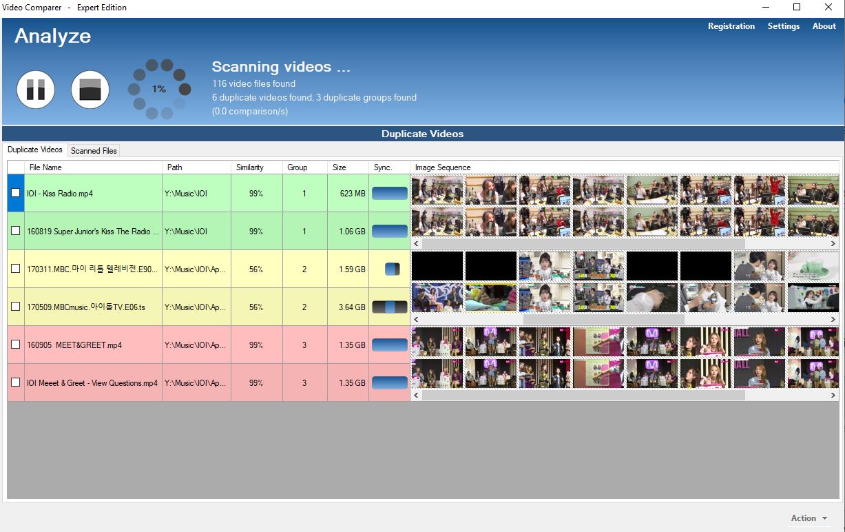

Re-reading your post, I thought you meant no video comparer does what you need, but I see your claim is the actual program doesn't fit the need. It absolutely does! Have you tried it? Despite the description on the software page, it compares the content of the files themselves as shown in his screenshot of it running right now:
[Attachment 51616 - Click to enlarge]
I haven't checked the folder these files are on and started it a couple of hours ago, and you can see how slow it is in thorough mode. The folder is 1.66TB, 1113 files, 37 folders. At the rate it's going, it may take a couple of days to complete, which I why I don't run it too often. -

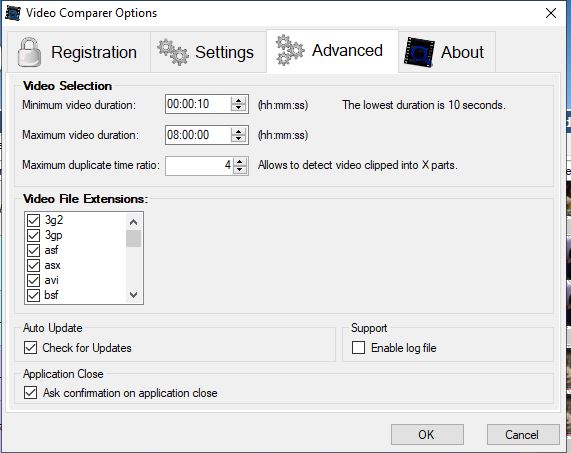

Seems you've set the min and max duration wrong or the default setting is max 10 seconds. I've set my max to 8 hours and it definitely does scan the whole video, though not as thoroughly as the Full mode below. Also, was wrong about the minimum duplicate time detection. It's not 10 seconds, got confused with the duration page.

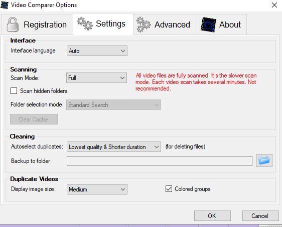

Set your Scanning to Full. I tried at once, but it's really, really slow, compared to just slow in the Thorough mode that I use.

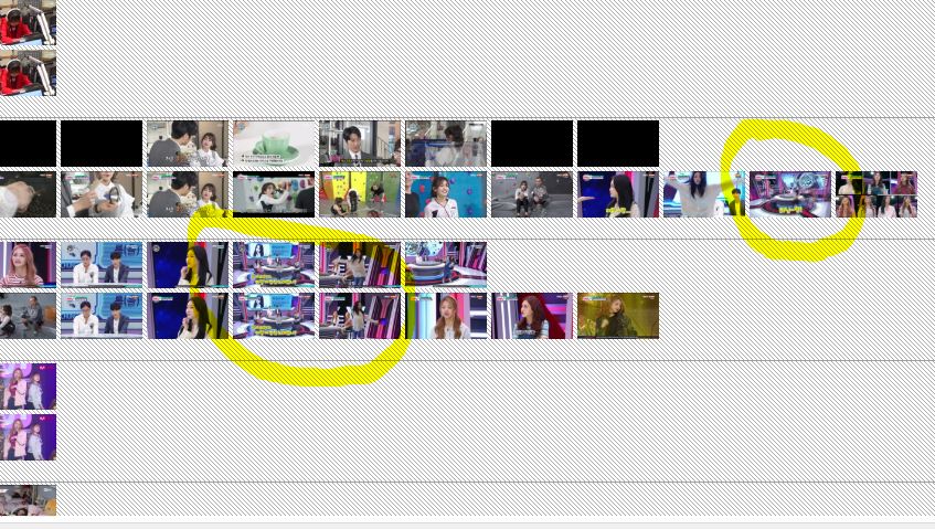

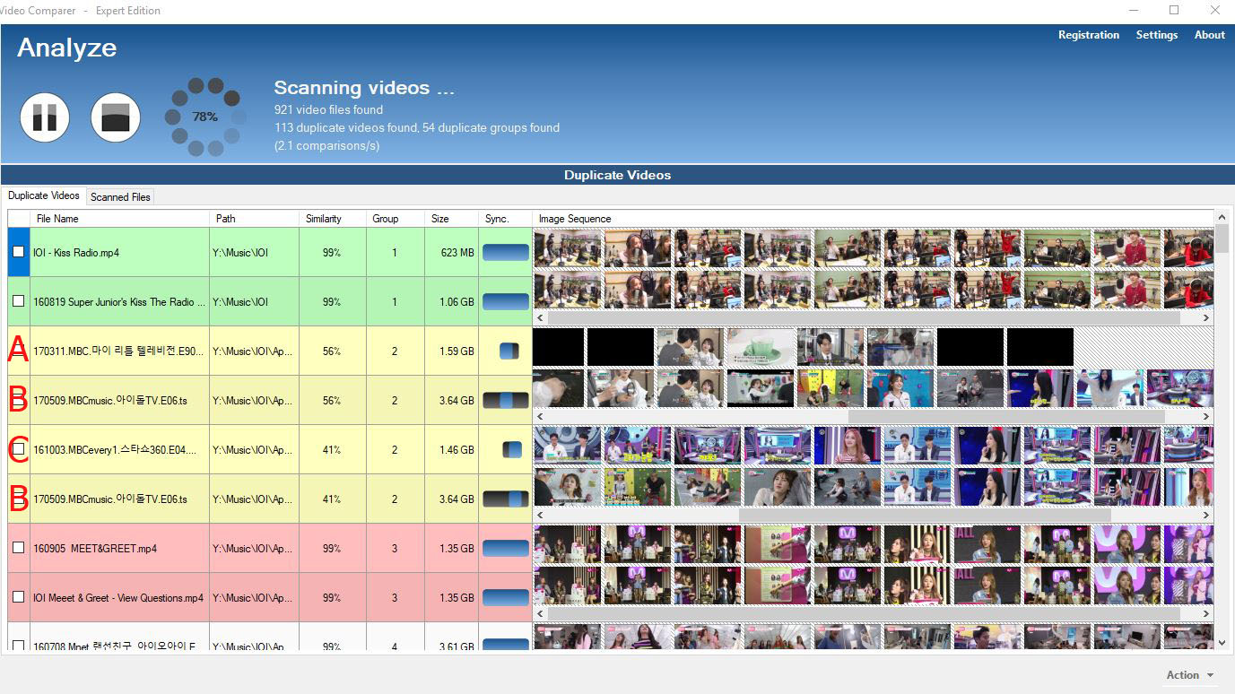

The below shows what I was a talking about the A, B, C comparisons I mentioned above. A & B have exact matches and C&D have exact matches, but B&D are only close for one scene, yet ABCD are grouped together. I know that these are all news clips, so they're all unique. Confirmed by the low % score.
