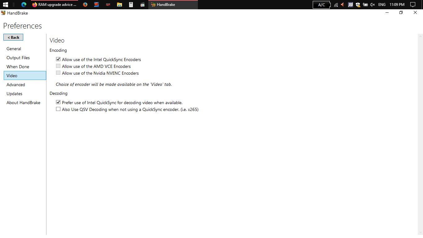

    If QSV isn't available, enable AMD encoding in Handbrake.
    Otherwise, if you can't enable the Intel QS because of the GPU card, you'll have to pull the GPU card and run only the Intel GPU to access QSV.

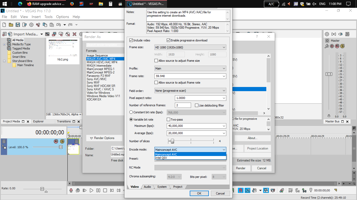

    Vegas Video 17 supports MP4 QSV encoding if you select it by customizing the templates for MP4 encodes.
