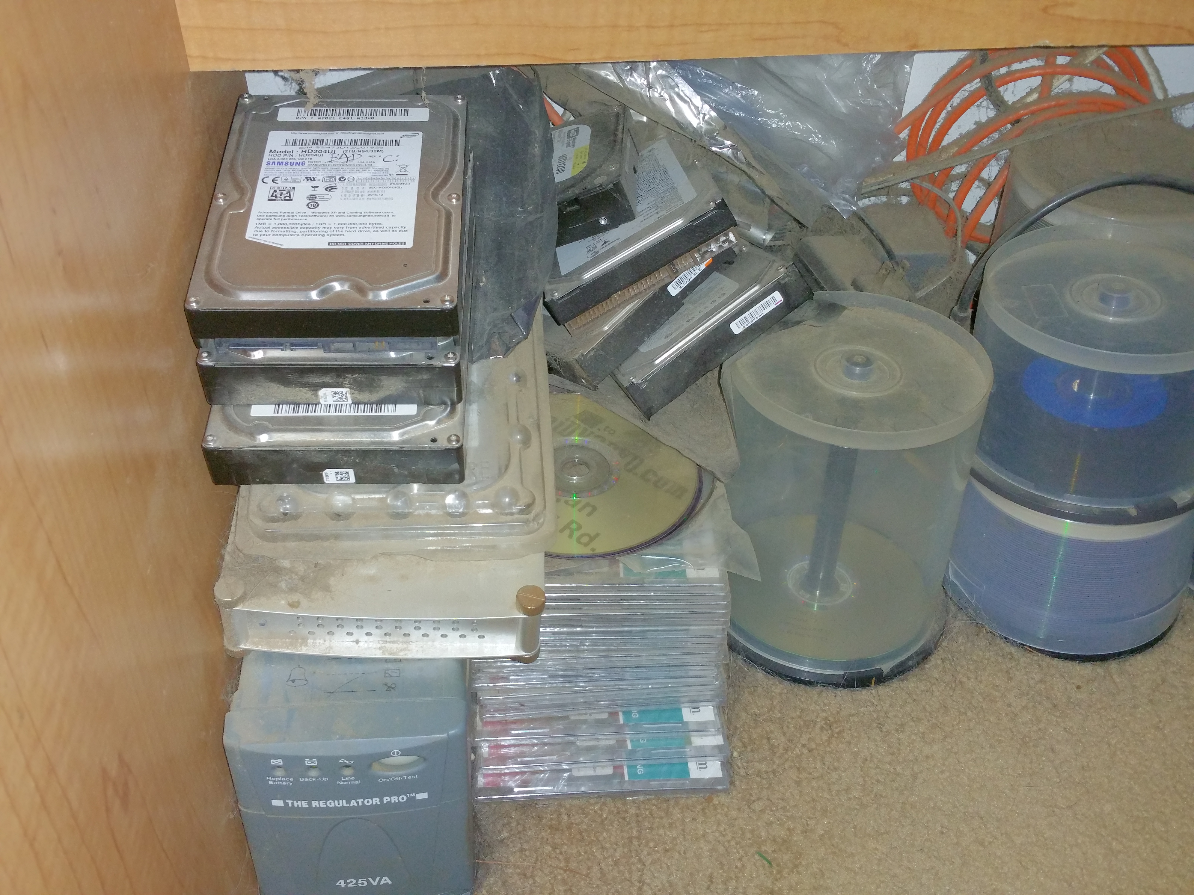

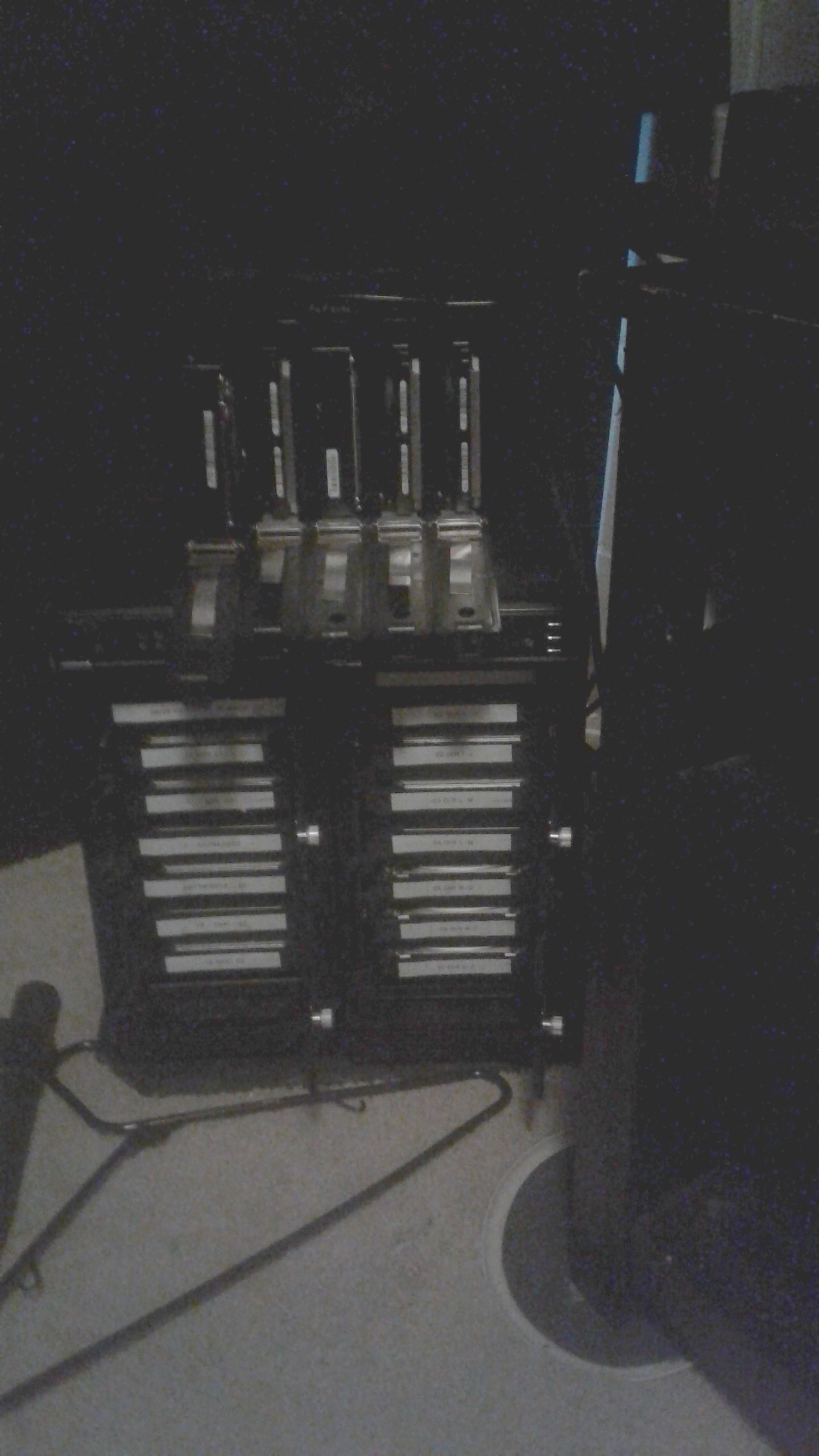

  25. Member
    Jul 2007
    Keeping and maintaining my non-RAID, non-NAS collection isn't a pain at all!
    [Attachment 51582 - Click to enlarge]
    The five drives on top are spares. And the backups (connected to my main PC) are four bay enclosures instead of the eight bay ones connected to my laptop. Noise and heat aren't an issue because I have to keep my A/C on whenever I'm home. Can't open the windows because of noise, heat and odors and don't want natural light because it affects viewing.
