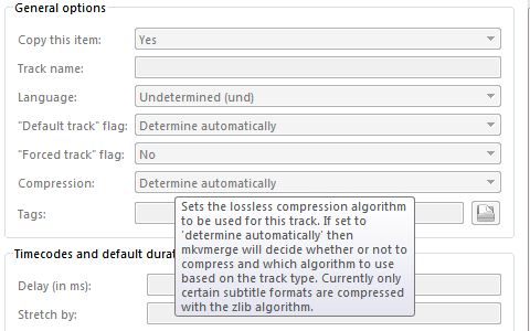

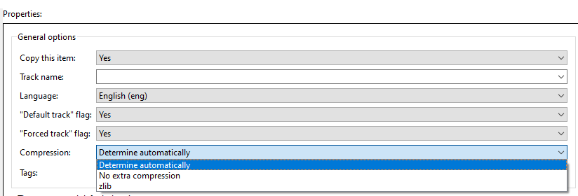

  7. Originally Posted by abolibibelot View Post
    I'd rather not use MKVToolNix as it lowers the bitrate slightly even if chosen No Compression
    Where did you see that “No compression” setting ? As far as I know MKVToolNix never compresses the streams but only muxes them into a MKV container. The MKV container is said to have less “overhead” than other containers, especially MPEG/VOB, meaning, the size of the structures of the container itself (header, index and whatnot) is small, which must explain the difference in size. But the actual streams (video, audio, subtitles if any) should be identical.
    [Attachment 51555 - Click to enlarge]

  9. Originally Posted by ss2012 View Post
    That has nothing to do with the audio or video. If you hover over the line you'll see the context help:
    [Attachment 51559 - Click to enlarge]
    Currently only certain subtitle formats are compressed with the zlib algorithm.

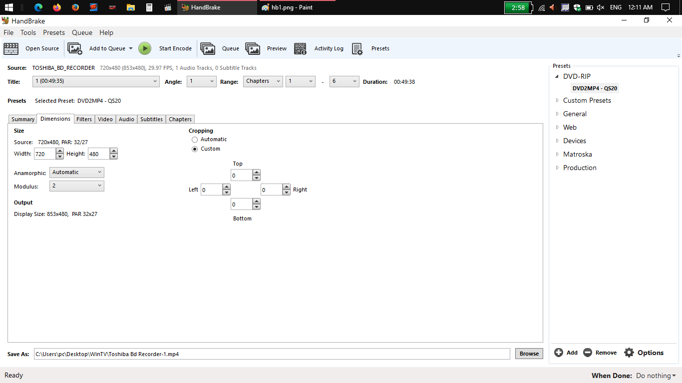

  10. I don't have time to read this whole thread, but if you're trying to encode a 720x480 0.909 PAR DVD to a square pixel format, I would use 656x480. I've done that dozens of times over the years.
  11. I don't have time to read this whole thread, but if you're trying to encode a 720x480 0.909 PAR DVD to a square pixel format, I would use 656x480. I've done that dozens of times over the years.
    Why 0.909, isn't it supposed to be exactly 4:3, hence a 0.888 pixel aspect ratio ? Or is it the “ITU” ratio, with a few extra pixels left and right beyond the actual picture ?
  12. Originally Posted by abolibibelot View Post
    It's because of the discrepancy between the ITU spec and the MPEG 2 spec. MPEG 2 is very clear. Only the DAR is flagged (and of the four possible values only 4:3 and 16:9 are valid for DVD), and the DAR refers to the entire frame (unless overridden by a sequence_display extension). The ITU spec puts the DAR in a 704x480 or 704x4x576 portion of the 720 pixel wide capture (actually those are approximations, the nearest even value). Most DVDs made from analog video sources are captured by ITU compliant devices and the difference between the two specs is ignored. In my experience DVD players are schizophrenic about this, following the ITU spec at the s-video and composite outputs, but upscaling the full frame at the HDMI outputs.
    If you're a real stickler for technical correctness you have to examine the video and look for hints that it's an ITU cap : fuzzy video (ie, analog tape source), ~8 pixel wide pillarbox bars left and right, head switching noise at the bottom of the frame, hard pulldown, field blending from a PAL/NTSC conversion, etc.
    But the reality is that nobody can really see the ~2 percent AR difference so it's not worth worrying about.

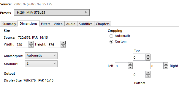

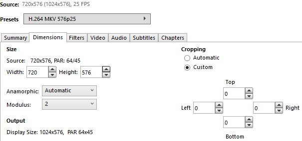

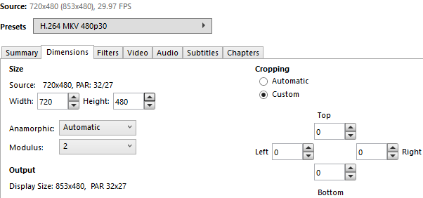

  13. Thanks for all the replies, still a little confused about what dimensions to select in Handbrake but because I have about 488 documentaries to rip I tested MakeMKV and it plays via Plex to my TV without transcoding however only in the browser on a laptop or mobile it transcodes.
    MakeMKV: About 3 min per documentary
    HandBrake 3 hours 20min per documentary

  15. Originally Posted by johnmeyer View Post
    656 loses about 10% of the resolution versus 720, and since dvds are already low resolution, this further degrades the image quality vs retaining the original dimensions of the digital image from the dvd.
    PCs etc have no trouble at all upscaling from 720x to fit higher resolution monitors and tvs, and does it better with higher resolution source files (720 better than 656 better than 320 etc).

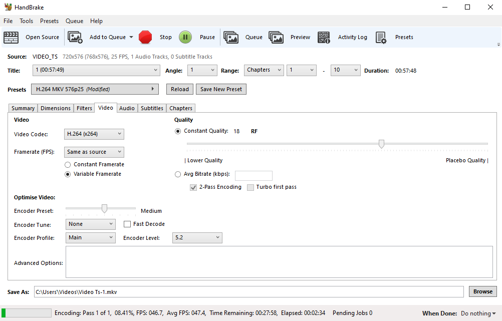

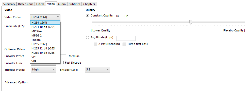

    lol I believe it was because I set the Encoder Preset to 'Very Slow', Medium should be okay?

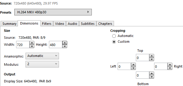

    Yeah with these documentaries I'm not sure if I should use auto crop as the sides keep adding black bars on the sides when the scene changes so it looks odd. With Auto crop it minus the width/height but I put it back to the source size should I not?
    [Attachment 51592 - Click to enlarge]
    [Attachment 51593 - Click to enlarge]

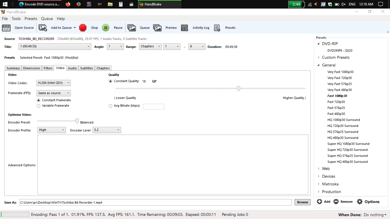

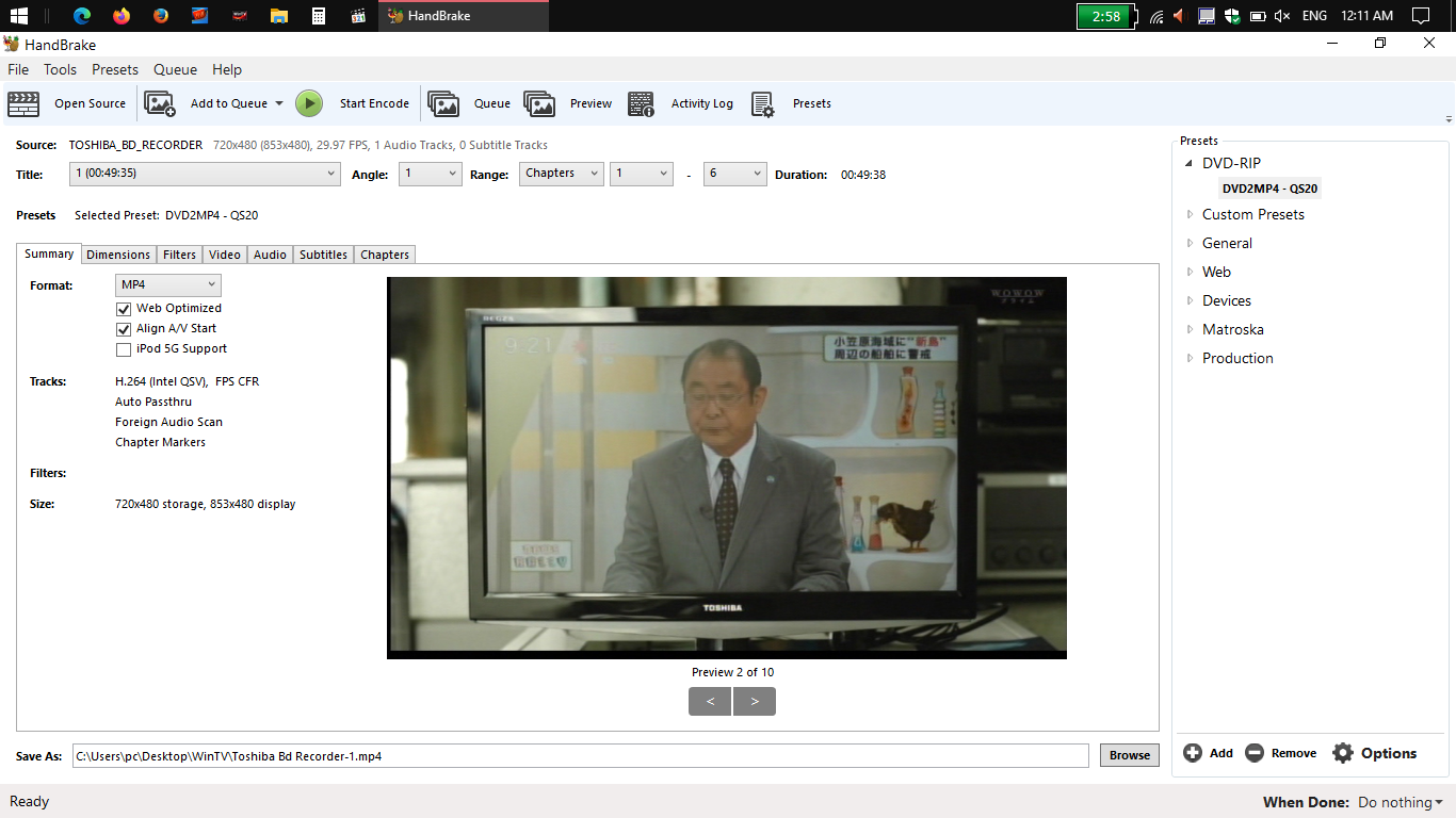

  17. If you don't want to deal with the custom calculations and crop for each disc (likely small variations), then custom crop to 0 all around and encode as you've set before to 720x480 with custom par settings. It's a LOT of discs, and I've seen borders vary a lot across discs.
    Instead of MAIN profile, HIGH.
    Also, constant frame rate, not variable.
    You're using the default h.264 (x264) encoder, so with 2 pass, it'll be slow no matter what.
    Active turbo first pass - generally works well for slow, high quality encodes, but faster by a bit. (Still hours)
    Otherwise, use the H.264 (qsv) encoder option with two pass off (the Quality slider mostly controls the Quicksync encode quality, so slide to 15-18. Encoder Preset then will be Quality, 5.2, High.)
    Using quicksync reduces the 3+ hour encode to less than 15 minutes. (Only if you have an Intel cpu - sorry amd users.)
    [Attachment 51594 - Click to enlarge]
    [Attachment 51595 - Click to enlarge]
    [Attachment 51600 - Click to enlarge]
    For example, if I was going to rip a 16x9 video, I'd use settings like this, with Quicksync to accelerate the encode. (Notice for the 49 minute video, it's reporting a quick 9 minutes to RIP and encode!

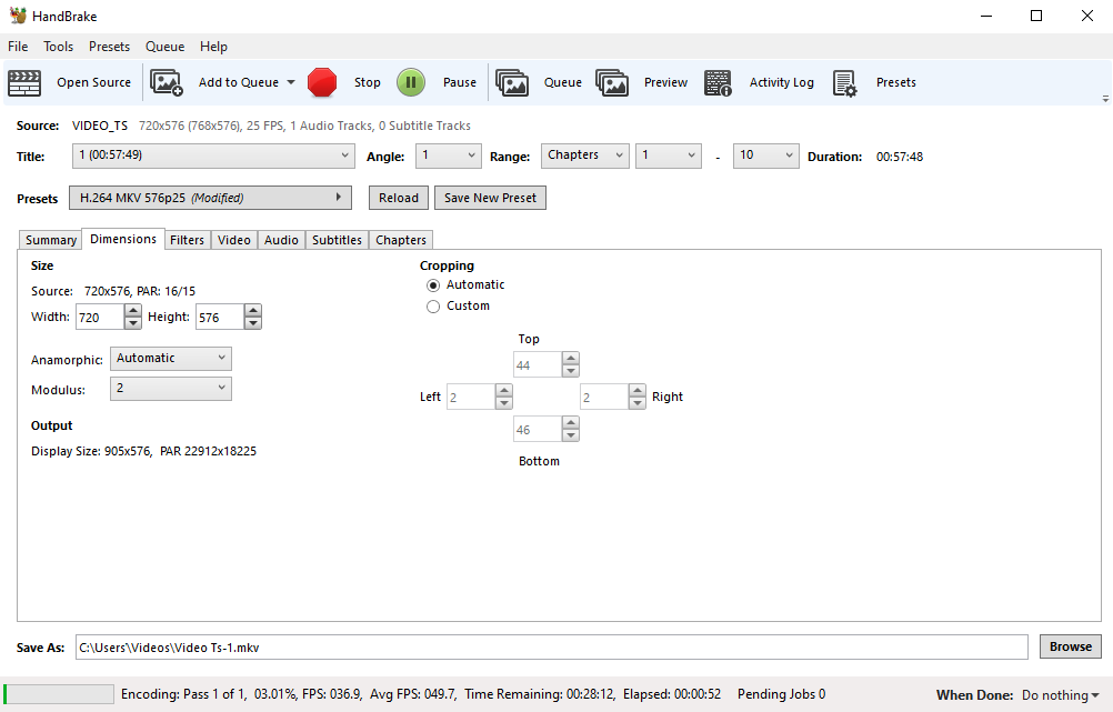

  18. Edit: you need 'Intel Skylake' and its greyed out in Preferences/Video
    Its a bit odd as I don't have QuickSync
    [Attachment 51603 - Click to enlarge]

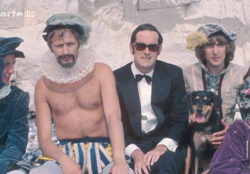

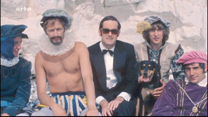

    That's the kind of things that made me wary of using Handbrake long ago. When I did I made sure to set the crop values to 0, unless I knew that a particular video would benefit from being cropped by specific values, which I had duly verified. I'm not sure if I understood correctly what you meant here, but no, you shouldn't use auto crop, and generally speaking, unless the whole video has black bars of the same size all along, disabling all cropping should be preferred.

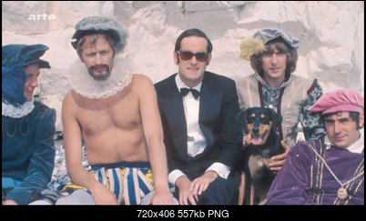

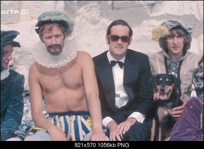

    Once I criticized the conversion someone had made of a series of documentaries on the Monty Pythons broadcast on television, using Handbrake and relying on its default auto crop feature. Such documentaries alternate between contemporary footage shot in 16:9 aspect ratio and archive footage shot in 4:3 aspect ratio (with black bars on the sides when it's done right — which is certainly not as odd as stretching the frame to the 16:9 ratio, or cropping it vertically by 25%, or a mix of both, as can be seen in many programs featuring butchered archives), and Handbrake, unless its analysis method has vastly improved since then, usually chooses to crop to the size of the 4:3 frame. So it looked like this :
Name:	MP_AlmostTheTruth_3 [réencodé avec HandBrake, 'cropping' sauvage].mkv 42'26 vlcsnap-2013-11-26.png
    and should have looked like this :
Name:	monty_python_toute_la_verite_ou_presque 3-6 {eMule}.flv 44'36 vlcsnap-2013-11-26-22h34m51s69.png
    And the resolutions were different between the episodes... Despite the fact that his version was in better quality than the other one (which had been downloaded from the channel's “replay” service), this egregious defect made it unwatchable. (Yet the dude was adamant that he had done so on purpose, to get a good quality / size compromize at the expense of the “modern” shots, considering that the archive images were the most important — even though the 16:9 content included many still pictures as the one shown on the screenshots above.)

  22. Originally Posted by ss2012 View Post
    Preferences > Video > Allow use of the Intel Quicksync encoders (check/on).
    If you have an nvidia card, enable nvidia nvenc encoding. Try and compare to see what works best for you.

    Size-wise, qsv encodes can be the same size as x.264 encodes, but will be worse in quality (at the best encode settings). Or, equal quality but the qsv encode will be slightly larger in file size.
    On the latest Intel cpus that have H.265 Quicksync, simply switching to the better encode format allows for better quality encodes at the same file size vs x.264 h.264 encodes...But far faster.
    Now, what this all really asks is
    IS encoding MPEG-2 dvd rips to H.264/h.265 going to give me ACCEPTABLE encodes?
    NOT ALWAYS!
    If the dvd source was filmed in digital, mastered in digital, like the latest 4K movies, there will be essentially no noise or artifacts of note on the dvd video. As crisp and clean as you can get, so any h.264/h.265 encode will likely give you a great result.
    If the dvd source was filmed in analog cameras, mastered on take, dropped to dvd digitally, you'll see lots of analog noise and artifacts in the original. (E.g. Many concerts from the 80, 90, 2000s) ANY attempt to try and convert will likely result in crap files at the usual expected compression rates (E.g. 2GB h.264 encode of a 4gb mpeg-2 master). Qsv, h.264 x.264, h.265... None will be able to handle the noise well - You'll either lose lots of detail and get a crap encode, or get a huge (often bigger than original) encode that still isn't nice looking.
    Mpeg-2 to h.264 on these types of dvds are not recommended - keep the video untouched in mpeg-2 instead (or vob, or iso).
    Trust me on this - if qsv can't get a nice encode at quality 12-15 (normally 15-18 is fine), this tells you not to bother encoding. Keep in mpeg-2. I've tried all sorts of settings and encoders on such older dvds, and nothing works better than simply keeping it in mpeg-2 format as a straight disc rip.
    Naturally, if you've got an interlaced source, it's even trickier and tougher to get a nice h.264 encode, so again, if qsv at the 12-15 quality setting with default handbrake interlace detection and deinterlacing settings isn't working well, don't bother encoding - keep it in the original format.
    Most modern discs rip fine. And qsv is a godsend in bluray rips. But older discs might not survive the encode.
  24. see the comparison here of makemkv vs handbrake. I'm finding it hard to tell which has lost detail, maybe someone with keener eyes can tell.
  25. Originally Posted by babygdav View Post
    Yes, 656 is about 10% fewer pixels than 720.
    But no, it does not lose 10% of the resolution.
    Why?
    Because the 720 encode uses rectangular pixels and the 656 encode uses square pixels. There is zero information in the long horizontal direction of the rectangular pixel and therefore no information (resolution) to lose.
  26. aBigMeanie aedipuss's Avatar
    Oct 2005
    666th portal
    dvd spec 720x480 can either be 4:3 or 16/9. so when converting to square pixel formats like h264 you should choose 640x480 for 4:3 material or 854x480 for 16/9. they are easy, encoder friendly and close approximations of the mpeg-2 sizes.
    abolibibelot - your post #19 is a 16/9 source and needs to be re-encoded that way. you did it to 4:3 that's why a 1/3 of the video frame is missing.
  27. Originally Posted by ss2012 View Post
    The differences can be subtle.
    I usually take screen shots at 1:1 of source and output.
    Open them in a photo editor like Photoshop or gimp.
    Layer them together in one file.
    Apply an invert/negative filter to one layer, the top one.
    What will result is the difference between the two, seen clearly.
    Note that single frame comparisons does not show differences in time - This often causes worse artifacts like edge strobing, aliasing, etc , than you see in a single frame.
    Also, if you have fine text or details like a hair, it's more obvious. Detail in the sand of a beach shot. Etc
  28. Yes, 656 is about 10% fewer pixels than 720.
    Why?
    Huh?
    An ntsc source material like broadcast, dv tape, vhs, dvd, are all targeted originally to be displayed on a 4:3 aspect tv using a 720x480 digital frame size (rectangular pixels, stretching automatically occurs during display).
    All computers think in square pixels, so a 4:3 aspect ratio image is squished to a 1:1 aspect ratio 640x480 frame size. When a 1:1 640x480 is displayed on a monitor, no squishing occurs, but if fed to a tv, it is stretched to fit the 4:3 aspect ratio tv set instead of the 1:1 computer monitor.
    The stretching of ntsc source material or computer generated source material when displayed outside the native display format is automatic and always occurs.
    What shouldn't is the native resolution and detail stored in each pixel until display.
    For example, a ntsc source video with 1-pixel wide vertical color stripe, followed by another color, and another all the way across encodes 720 different colored stripes.
    Reducing that resolution by shrinking the horizontal resolution to 6xx DOES NOT RETAIN ALL original 720 colors. The stretching and squishing of pixels to fit the screen aspect ratio doesn't change the fact you're now missing almost 100 colors.
    Now, there's some stretching and squishing artifacts occurring when displaying ntsc source material on a pc, or computer graphics on a tv - BUT, talking about ntsc source material, all 720 colors should be present in any encode or rip in the pc file when displayed 1:1 without any aspect ratio adjustments.
    https://helpx.adobe.com/premiere-pro/using/aspect-ratios.html#Frameaspectratio
  29. Originally Posted by aedipuss View Post
    There's also 4:3 letterboxed, in which case a crop of the top and bottom black bars helps reduce encoded file size since there's no video information of importance there. 1:1 pixel size depends on the crop and aspect ratio of the letterboxed video.
    (Bluray supports 1:1 in addition to 4:3 and 16:9)
  30. Originally Posted by babygdav View Post
    An ntsc source material like broadcast, dv tape, vhs, dvd, are all targeted originally to be displayed on a 3:2 aspect tv...
    Do you just make this stuff up? I doubt that in the whole history of television manufacture there's ever been a 3:2 (1.5:1) television sold. In the old tube days they were all 1.33:1; these days they're (mostly) 1.78:1.
    When 640x480 is displayed on a monitor, no squishing occurs, but if fed to a tv, it occurs to fit the 3:2 aspect ratio tv set instead of the 4:3 computer monitor.
    Nonsense.
