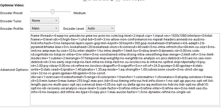

  5. Once again I entered everything in the box next to Advanced Options as you can see in the image below.
    Is there another option on how to change the video / encoder related settings on Handbrake?

  6. Handbrake might use the automatic settings over the manual ones?
    Why are those settings so special/needed?
