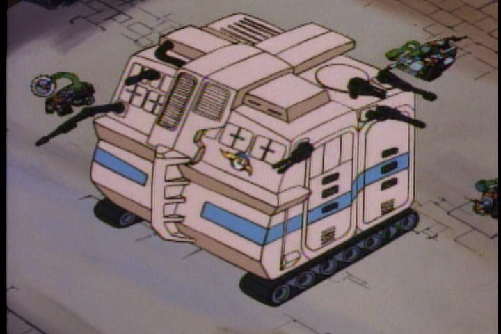

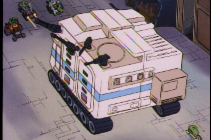

I'm working on Jayce and the Wheeled Warriors. The source is very nasty and there is a lot of jagged lines throughout. I am using Staxrip. The source is 29.97 NTSC when ran through DGIndex. I've tried yadifmod2(order=1,mode=1), yadifmod2(order=1,mode=1,edeint=nnedi3(field=3)), IVTC, and QTGMC on medium settings and interlaced. None of these help with the issue. Can you take a look at the source and tell me if I'm wasting my time or not? I have been getting the best results using yadif, when I use QTGMC it makes black lines look really bad as where yadif leaves them alone.
https://mega.nz/#!BZE0lIBK!bLCW8BtC6gKO0LuCG3NpVw0FnwsrHmrp6G7DWH9nnAU
[Attachment 51516 - Click to enlarge]
[Attachment 51517 - Click to enlarge]

try:
tfm().tdecimate()
QTGMC( Preset="Slower", InputType=1 )
http://avisynth.nl/index.php/QTGMC#Progressive_InputLast edited by davexnet; 17th Jan 2020 at 18:07.
The source is progressive so you don't need to field match. And the aliasing is so bad I decided to use InputType=2. But even InputType=2 doesn't fix the blue stuff at the beginning.
TDecimate(Mode=1)
QTGMC(Preset="Slower",InputType=2) -
I start with something like this:
Code:Mpeg2Source("Jayce.d2v", CPU2="ooooxx", Info=3) AssumeTFF() SeparateFields() nnedi3(dh=true) Merge(SelectEven(), SelectOdd()) QTGMC(InputType=2) TDecimate()
Were the jagged lines in the source video as well?
If not, use a better capture device.
If so, good luck - no idea. -
BTW, telecined video was poorly deinterlaced leading to all the jaggy edges and duplicate frame every 5th frame. Then the crappy progressive frames were encoded interlaced for DVD.
I just tried this and the video came out much better than the options I tried. I'm currently running manono's method to see how it comes out. I will use davexnet's method after that. babygdav, yes, the source is awful. It's from DVD and not a TV capture. Mill Creek isn't known for quality. Thanks everyone for their input. I'll report later on how things turn out.
