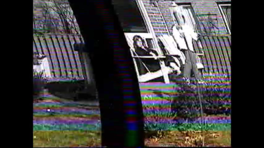

  1. I'm having a problem capturing analog video and am hoping that this forum can identify what I am experiencing and point me in the right direction to a resolution, if one exists.
    I've seen others post this same problem, but have not seen anyone identify it as interlace issue, noise, dropped frame, etc...
    Here's the problem, video looks fine when played back on HI-8 camera, looks fine when played onto a TV screen, looks fine when copied to VHS. Mostly looks fine when captured to PC, but regardless of software I use, or hardware used to connect the camera to the PC I get the same 'issue' at the exact same moment in the tape. I have tried both internal cards and USB dongles, I have tried multiple PCs (desktops and laptops) and still get the same error at the same point of time. I have also tried to capture various resolution levels and file types (AVI, MPEG-2) and still have the same issue. I have attached a quick 6 second sample.
    An identification of what I am experiencing and a suggestion of how to resolve would be most appreciated.

    [Attachment 51589 - Click to enlarge]

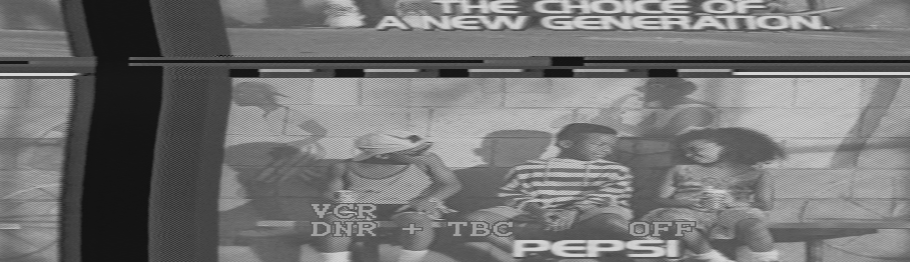

    The horizontal blanking seen here in the middle of the frame has been bent by the capture device, but the curve is remarkably regular. Compare to horizontal jitter here:

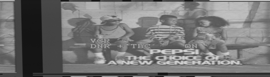

    [Attachment 51590 - Click to enlarge]
    And the same but with line TBC on; these captures roll diagonally because the sample rate of cxadc doesn't line up exactly with a pixel grid.
